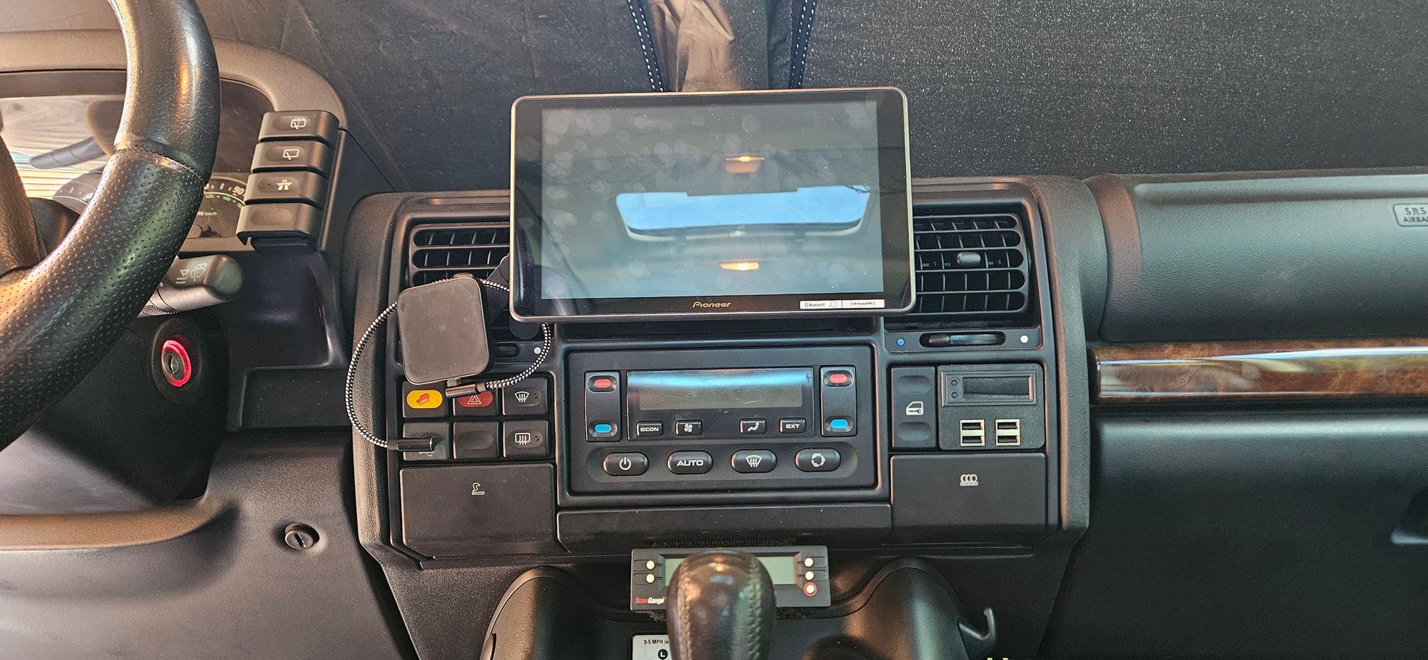

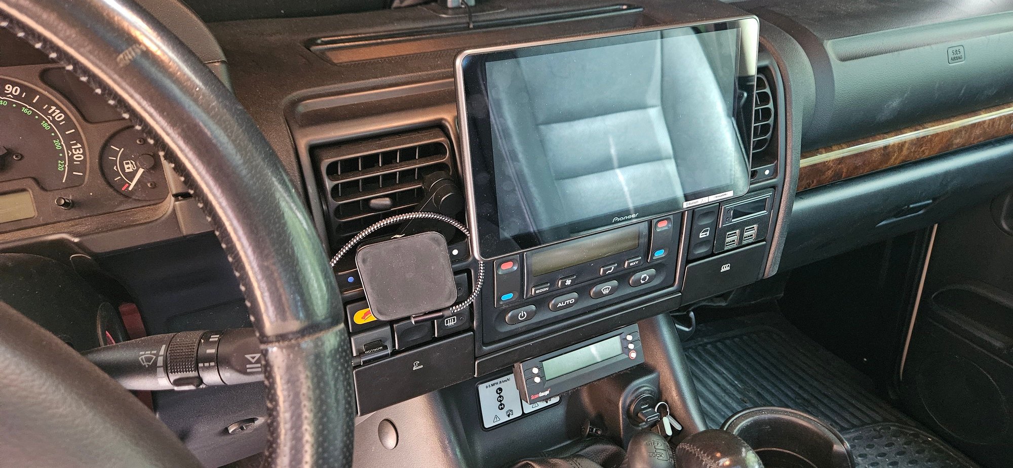

Head unit - for the head unit, we wanted a screen so we could install cameras front & back for easier parking. Given the Disco is a single DIN, we opted for the newer style "floating" screen. We needed a new dash kit, but that was easy enough to grab one from Amazon for $15. Fairly easy install, plenty of space in the dash and behind the climate control unit. I also ordered off eBay an emergency brake eliminator kit for $10 so now we can watch movies while we're driving. Also ordered a Scosche Powervolt Kit to replace the cigarette lighter which ties directly to the USB on the back of the head unit and still allows a USB-C fast charger port for charging. Pretty well plug-n-play from Crutchfield.

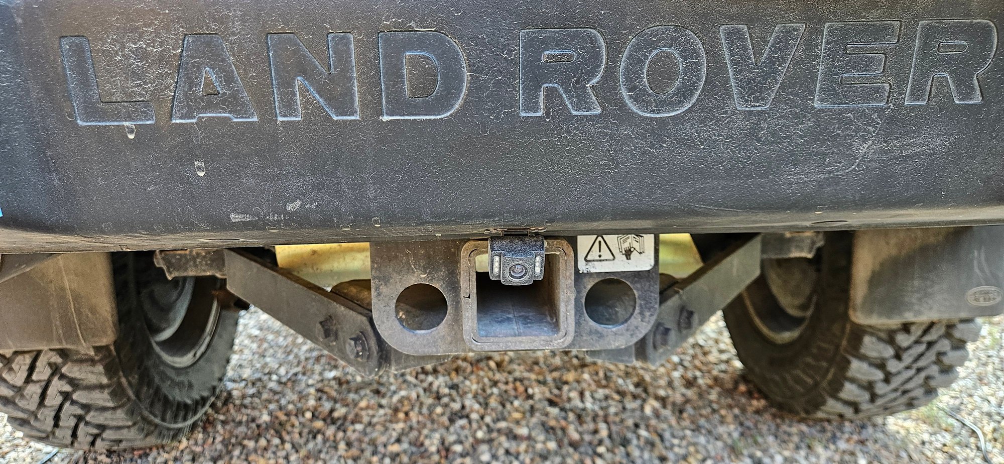

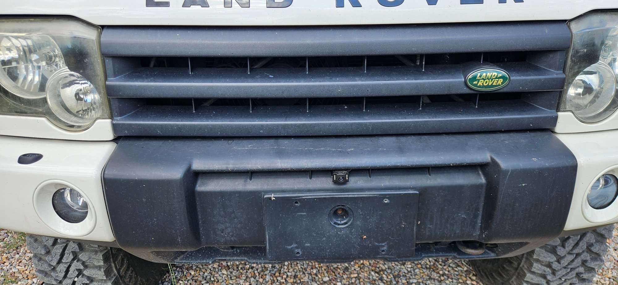

Boyo Cameras - Well, these were pretty easy to run front and back and ties in nicely to the head unit. I already knew that I'd be running speaker wire so this camera line was easy enough. Rear camera I mounted just below the bumper, we'll see how long it lasts but I'm optimistic. Tied it to the backup signal line in the dash behind the glove box so we can turn the camera on to watch the motorcycle trailer if we need. Front camera mounted it hiding just above the bumper but below the grill so you can still pull the grill with no disconnects.

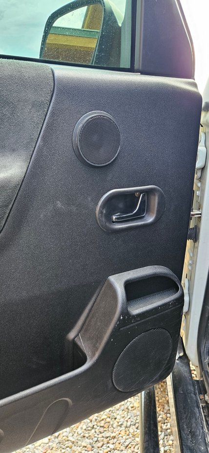

Speakers - It was important to me to keep as much stock look as possible, so pulling the door cars and replacing speakers in-kind was the criteria. JL Audio provides a good sound for the price and while initially I thought to forgo the mid-range, I thought it was silly not to have the 3-way speakers that the original had.

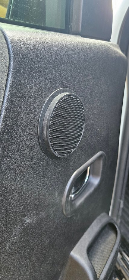

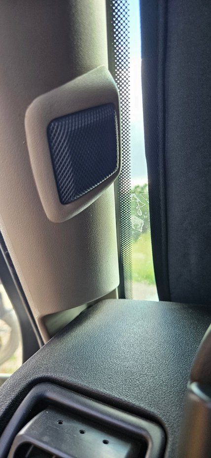

Tweeters - The 3/4" tweeters only needed minor Dremel clearing inside the A-Pillar and the JL Audio snapped right under the stock clips of the original. Super nice and easy.
Mid-Range - The 2.75" mids technically fit in the stock mounts, but to make an easier install, after some Dremel trimming of the new driver mount, removing the stock screen allowed me to push the new driver in from the front and it is held in place with some clever zip-ties. It ends up with a slightly raised/surface mount look, but allows me to completely revert to stock should I ever need. Very happy this turned out well.
Woofers - Pretty much direct swap out. New speakers use 4 screws instead of stock 3, but all the hardware worked. No surprises here.

Scanguage II - came with the car, relocated it lower. This is great for tracking various metrics straight from the OBD. For me, it was an easy way to compensate for actual speed now that tire size had increased. Use it to track MPG, engine temp, speed, voltage.
