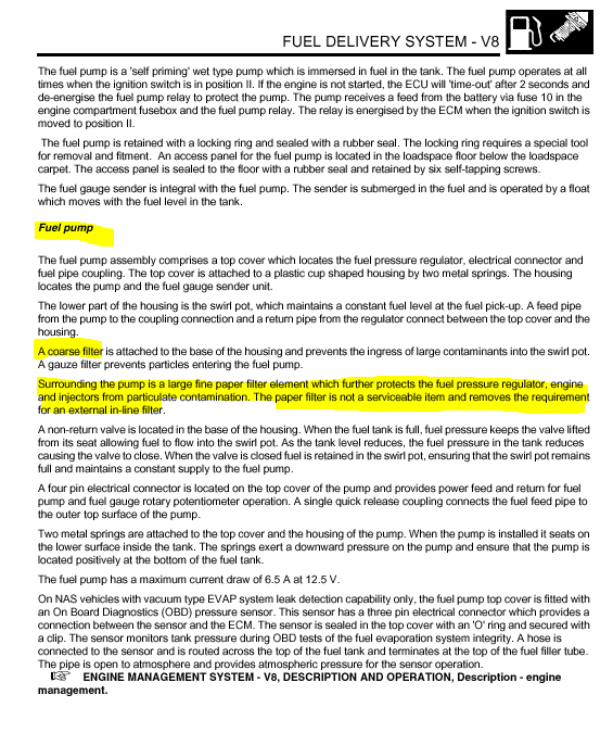

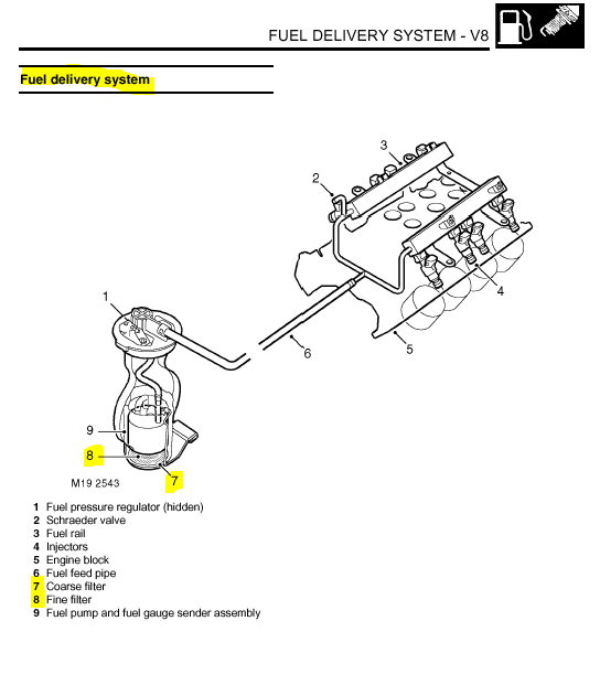

FYI,
There is a filter but located within the pump assembly housing. There is no LR PN for the filter and no reference for replacing if that's even possible. A replacement pump should contain a new filter.
+1 . But give me an external inline fuel filter any day.

X1 ........... unlike diesel fuel where there is lots of water and condensation, petrol SHOULD have none in theory, so the primary pump filter is the only screening of petrol.
PS: If anyone decides to add another secondary petrol filter after the pump ensure it's a large one similar to the TD5 diesel filter and change it every other oil service or annually.
