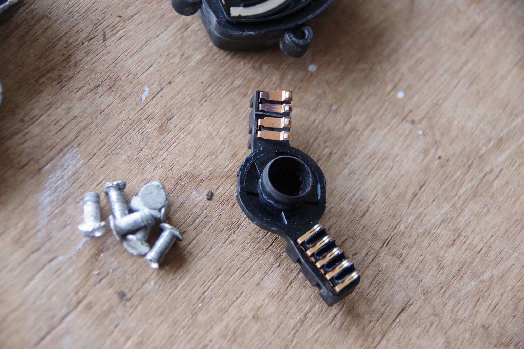

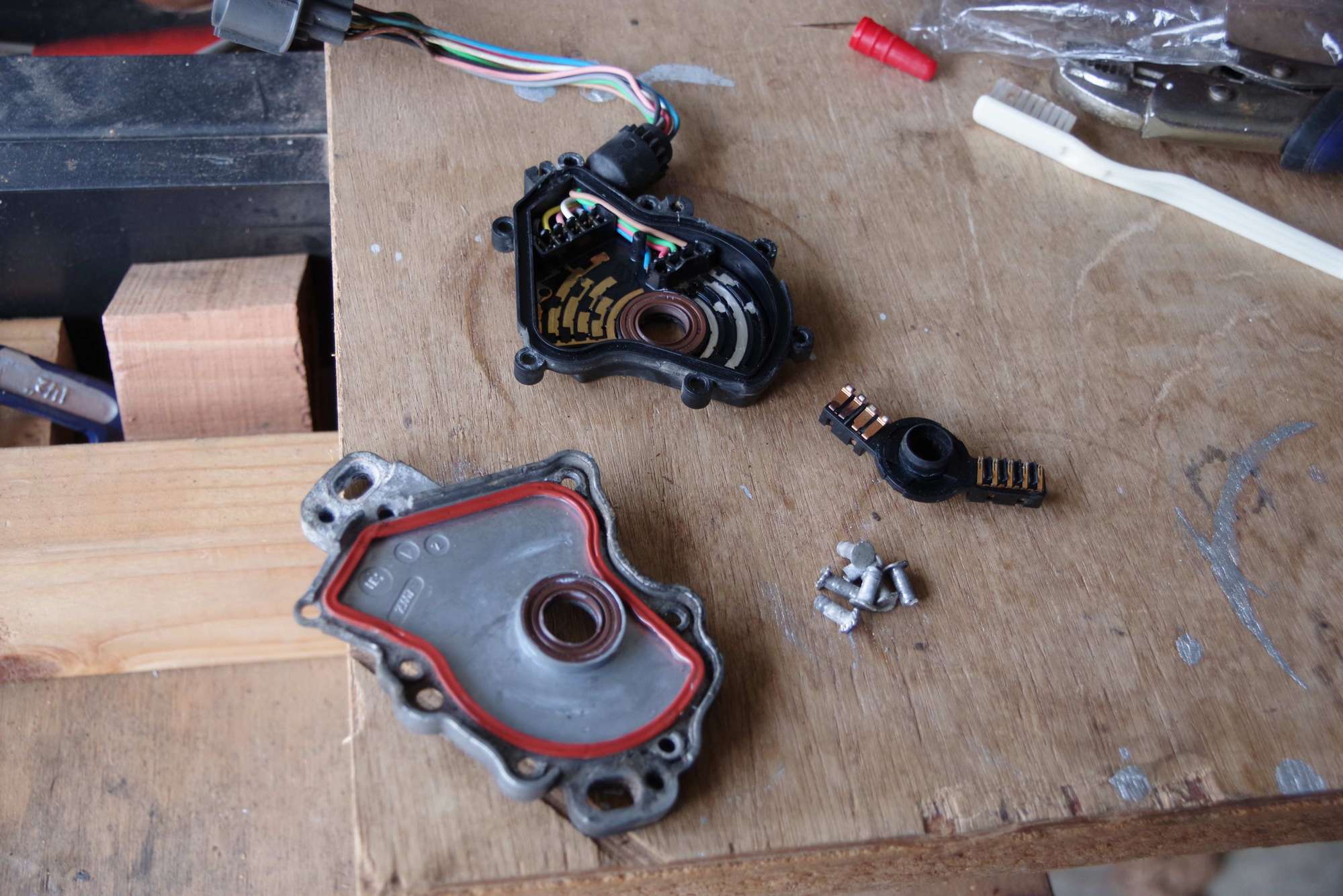

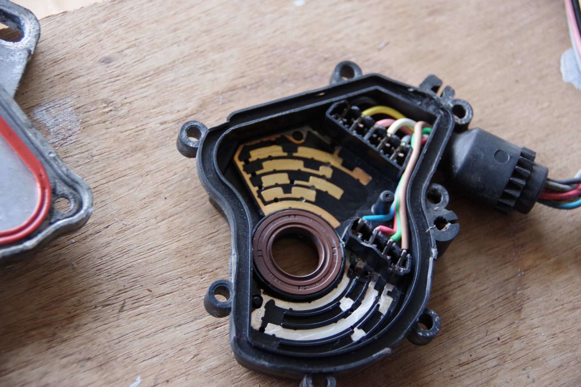

I replaced the battery and alternator. Cleaned and re-tightened all the ground connections. My wipers did the cycle in reverse and my gear indicator showed the correct gear, except it was flashing. Nothing fixed the limp mode until I pulled the XYZ switch and cleaned and reinstalled it.

The XYZ switch has a couple milometers of rotational adjustment play in the mount. If you look at the cast case in the picture I posted of the switch housing, you can see the mounting holes are oval. When I first installed the switch it did not work. The gear indicator was just a tad off. I had to move the switch just a hair to get it lined up right. Once I got the fine adjustment set, it has not displayed the M & S lights or gone into limp mode again.
