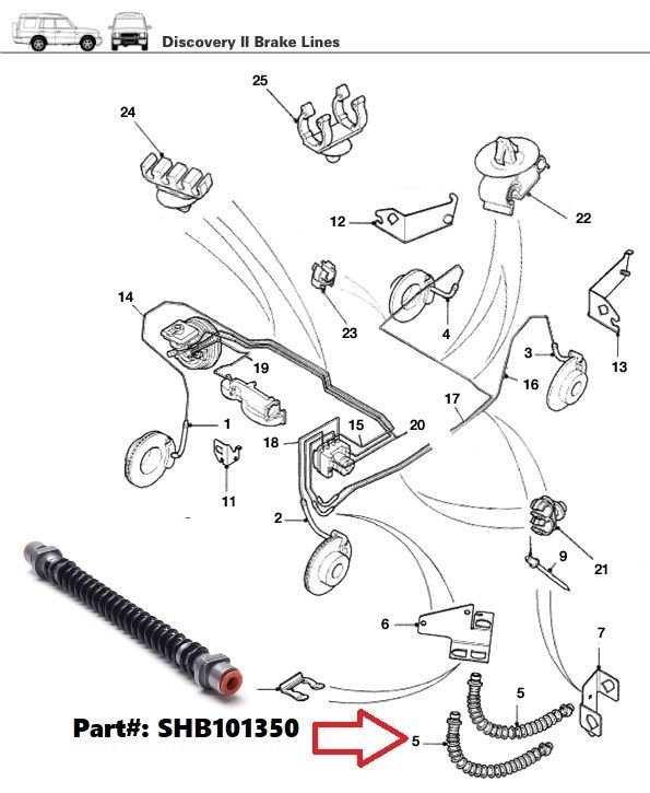

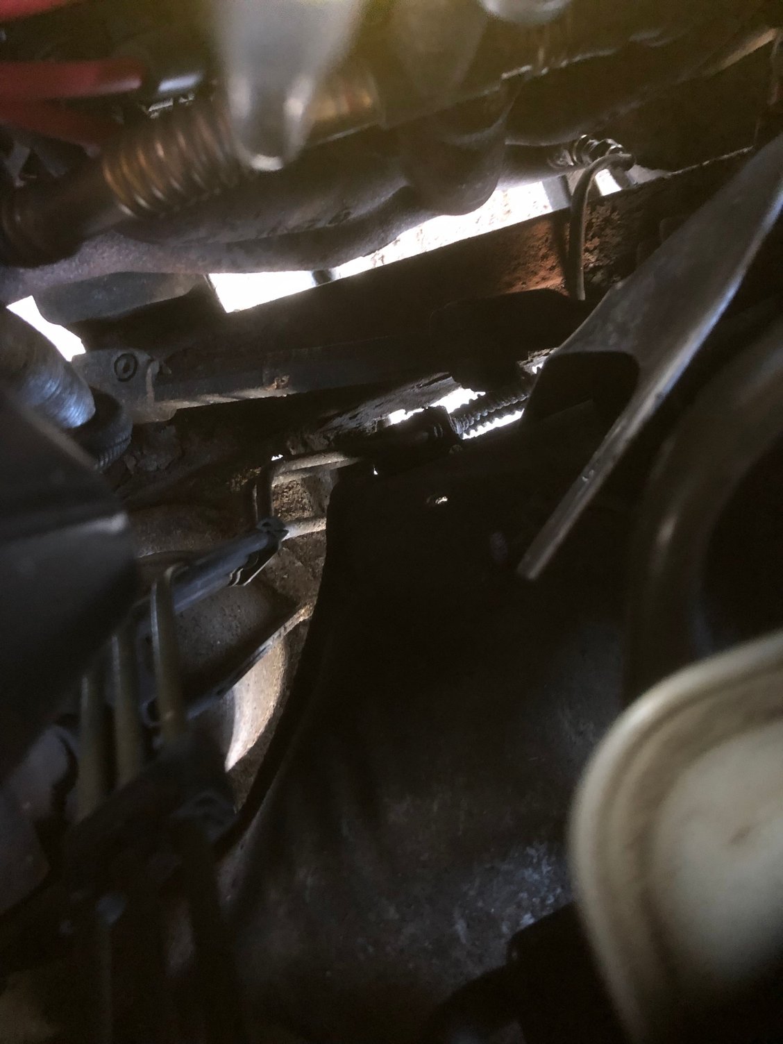

Can anyone direct me on what hoses I need to repair this small leak
it’s the 2 rear lines that come off the main unit go down on the drivers side looks like it attaches to frame than looks like they connect to a ushaped hose than continue to the rear
I see Atlantic British sells the brake hose kit but I don’t see the ushaped hoses

If it's the hoses that are leaking you need part #: SHB101350. They are straight until you install them.
Spray the Line Nuts on the brake pipe with some penetrating oil!!!!!!
> https://www.lucky8llc.com/products/r...ne-centre-rear
If you need these hoses NOW then AutoZone has Duralast # 71083 which is a DORMAN # H620307

Yep also verify your master cylinder reservoir isn’t leaking as it can soak those lower lines. AB also sells a braided SS brake line kit that includes those smaller ones.

Thanks guys yes I need those # 5 hoses that connect to that bracket
are you guys saying those hoses also come in the Atlantic British kit
Old Mar 3, 2019 | 10:59 AM
OverRover's Avatar
Posts: 2,514
Likes: 656
Yes > https://www.roverparts.com/Parts/ABP218
