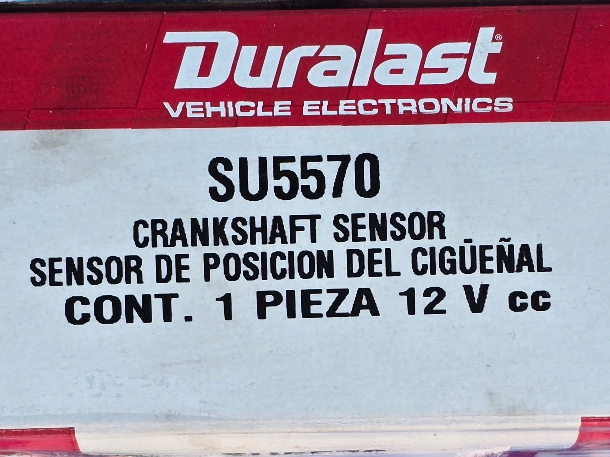

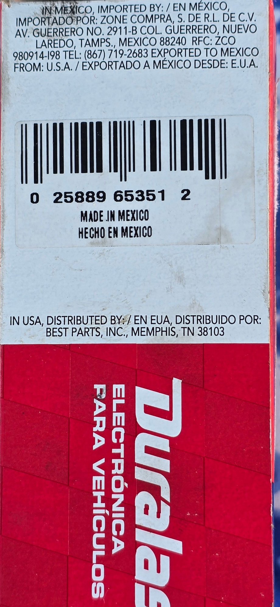

A big shout out to this Forum again.....this keeps my rig on the road! Driving down the highway at 65mph when all of sudden RPMs drop and engine cuts out! Somehow I manage to get over but hit the (tight) shoulder. Death avoided for myself and tow truck driver. Sketch AF! Get a tow back to the homestead and find this thread among others and I pick up a CKPS at Autozone. Unfortunately, it was not a BOSCH. Job took about an hour and many pointers in this post helped. I didn't drop the exhaust. I was able to use a 1/4" mini ratchet with the 7mm & 8mm. A key tool was the LONG screwdriver. I could get this above the frame section by the brake lines and unclip the plug while I pulled the wire below. Popped right out after a few attempts. I could only (barely) get one arm in there so using the screwdriver just above the frame was perfect. Frame/exhaust rash sucks. Another key was clipping the new one in from ABOVE. I managed to get the plug out just enough from the top/back of engine. I could then clip the new one in. Dropped it down and reattached it. Fired up! Thanks to all who have contributed to this post. It keeps on giving. I had the original CKPS and have just under 200K.
WARNING SIGNS: Over the weekend I changed out sway bar links front/back along with sway bar bushings. After the install it wouldn't start. Tried again and nothing. Then she fired up like usual. Next day she died as I was getting on the highway for a split second. She cut out in a flash and back on. Check engine light flashed and went out. Everything back to normal. Strange but ok. Then 15 minutes later she died for good. Never had a code or Check engine light come on prior. Wouldn't fire up this morning.
Don't believe BOSCH is made in Mexico. The CKPS had no brand on it.

What says on The box does not matter, there was a tread a while back in 2016, one of members had found out that there are some genuine Bosch parts in AutoZone but labeled as DuraLast brand , boxes would say made in random countries , like Cypress or Malaysia , etc. ,,
ONE OF item’s was CPS & other one Brake pedal sensor , I remember going & buying 2 X CPS & one BPS,, & both parts did say “Bosch made in Germany” on them but boxes had some part # & just said “Made in Cypress”.
