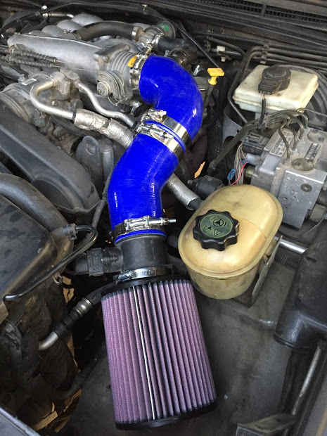

I did mine in Blue, to match my blue Kingsborne wires(that you can't see, haha)

Looks good, Joe! One thing, I'd be careful about your MAF wire. Looks like it's really close to the serpentine belt. I also see you got the nicer clamps, they look good.

The wire is close to the belt cover, but since I do not have the air pump or whatever kind of pump that goes there, it is a good 6" inches from the belt. I ordered the blue tubes off eBay and the clamps came with them 22.46 total price for hoses and clamps. I used a 4" aluminum intake tube off eBay also and it was 16.48. Got the air filter from Advance Auto and used coupon code for 30% off and had 10.00 in their perks. total price was 42.00. Thanks for the write-up, and the nice words.

Thats awesome, and hell of a price! I paid more than that for just the filter
Quite welcome, my friend. Glad I could help.
