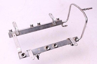

From: dallas texas
Fuel rail has a shrader valve attached to it. You can put a pressure tester on there and check
You can see valve sticking out the back
