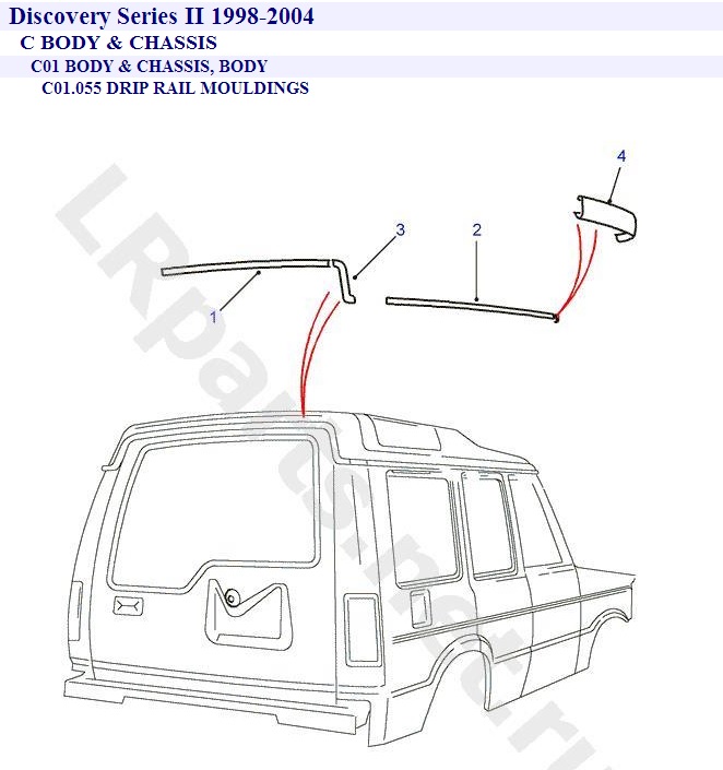

Hard to describe, but the plastic water trough on driver's side, back close to rear side window (not the rear door window), where black plastic water trough seems to be snapped on inner metal trough when originally mounted there; that area is where the plastic broke off.

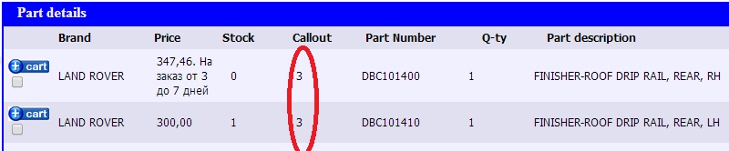

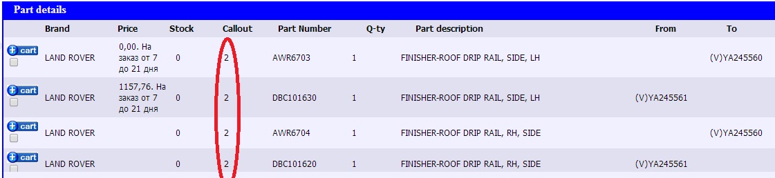

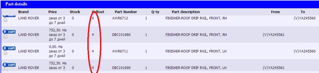

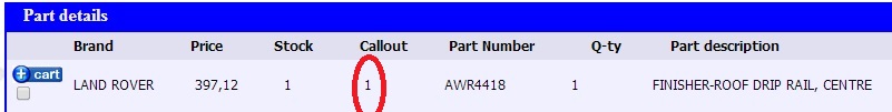

Here are the part numbers:
And, I'm guessing THIS is the one you are looking for???
DBC101410 | GUTTER TRIM L/H/R SIDE DIS11 | Land Rover | Discovery 2 - 1999 to 2004 | Britcar (UK) Ltd
Attached Thumbnails Know anything about replacement for plastic trim around water drain, sides of roof?-drip-rail-mouldings.jpg   Know anything about replacement for plastic trim around water drain, sides of roof?-drip-rail-mouldings-1.jpg   Know anything about replacement for plastic trim around water drain, sides of roof?-drip-rail-mouldings-2.jpg   Know anything about replacement for plastic trim around water drain, sides of roof?-drip-rail-mouldings-3.jpg   Know anything about replacement for plastic trim around water drain, sides of roof?-drip-rail-mouldings-4.jpg

SuperSport, Spot on; thank you so much for the help.
