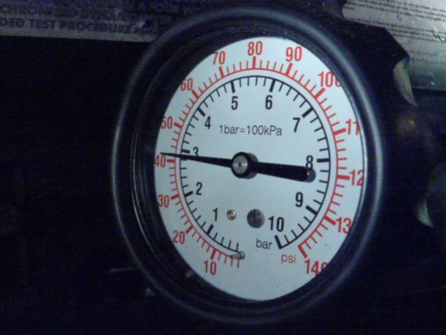

Default 4 point oil pressure test?
What does that involve?
Old Feb 24, 2012 | 08:56 PM
Posts: 16,322
From: Savannah Georgia
Remove oil pressure switch near oil filter passenger side. Screw in 1/2 X 20 thread adapter to whatever thread your oil pressure gauge needs (blister pack aisle at parts store). Buy or rent oil PSI gauge.
Crank truck. Cold, the oil PSI should go high, and be high for both idle and revved up, because oil filter is bypassed and thick cold oil is getting all the pressure the pump can give. When warmed up, the pressure when revved up will be about the same, perhaps a little less. The pressure at idle will drop as oil thins out from warming up, spec is 50 PSI for revved up, and above 10 PSI at idle. On a D1 the spec is lower, only 30-40 when revvd up. Mine did 44-45 when cranked cold, settled back to 42 hot when revved up, and 22-24 at warm idle.
A cracked oil pump can tick (not always), will pump at some kind of pressure (enough to turn out the light which comes on at like 7 PSI), but usually does not pump enough at speeds.
Also see tech section for https://landroverforums.com/forum/di...estions-46975/ which shows a jumbo oil filter with low internal flow restriction.
Attached Thumbnails liners slipping-p1120410.jpg   liners slipping-oil-pump.jpg
