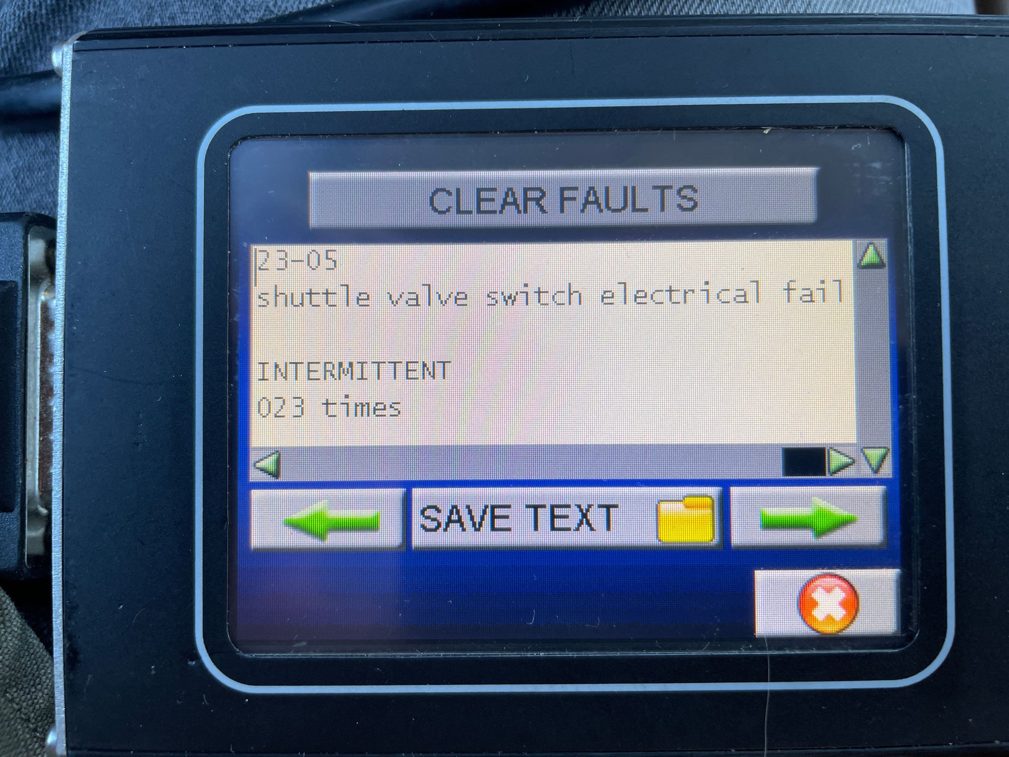

Three amigos finally struck the white disco. Nanocom says it’s the shuttle valve. So the solution is to replace the shuttle valve switch, yeah?

Option B done on it? How is the condition of the Shuttle Valve switch insulation/wiring?

Nope, never touched the ABS system other than maintenance. Not bad for 194K miles! I'll check the wiring harness tomorrow.
FWIW, I reset the ABS faults and turned off the amigos, then drove it an hour back home and the amigos didn't come back on. Doesn't mean they won't of course, so I'd rather get ahead of it and replace whatever needs replacing.

There could be a problem with the switches, but as documented on this and other forums dozens of times in many (most?) cases the problem is a failed solder joint where a pin connects to a printed circuit buried deep in the modulator. Option B bypasses this failed solder joint and restores full ABS/TC/HDC function. Option B is inexpensive and not difficult to do; just a little tedious.
More than one forum member has replaced the shuttle valve switches in response to this code and it hasn't corrected the fault. That's because the fault can be anywhere in the SVS circuit, and the failed solder joint is a very common culprit.
The Option B procedure includes instructions for bench testing the switches to confirm whether or not they are working to spec. Plus you can do a visual inspection of the wiring in the switch module. Best4x4 has posted pics of crumbled insulation on the wiring.
