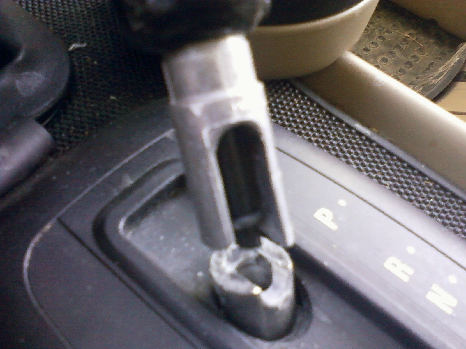

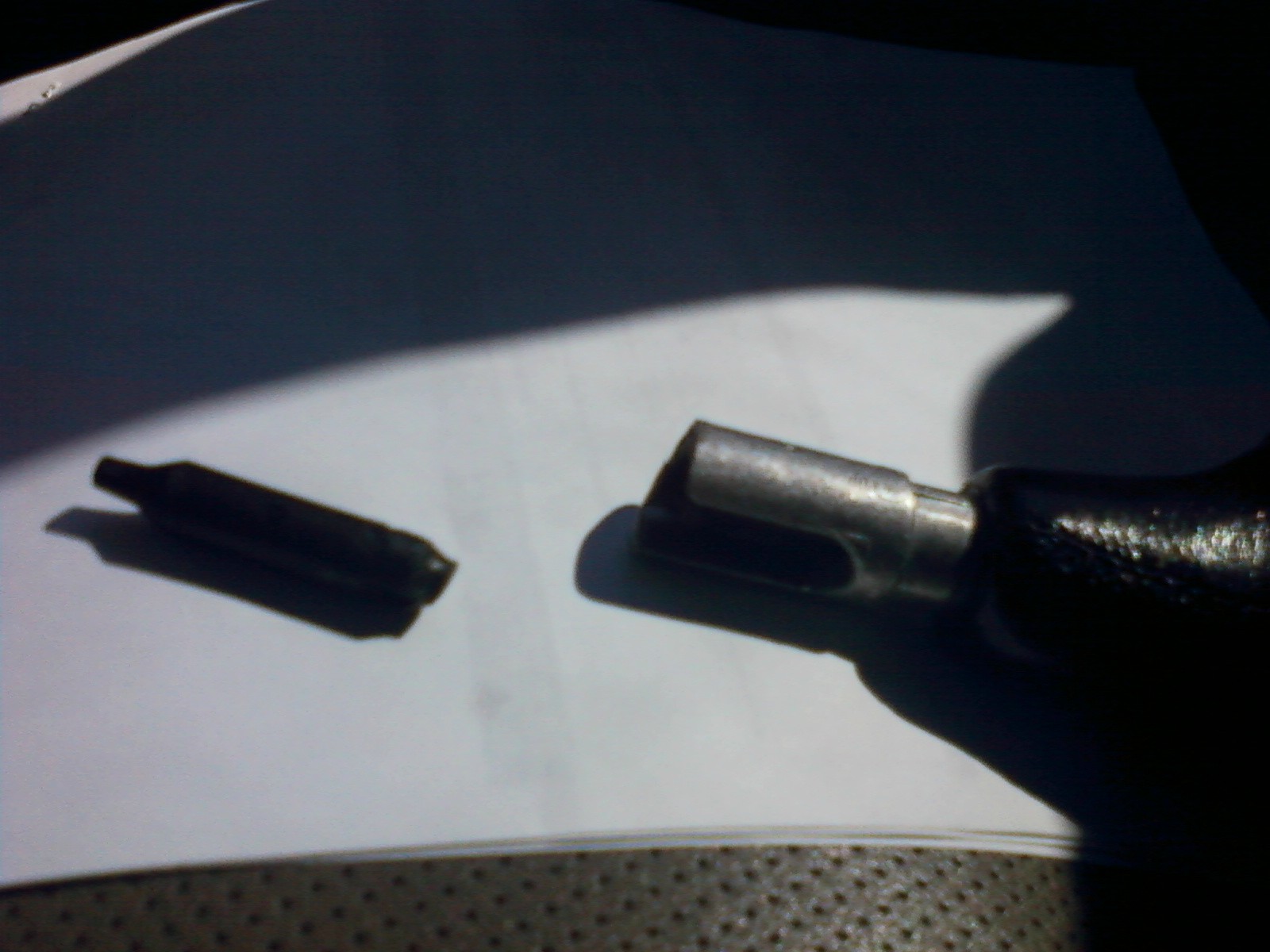

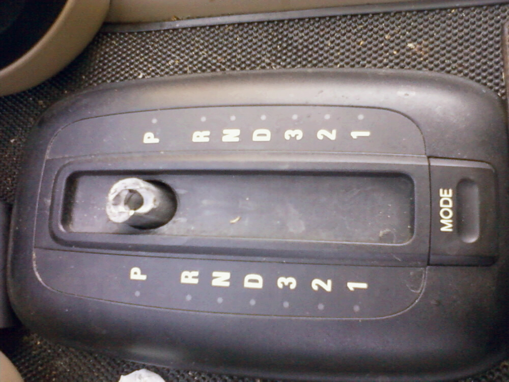

The other day, while putting my 2001 Discovery II in park, the gear selector stick broke off in my hand! 2 parts are broken: the metal that makes up the gear stick, and the inner plastic piece which connects to the button on the gear ****.
Does anyone have experience with this issue? I am planning on welding the metal back together and trying to glue the plastic piece back on. Will this work, or would it be a better idea to try to obtain a new assembly for the gear selection?
If anyone could give me tips on the welding job as well as reconnecting the plastic piece, I would greatly appreciate it. Alternatively, if this wouldn't work, I would appreciate some links to where I can purchase this assembly new or used.

Here are 3 pictures where you can see the damage. You can see the plastic piece that broke, as well as where the metal broke.

WOWWWWW!!! Is it getting stuck in park? Then needs to be forced into gear? That could be a bad brakelight switch. When you start it up and then step on the brake you should be able to hear something down near the shifter making a sort of clicking sound. (in my '03 I think I can feel it in the shifter too). That's the little pin moving out of the way allowing the gear selector to move. If you don't hear that or only hear it SOMETIMES when stepping on the brake, It may be bad.
I think you could also check if the brake lights work. I think if they don't, the gear-shifter lock may not work either. Good Luck man!!
