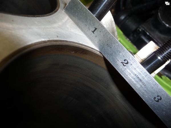

The "tick" when warmed up is frequently the result of a cylinder sleeve moving and striking. It starts as engine is warmed up, and may decrease with higher speed at it is thought that sleeve can't slip and slide as fast as piston is changing directions.
There are write ups on have small bolts installed into the non-contact area of the sleeve. Some people install a new engine. Some have "top hat" liners with a large rib machined and installed. see https://landroverforums.com/forum/di...ictures-56419/
There don't appear to be any miracle cures in a bottle that make it go away, although some say operating under heavy load with cheap gas will burn on enough deposits to slow the slip for a while.
You can reduce engine overall heat by using a 180f thermostat. A scaner or Ultra Gauge can show you the exact engine temp instead of that idiot light with a pointer gauge, it will point at 50% from about 130F - 230F.
There have been other causes of a tick, including cracked oil pumps, wrenches left inside during other major engine work, etc. The oil pump can be checked with a mechanical gauge by a shop, the repair is modest.
I'd have the oil pump test done no matter what.
Attached Thumbnails New to us 2004 Land Rover Discovery SE with engine tick/tap-slipped-sleeve.jpg   New to us 2004 Land Rover Discovery SE with engine tick/tap-oil-pump.jpg
