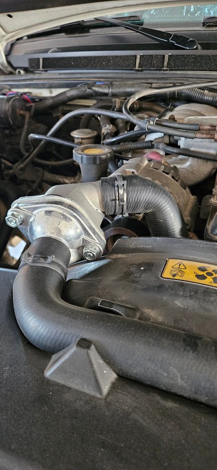

I had updated the entire coolant system (new water pump, reservoir, all hoses, Extinct in-line) 2 months ago and since then, the girlfriend had the truck so I wasn't really able to monitor temps. Just driving around town that one day, the ScanGauge would read 190 and by then the 180 thermostat would open and temps drop. Maybe we got to 204.
Yesterday, driving down to Albuquerque and then back to Santa Fe, hot day at 95 degrees outside, the temp got up to 238 and stayed there (quick peak at 242 degrees) and it didn't drop - could the thermostat be "stuck?" or did everything just get that hot?
I ended up opening windows and running the heater full heat and dropped the temps down to 220 for the hour drive home.
Thoughts on diagnosis procedure? The one hose off the inline does have a tight bend, but it's not kinked...

Oh, that’s very hot! 242*! That’s very close to where you would cause damage. Good that you turned the heater on. Could be various things, but the first thing I’d try is a new thermostat. And while you’re at it, cut the hose shorter to get rid of the slight kink. My $.02 worth.

Yes, much too hot! That hot on the highway suggest you have a plugged radiator although it could be a failed thermostat but unlikely. First step is to pull the thermostat element out of the housing completely because at 95° ambient temperatures you don't need any thermostat. Put it back together with no thermostat element in the housing and run it and see if it still gets hot, my guess is it will and that tells me you have a plugged radiator
