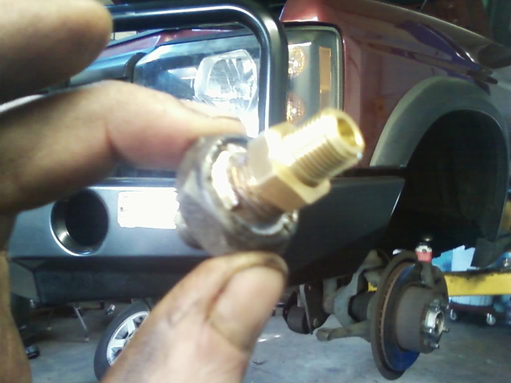

Look your getting in deep, I know of no good way to check oil pressure than through the oil pressure port. Problem is you wont find an adapter to change the oil pressure hole straight thread to a 1/8" NPT for the 15 dollar gauge your going to buy.
Which means you need to buy a new oil pressure switch, smash the end off and solder on a 1/8" fitting, like this one I've been using for years and years.
And then when you find out your oil pressure is low, you need to pull of the rear main cap, and 2 rod caps and inspect the bearings. an then when you find that your bearings are all worn out, you need to take all the main caps off + the starter so you can get to the cross bolts, drop your crank an 1/8 th of an inch, replace all your bearings. then you need to cross your fingers that you don't spin one the second you start the motor. Then if your lucky, your oil pressure wil go back up enough so oil once again gets to your rockers, that's to say your lifters arent shot and are the cause of your ticking in the first place...
What i'm actually trying to say is, turn your radio up louder.

Here's an adapter for the Rover oil pressure switch port.
The Brakequip Store
1/2" x 20NF male to 1/8" x 27NPT female
Of course, if you have a bad oil pressure switch lying about and can braze, that would be cheaper.
