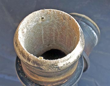

Yesterday drained (green) coolant, flushed radiator both directions--some scaling flakes (old t-stat had heavy calcium build-up coming from lower radiator hose; new one still clean). Flushed cylinder block until water ran clear--clean coolant and nothing else came out. When reconnecting hoses, I noticed that the upper radiator hose plastic T connector, which was black when wet, but now dry, it had started to develop a yellow-brown scale which got heavier, more opaque, and flakier within minutes (see attached). Tried to scrape a little off but it appeared as if the plastic were disintegrating. Hoses did not show a similar scaling, only plastic T. Reattached everything and filled system with Prestone radiator flush (not stop leak, just flush) and 1.5 gallons distilled water (wouldn't take anymore). Ran truck 2 or 3 minutes, temp went up to 60° and it threw Pending Fault Code P0135. At that point, I decided to stop and seek advice before proceeding (I had planned next to drain system again and refill with Peak 50/50 and Water Wetter).

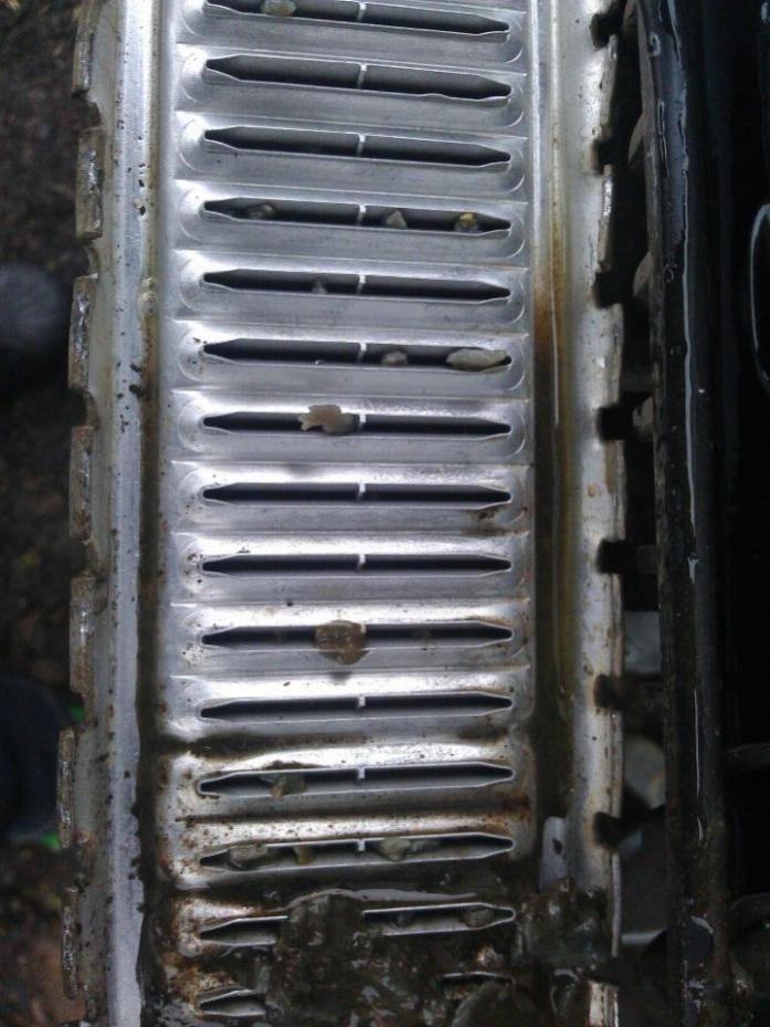

Prestone is Sodum citrate (citric acid), a common flush product. I would suspect that your radiator is so full of junk that you needed to run for the full 10 minutes like the instructions said, with heat on as well.
The radiators are so skinny that any crud inside starts to block them off. You can eval the performance of your radiator with an IR thermometer, measure fins at top and bottom, should be within 10F. More clogs equal cooler rows, very little hot coolant inside so same air flow cools them off. Bet the rest of the radiator looks like inside of that T. Because they are so skinny flush and rod out is not always practical as a fix. As a preventative, yes.
PO may have replaced radiator with used one. PO may have used tap water or well water. New rad is about $200 (Rock Auto Nissens brand). 180f stat would be a good thing to have, but get the real Rover one, not Motorad.

What you may find is that radiator is so clogged up that the hot flush treatment does not make a big enough difference. In previous Rovers they used an expensive copper and brass radiator, the side tank could be unsoldered, and the calcium rodded out. The aluminum ones have a plastic side tank, it becomes brittle with age (and the tiny hose fitting will snap off if you look at them). On this type of radiator it is usually not cost effective for a shop to touch it. If your temperature test confirms a sludged radiator, new ones are $125 - $200.
Some commercial rad shops have a hot citric acid flush that runs the liquid thru there and separates out what is removed on each pass. Home rad flush hopes to put most of the stuff in suspension, but how much of it is removed when you flush, and how much is just circulated everywhere else to coat the inside like a paint is up for discussion.
