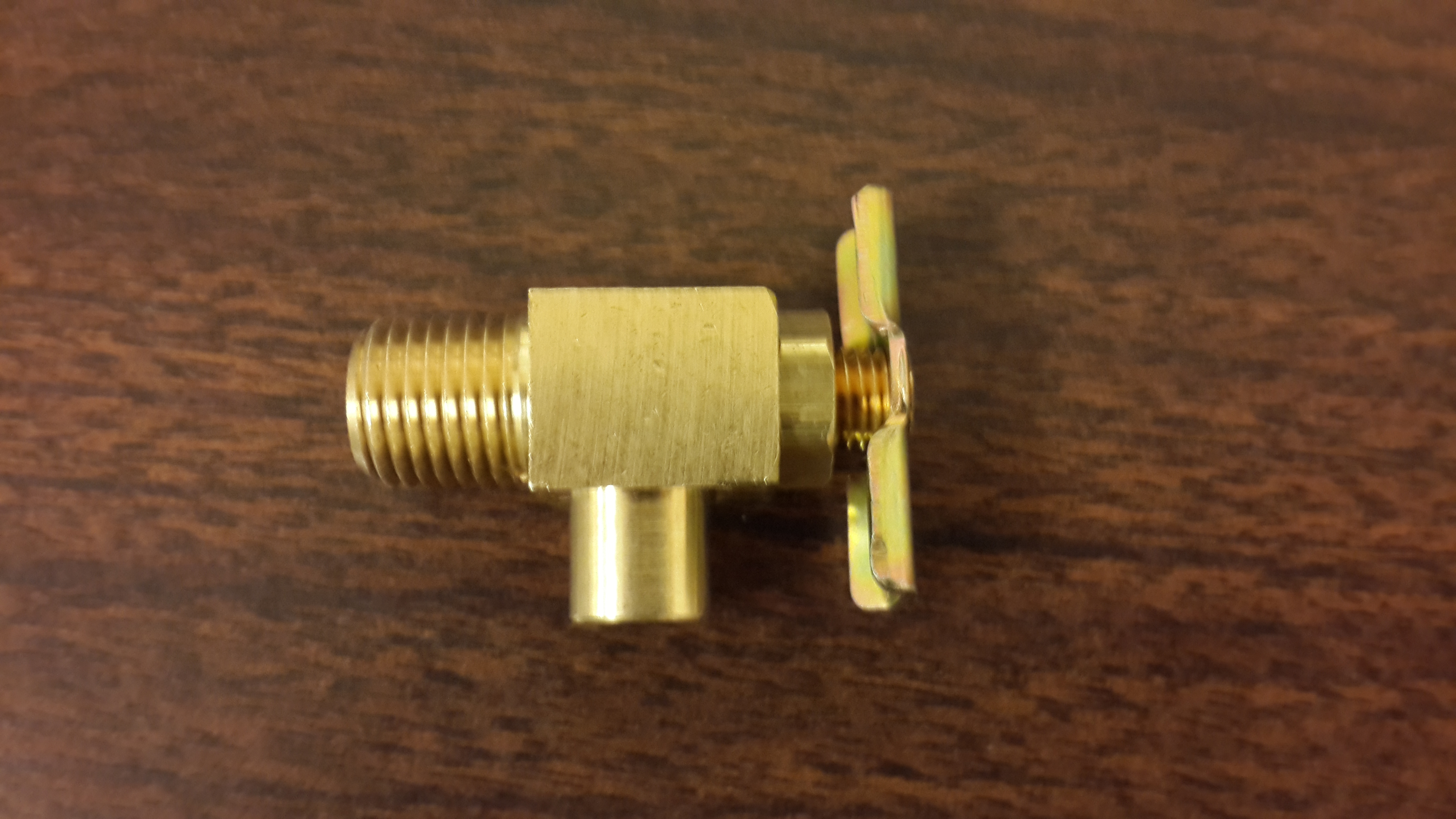

Pic #2 - Tompkins Industries part DC607-04. 90 deg bib drain
$20.61

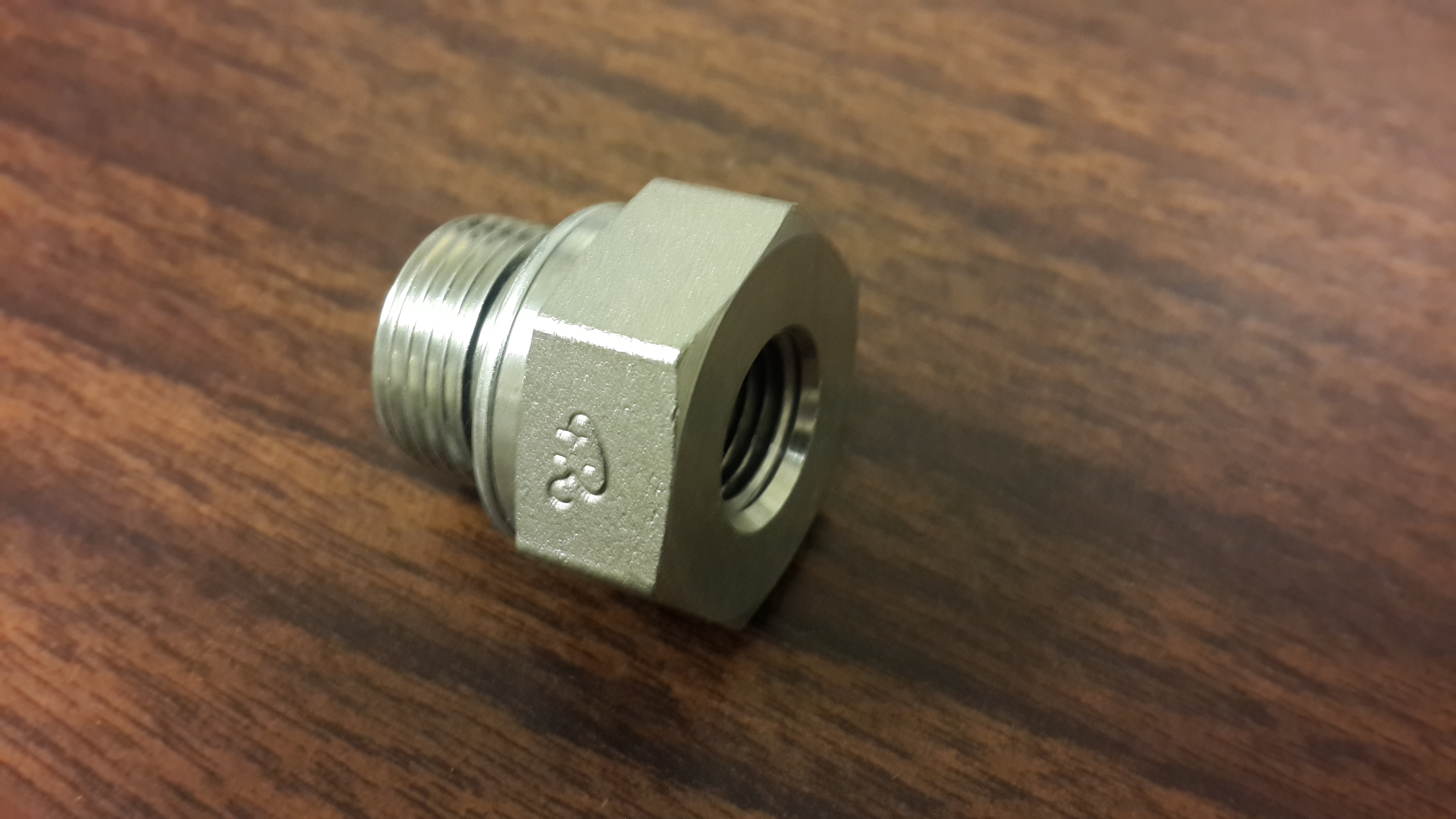

Pic #3 - Tompkins Industries part 7455-04-20. 20mm x 1.5 mm adapter
$12.74

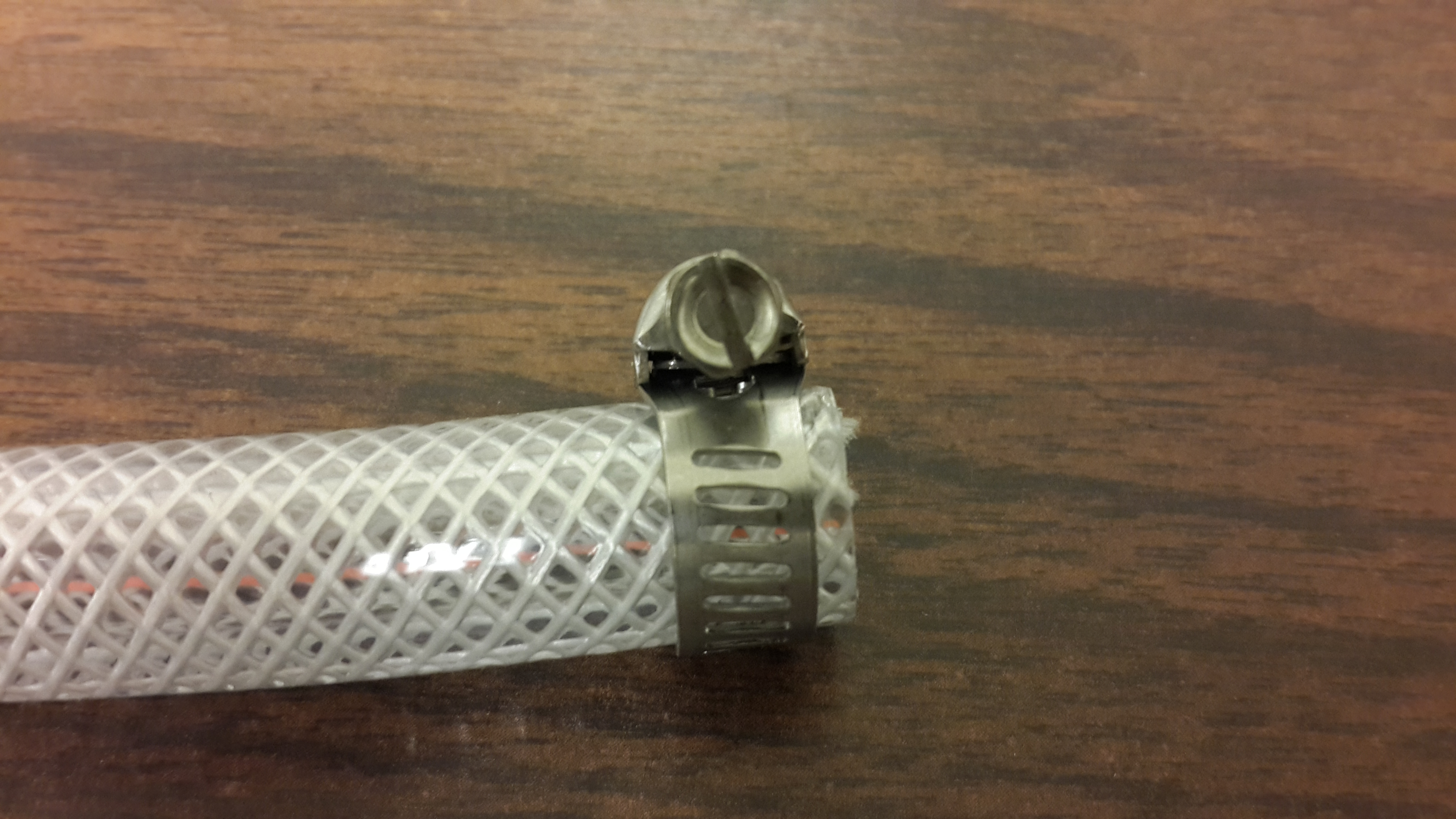

Pic #4 - Mini clamp w/ 12" length braided vinyl tube
$1.25
