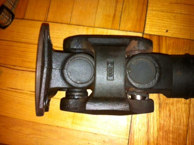

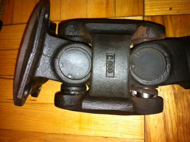

Old Mar 26, 2012 | 08:20 PM
JakeVT's Avatar
Joined: May 2009
Posts: 15
From: California
Well guys here is the culprit. Once I removed the shaft it was pretty easy to see what Happened. the needle bearings were ground up, and spit out and the U-joint was breaking down but still holding together. I dodged a serious bullet here as I drove for a while like this before I even knew there could be a problem with the driveshaft. Scary to think I was driving down the highway thinking what the hell is causing that weird shudder? Anyway thanks for the help to everyone. I replaced the shaft and the whole job was pretty easy.
Thanks again.
