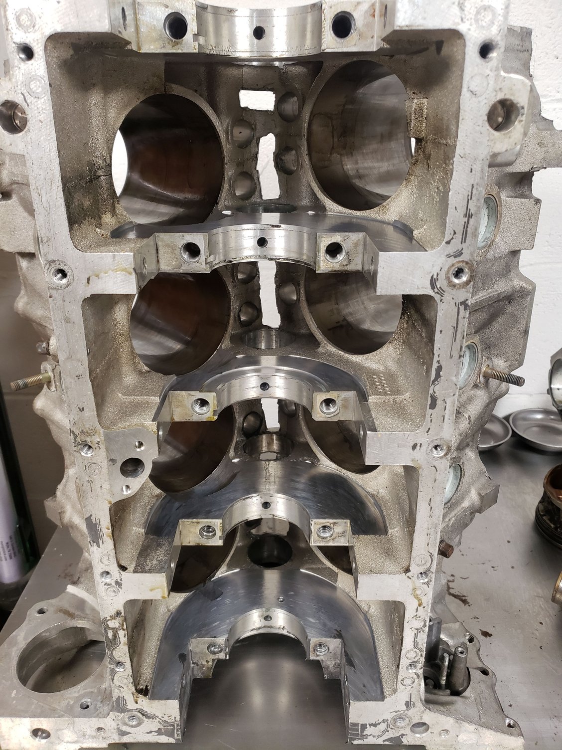

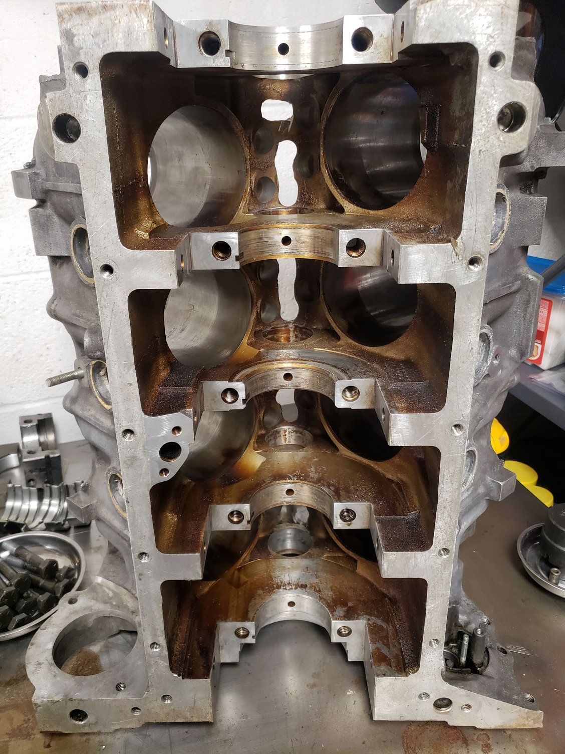

Yes, I have a cracked 04 4.6, and am rebuilding it in a 2000 4.0 block.
The 03-04 4.6 blocks have the worst reputation for cracking, as they were the last 2 years of that engine.
Supposedly the molds had not been maintained, which resulted in some blocks being cast off centered, meaning one side of a water jacket was thick, and the other side was thin...and prone to crack.
If your 4.6 has no current issues, and has not been overheated, it may never have any problems, never know.
The 4.0 blocks have a good reputation, as well as the P38 4.6, which was considered A quality at the factory, and only went into Range Rovers. B and C quality ratings went into D2's. The last year for a P38 4.6 was 2002.
As for the 4.0 and 4.6 blocks, yes, they are exactly the same.
The extra .6 liters comes from the stroke, and the crank and rods are the only difference(I think the 4.0 piston's top is slightly different in shape, and it is said that there is 2 tenths difference in compression ratio vs the 4.6, yet the 4.0 and 4.6 blocks are both stamped with 9.35 to 1 compression ratios. Regardless, they are otherwise the same, and both work in both blocks.)
There are rumors here of 4.0 vs 4.6 having a different casting ridge below the cylinder line, so liners can slip in one and not the other...and it's all bs.
Both blocks are the same.
Here are my 4.0 and 4.6 blocks side by side.

Thank you for this Info. they do look exactly the same... So i guess i should go on a hunt for 4.0 Block instead just to be on the safe side. Either way i would pin those damn sleeves
