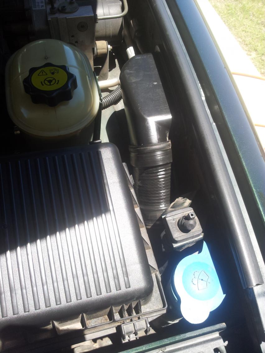

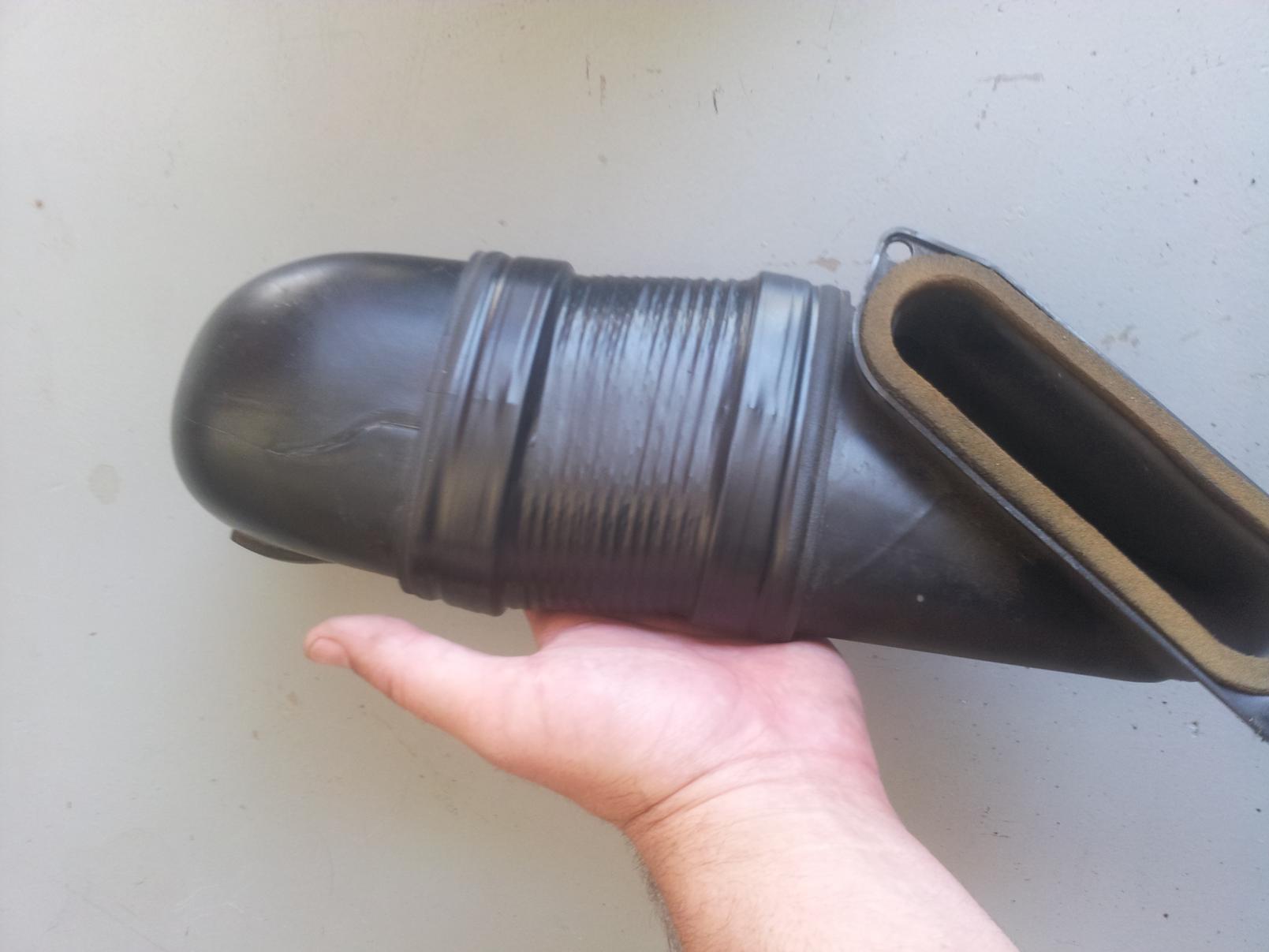

I used electrical tape to seal up the flexible part of the air intake tube from the air box to fender. I noticed my air intake temps were a little higher then normal on the ultragauge and after looking around I found the intake tube had some holes and was probably sucking in the hot engine compartment air. I deleted my before picture on accident, but the mesh like material was falling apart and had some good size holes in it. I couldn't find a replacement part so I figured I would give electric tape a shot. The tape sealed it up really go and it doesn't look that bad at all. Nice and cheap repair.
