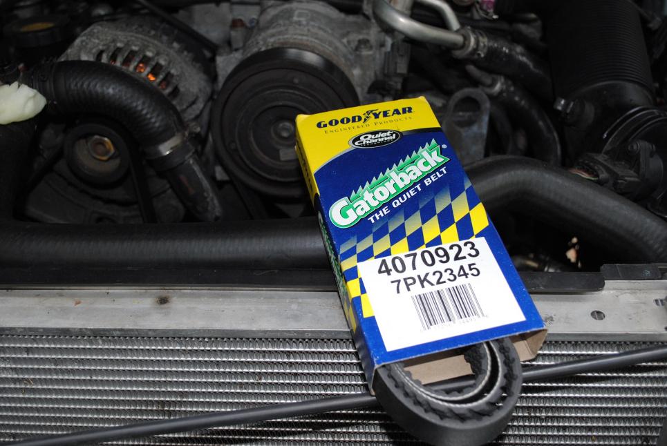

Installed a new Gatorback #4070923 Serpentine Belt this afternoon.

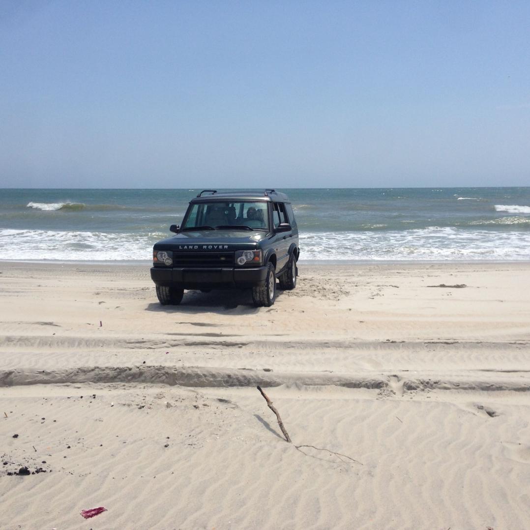

Default Took the Disco to the beach.
Drove from Sanford, NC to the North End of Carolina beach. Almost got stuck first going out because I forgot to put it in low range but after that all good. It's amazing just how good this truck is, I am on General Grabber ST's that need to be replaced and completely stock. Can't wait till I add my TreadWrights!

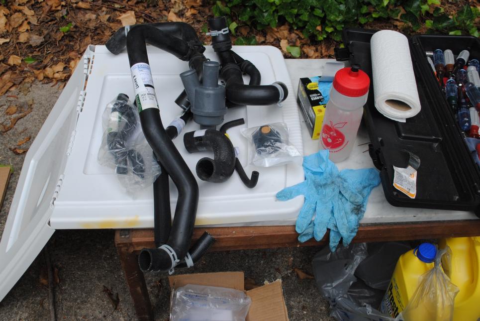

Flushed radiator, new hoses, 180 thermostat, coolant reservoir cap and of course fresh green stuff. Took much longer than it should have... but that was mainly due to me using the spring clamps which were an absolute PIA in some spots. I did replace with nice made in USA worm clamps at the heater hose, which was the hardest one to take off as it was basically melted on.
*2 main hoses and thermostat were Genuine, the rest of the hoses were All Makes. I ended up not replacing the throttle body hose, although I have it. (just got late and it actually looked ok to me). Also didn't bother with the hard coolant lines for the same reason, but have the shorter one on hand and plan to replace the longer one that runs along the radiator with 5/16" fuel line when needed.
All in all a good day for the Disco and happy to have it done.
