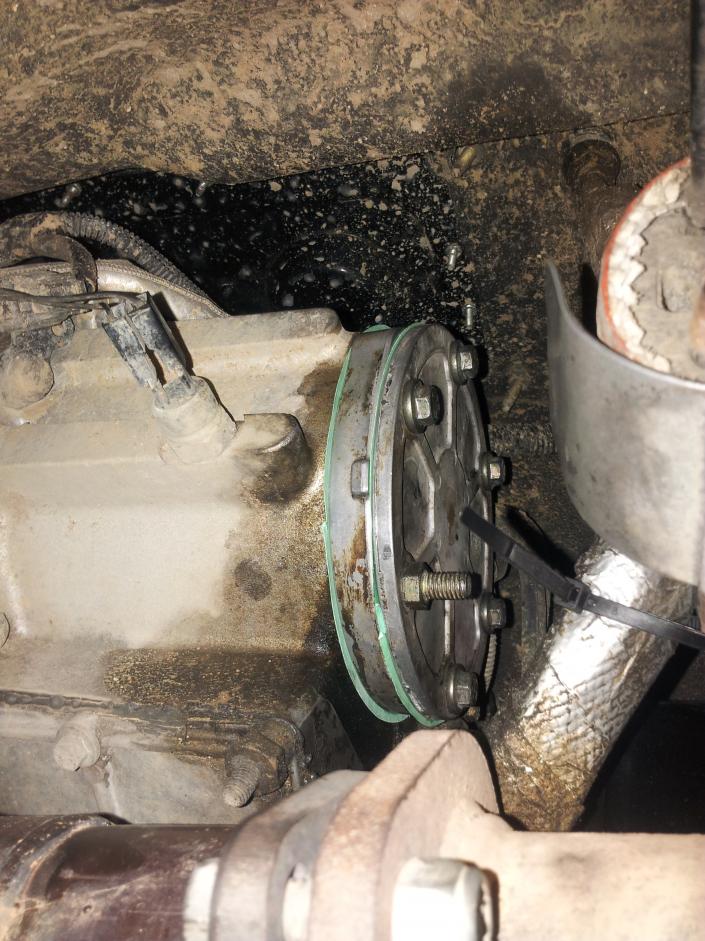

I installed a gasket on the leaky rear cover plate on my T-Case. I've been having a small leak from my T-Case for a while now and I ordered a gasket kit a few months ago and I finally strated replacing the gaskets I can get to without pulling the T-Case. I think I might have a few different leaks but it's not much (only about a nickel size spot on my garage floor each morning) but it's been driving me crazy since I bought the truck over 2 years ago. I tried blue devil stop leak but no dice so now I have to do it the right way.

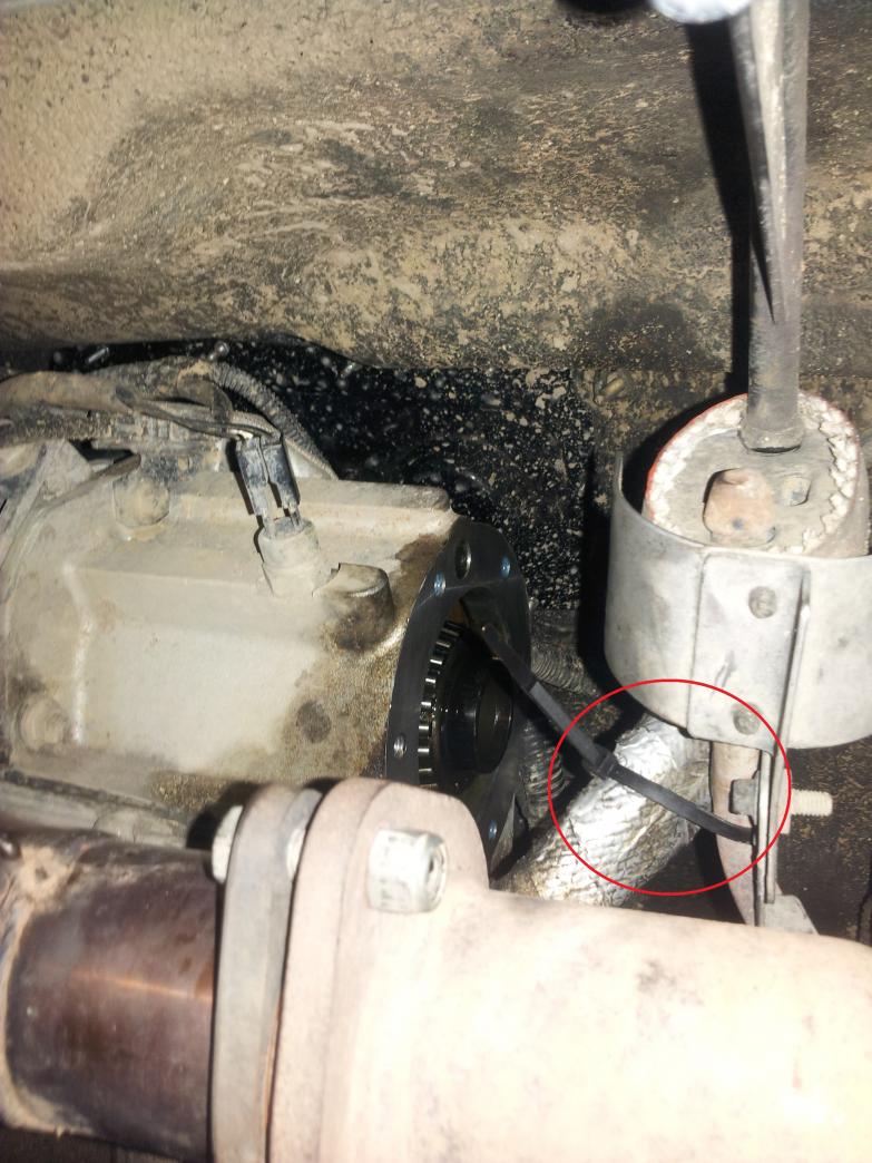

I used zip ties to pull the parking brake cable out of the way so I could get my 1/2" drive up in there to break the 5 bolts (13mm) and stud (15mm) loose. Once I broke them loose the air ratchet made quick work of the rest of the job. I just pulled everything off and out to clean it up really good for the new gaskets.

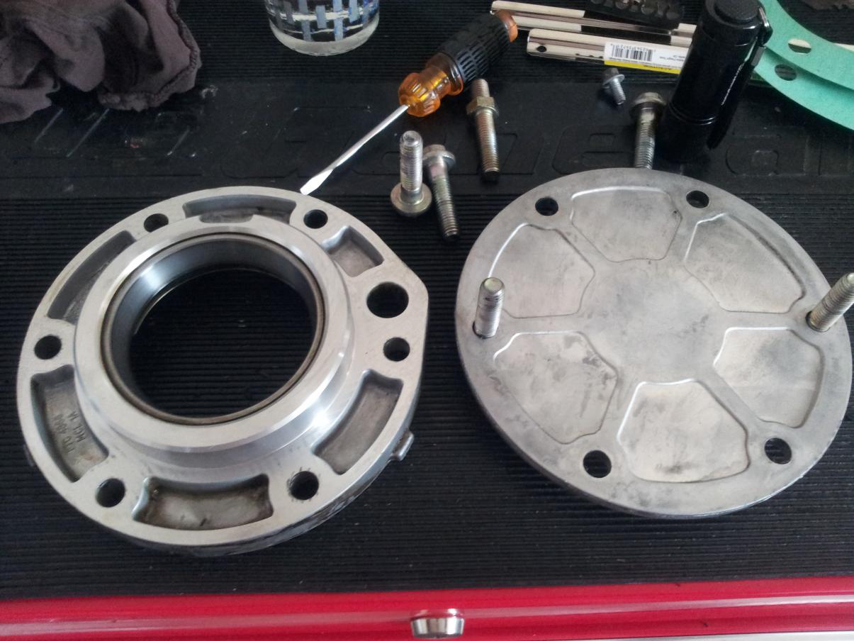

There was some thick sludge on the inside of the back cover but it cleaned up nice.
What did you do with your DII today?-20140724_143936.jpgWhat did you do with your DII today?-20140724_143915.jpgWhat did you do with your DII today?-20140724_152707.jpg

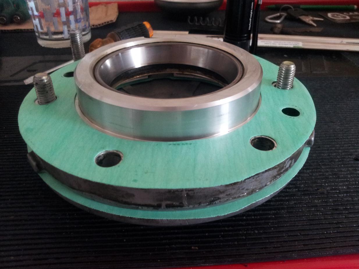

New Gaskets going on. I used two of the bolts to keep it all aligned and installed it all in one piece.
What did you do with your DII today?-20140724_152759.jpgWhat did you do with your DII today?-20140724_152845.jpg

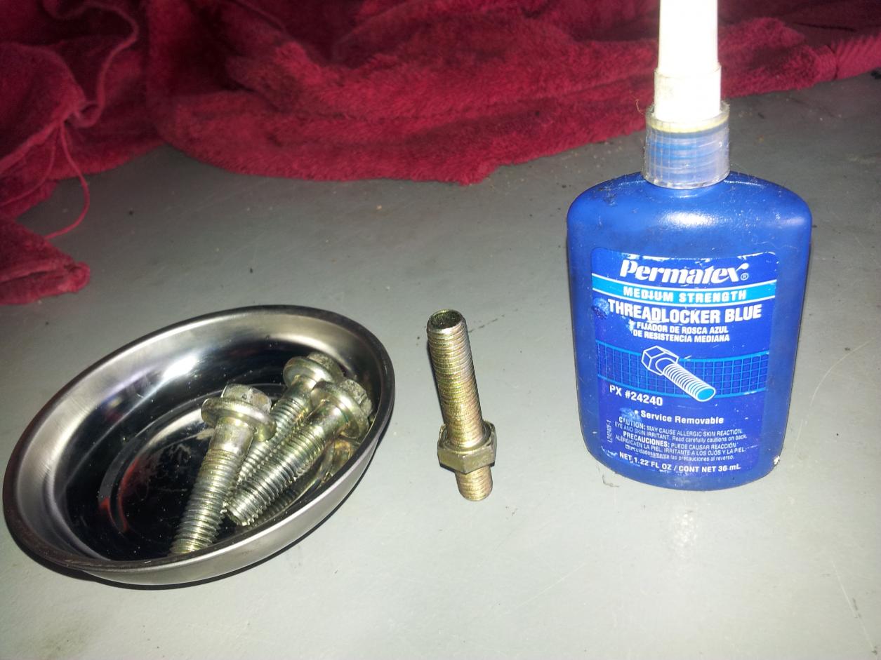

Use fresh thread locker on the bolts and stud when installing. Take extra time to get all the old thread locker off. I used a wire brush for the big stuff and through the bolts in the ultrasonic cleaner to finish it off.
What did you do with your DII today?-20140724_153906.jpgWhat did you do with your DII today?-20140724_155609.jpg
