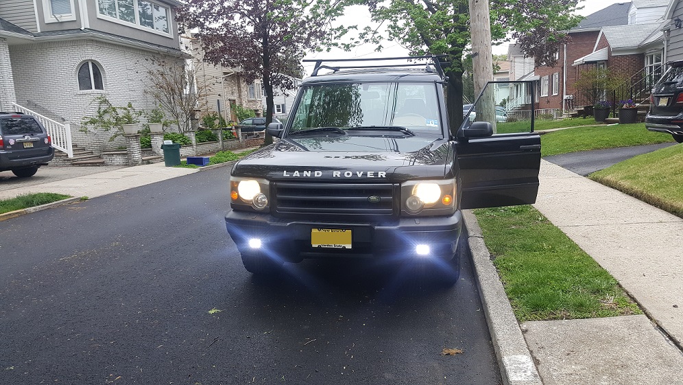

After dragging my feet and sitting on these for 6 months, new fog lights.
Cut the connector for the old fogs lights, Soldered in some 2 pin trailer connectors. on the harness and the fog lamp and boom, easily replaceable, cheap to replace for lamps.
Bolted to the front bumper support bar for rigidity.

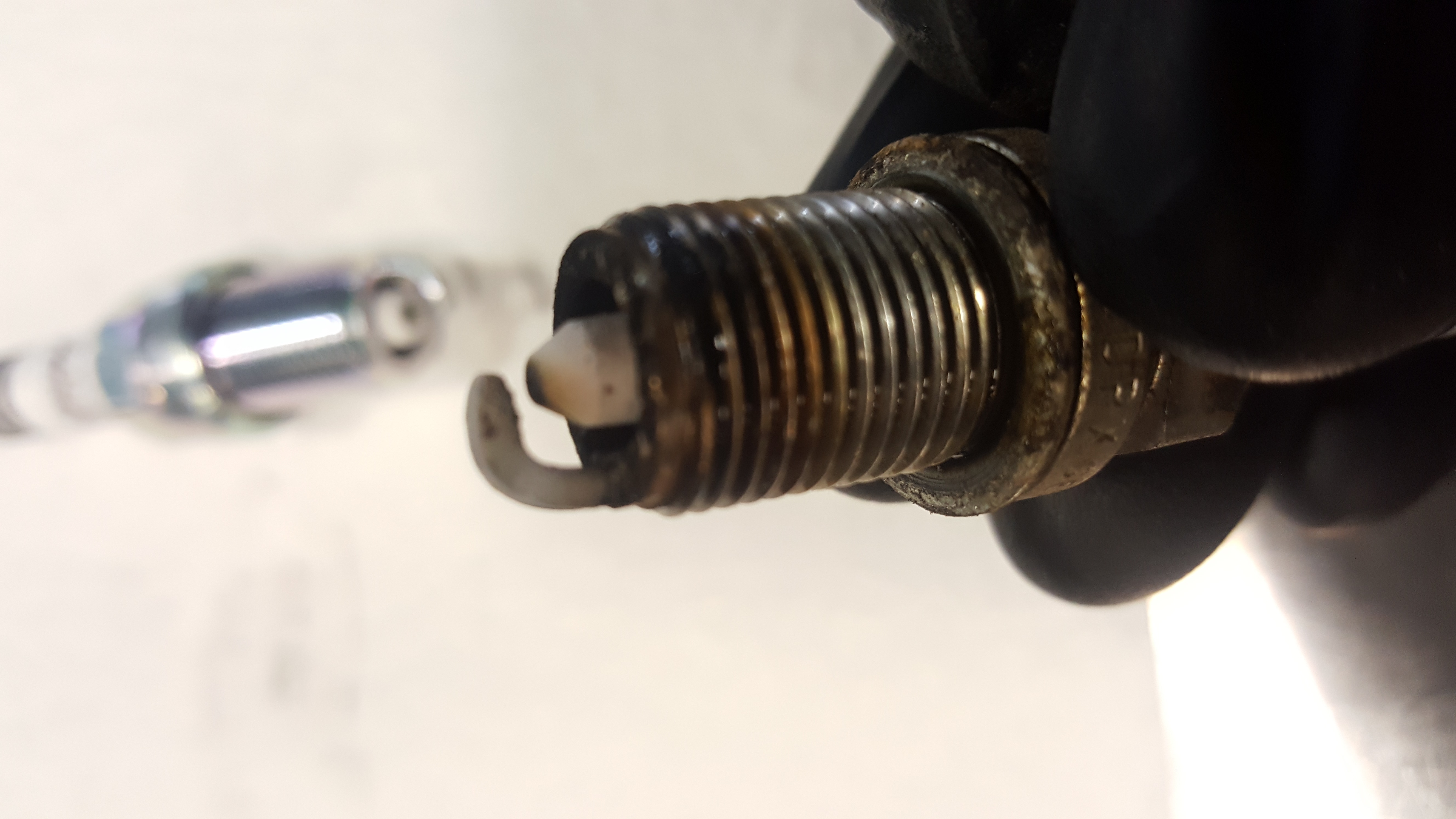

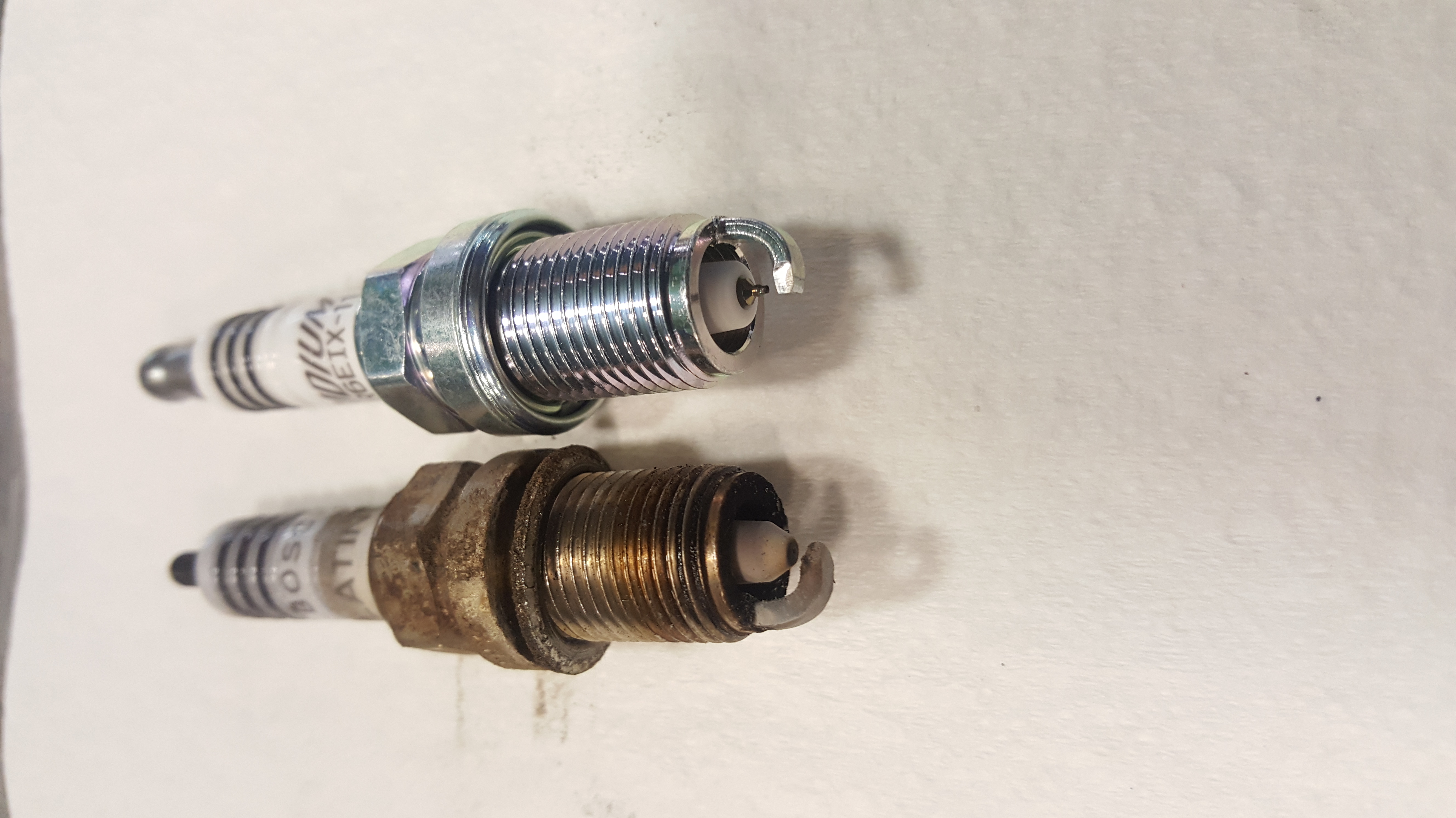

Did spark plugs this morning. Had a "misfire" at idle but wouldn't trip the CEL. These plugs only have 25k on them, Bosch platinum. Oil is changed every 3500, engine air filter is changed every 10k and only premium gas is used
Went with NGK iridium this time around.

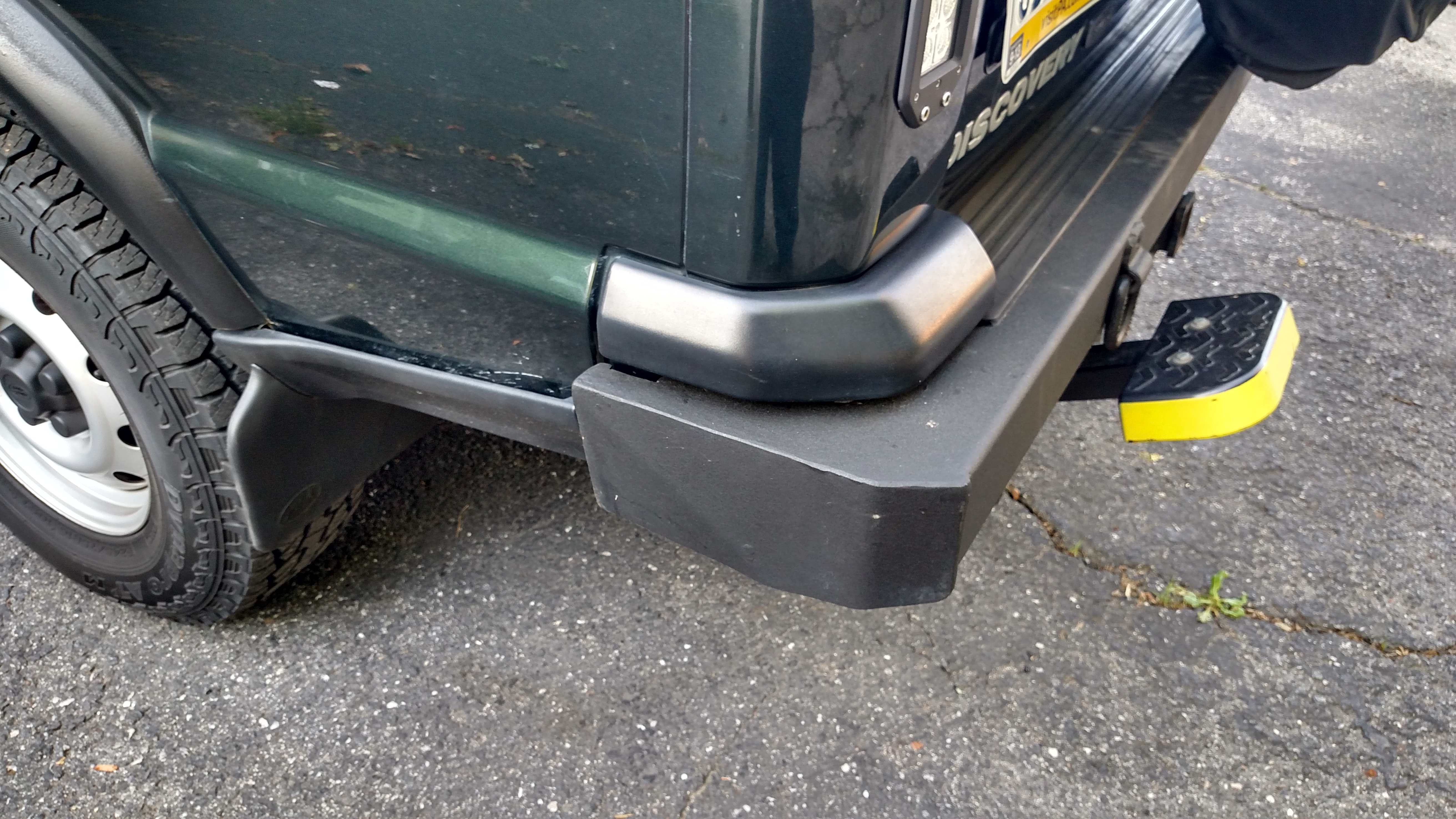

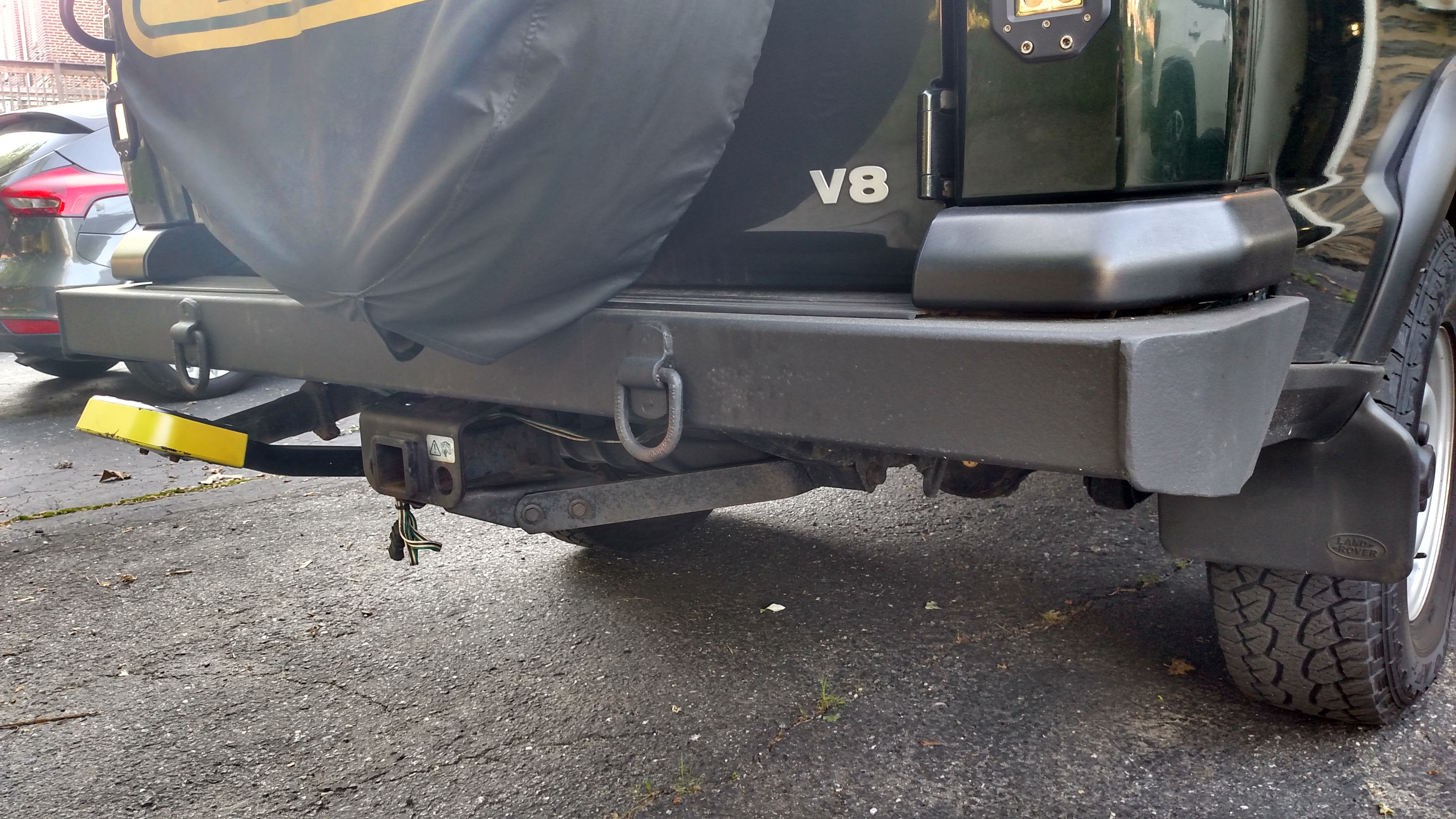

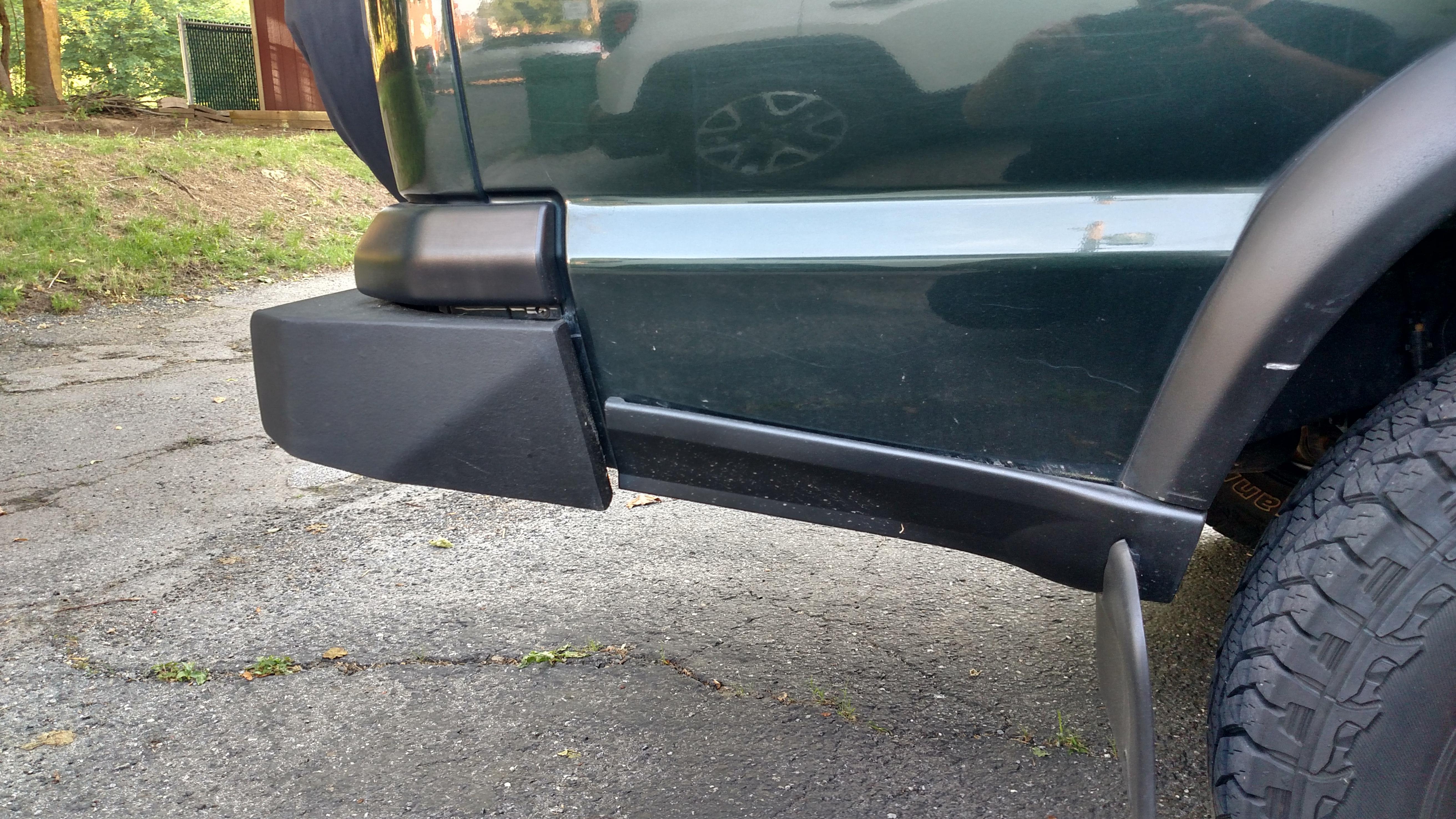

Default home-made rear bumper
Finished my rear bumper. I finally have real steel on all 4 sides now; I feel bad for the guy with a plastic car that is unlucky enough to run into me!
I trimmed some of the aluminum (or aluminEum, so all you Brits know what I'm talking about! ) from the rear quarters so there's less chance of getting hung up..

Do you happen to have build pics? that thing looks nice and beefy!
