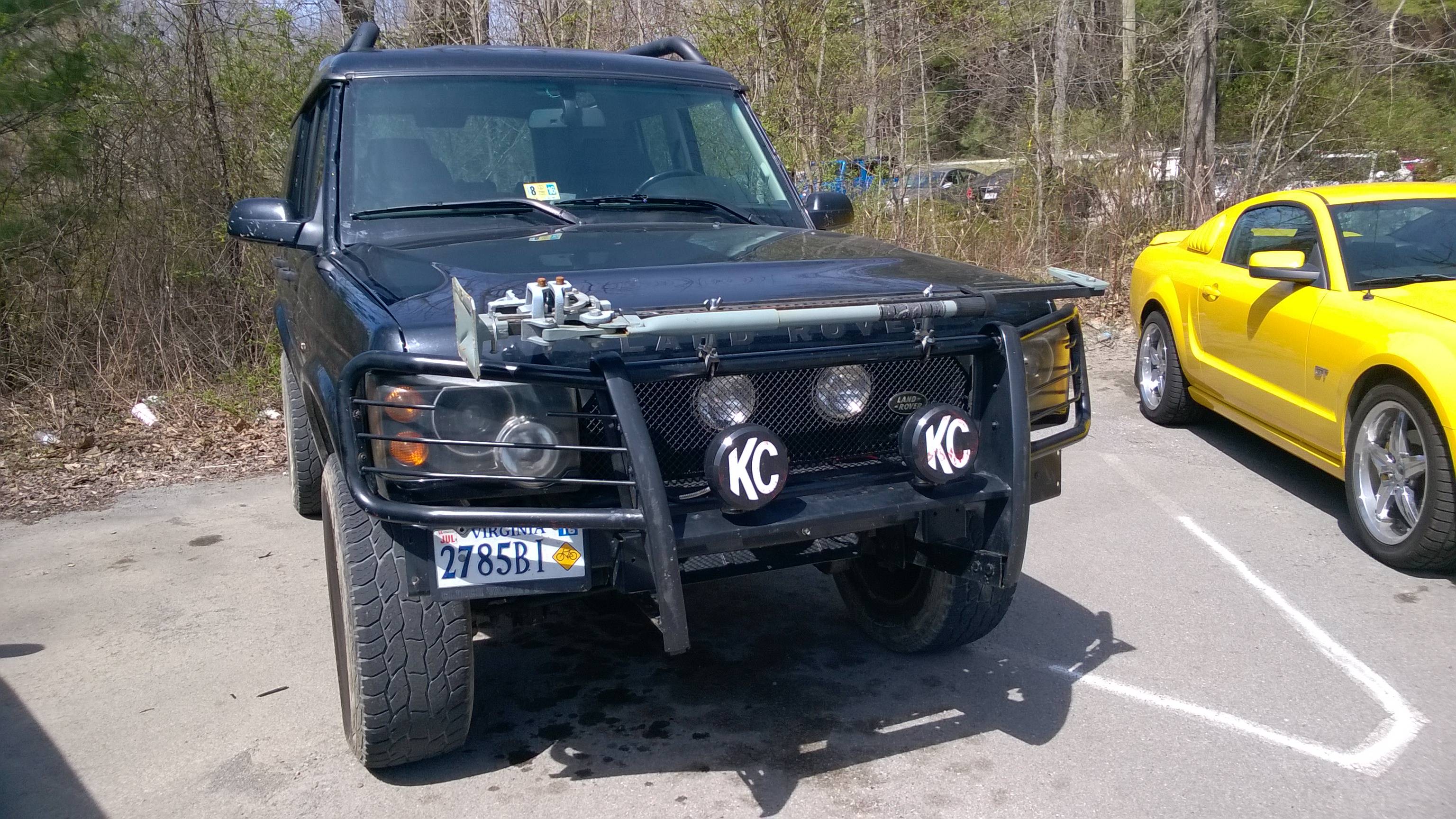

Welded up different mounts with smaller clamps and moved my hi lift off the too and onto my push bar. Not sure how well I like the look yet, been getting mixed reviews. At least I don't have to worry about the jack rust staining my roof.

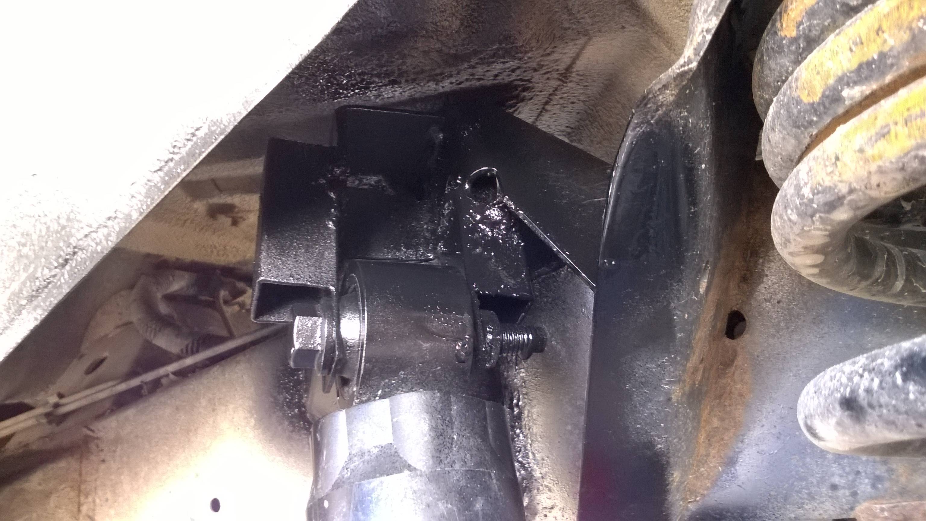

Welded up lowered rear shock mounts, but I'm not a huge fan of the design so no write up yet. I'll do a write up on the shock mounts when I move my axle back in the likely distant future.
I promise its welded better than it looks.

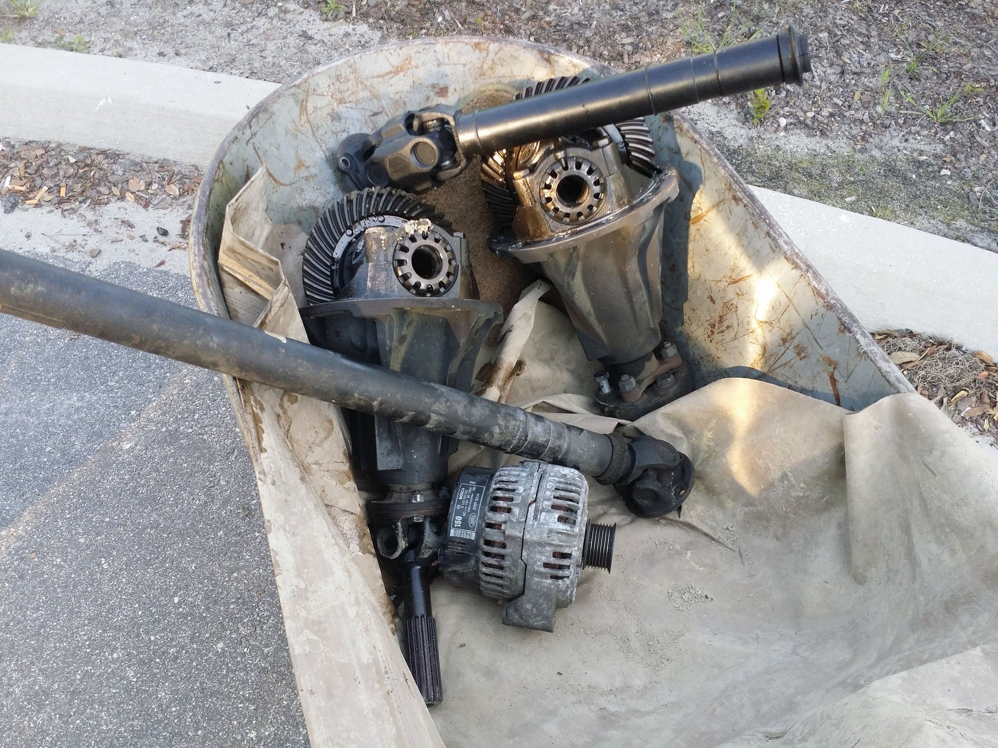

Picked up both front and rear differentials with the drive shafts as well as a range rover alternator all for $60. Junk yard had an "all you can carry special " going on.
