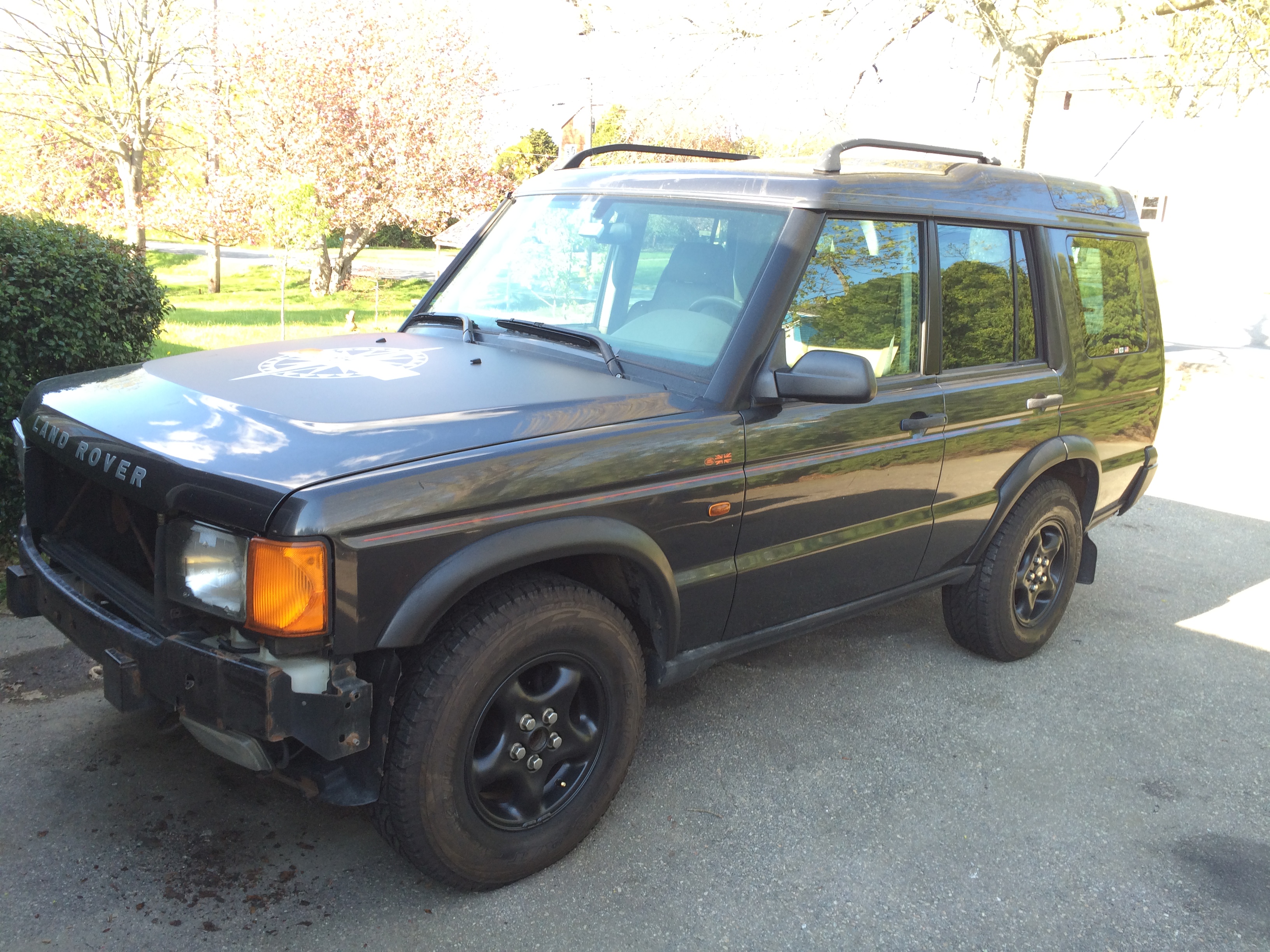

Old May 9, 2016 | 11:57 PM
  #3254
mx468's Avatar
Joined: Aug 2008
Posts: 594
Likes: 40
From: Newport, Rhode Island
Default New tires and plastidip
Just put on new tires and plastidipped wheels. 245 75 16. Also flipped spare tire holder.
