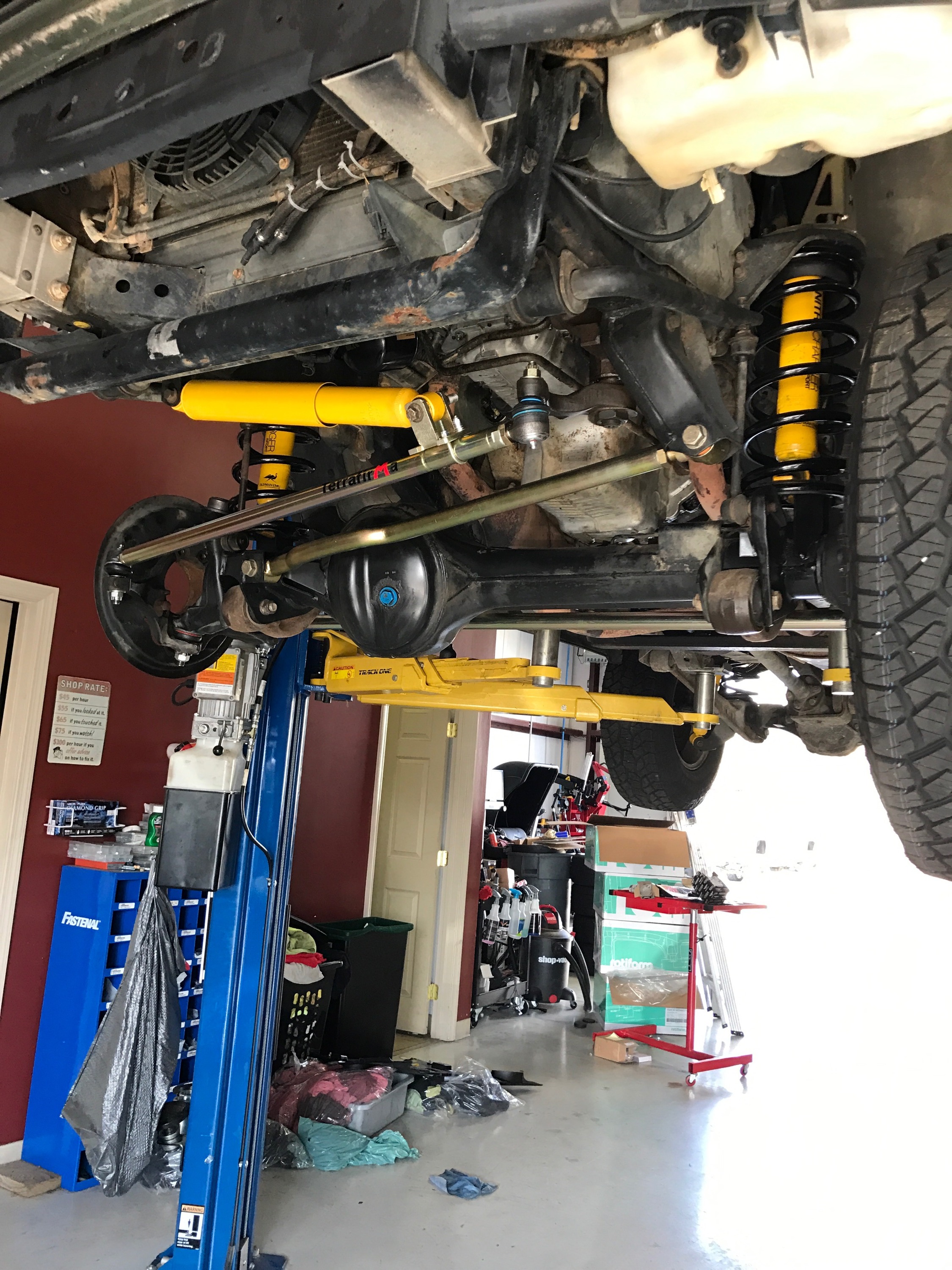

Refreshed the suspension with new ball joints and the terrafirma bars, finished installing the old man emu kit, and had to replace the axle boot on the passenger side. pulled the rear tail light guards and good passenger side tail from my donor disco2 and installed on my good disco2.
