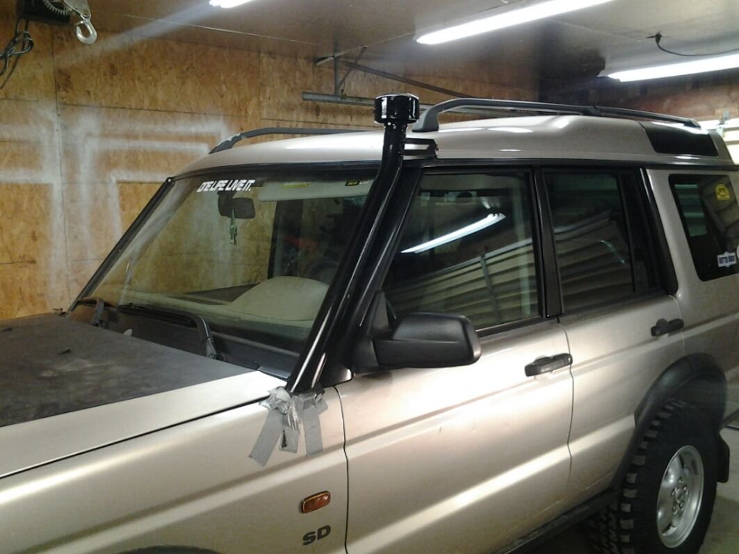

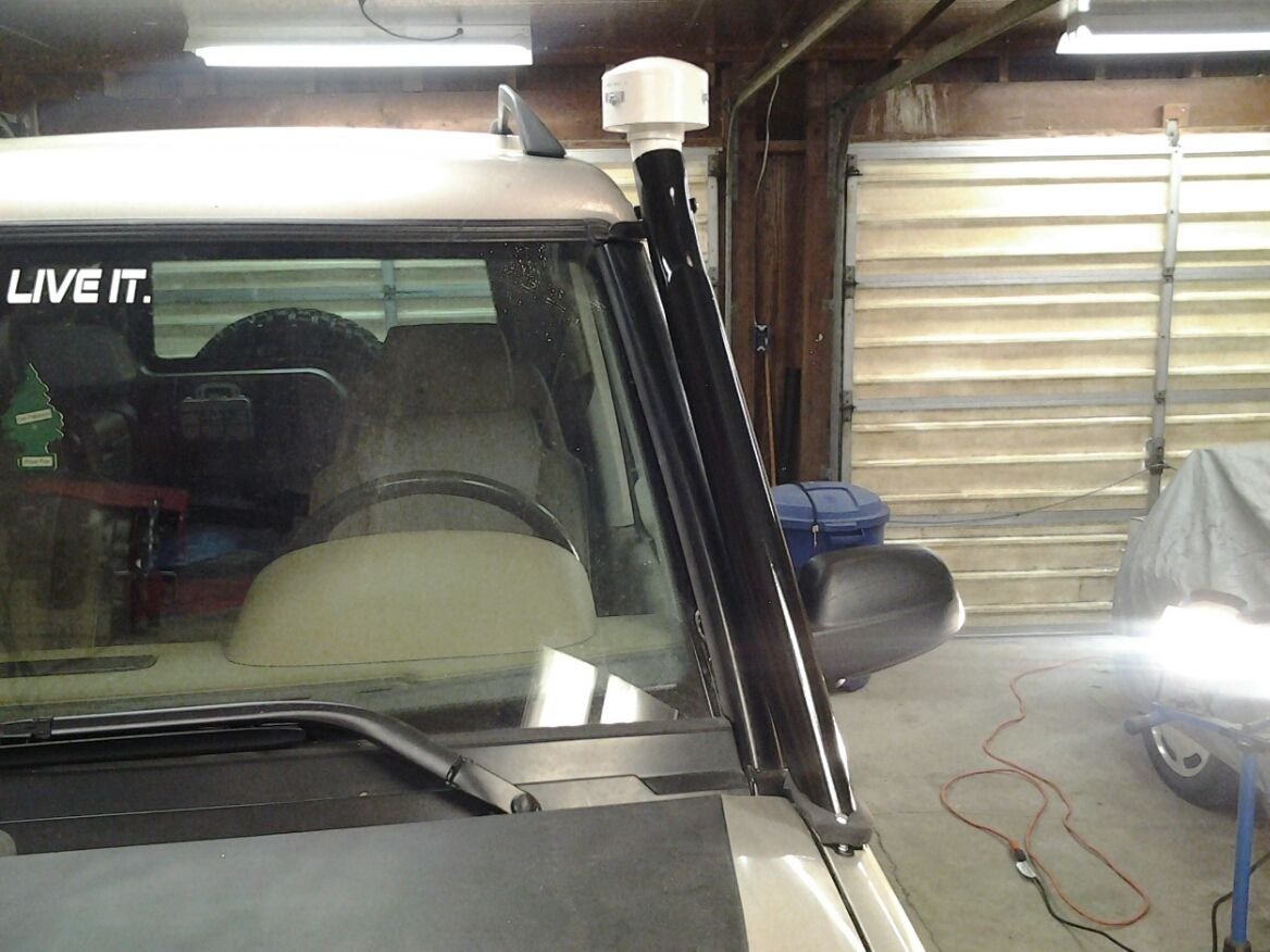

Added military type snorkel top. Few dollers at the hardware store...verses...waiting to order one.
While waiting for the first coat of paint to dry, remounted the TCU higher under the seat. Usually, it is under the bracket (which would hold radio amp)...but I slipped a few pieces of rubber under it and zip-tied it to the top of the bracket. Gained a few inches, incase water get inside rover and the zip ties make it easy to remove if it does get wet.
Painted snorkel. Yes, the duct tape will come off fender...just holding the gasket around the base while the sealant dries. Not to bad, for a total cost of 18 bucks.
Left the cover off the bottom portion of the seat, makes getting my feet through the opening easier. Removed the rear stops on the seat sliders and will be adding 2 pieces of steel to lengthen the adjustment a few inches.
