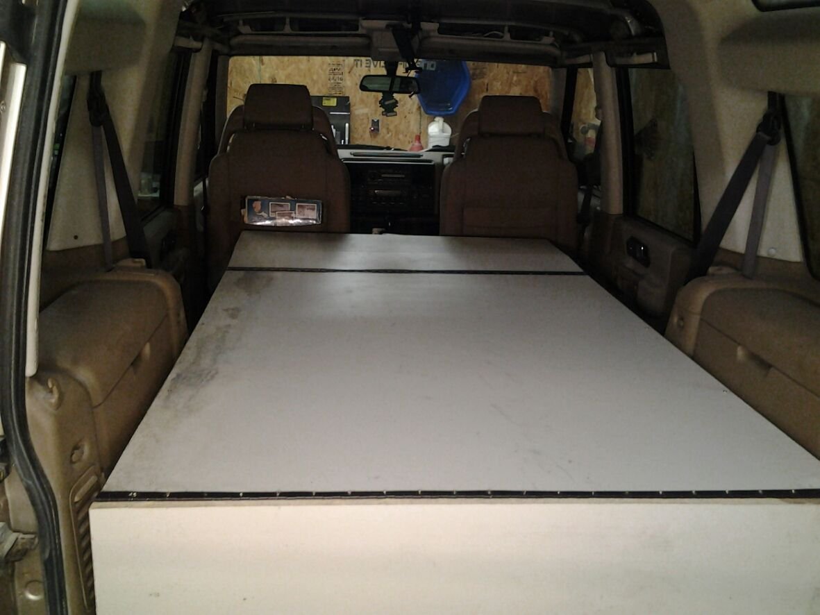

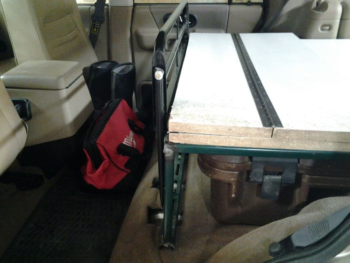

Worked on sleeping platform/storage compartment.
Storage.
Storage containers in place.
Folded out for sleeping.
Hinged extensions.
Extensions folded back out of the way, but rack in place for extra storage.
Rack in stowed up. Can be flipped down and stowed that way too.

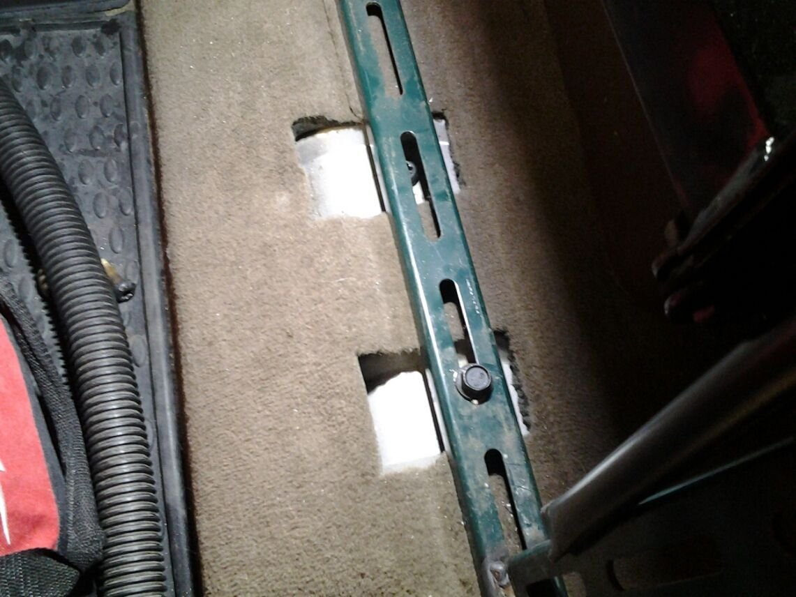

Used seat bolt holes for framework securing.
Might close in the sides in passenger seat area and add some carpet.

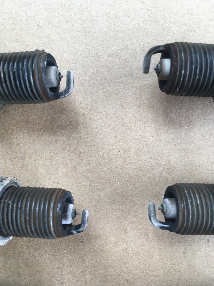

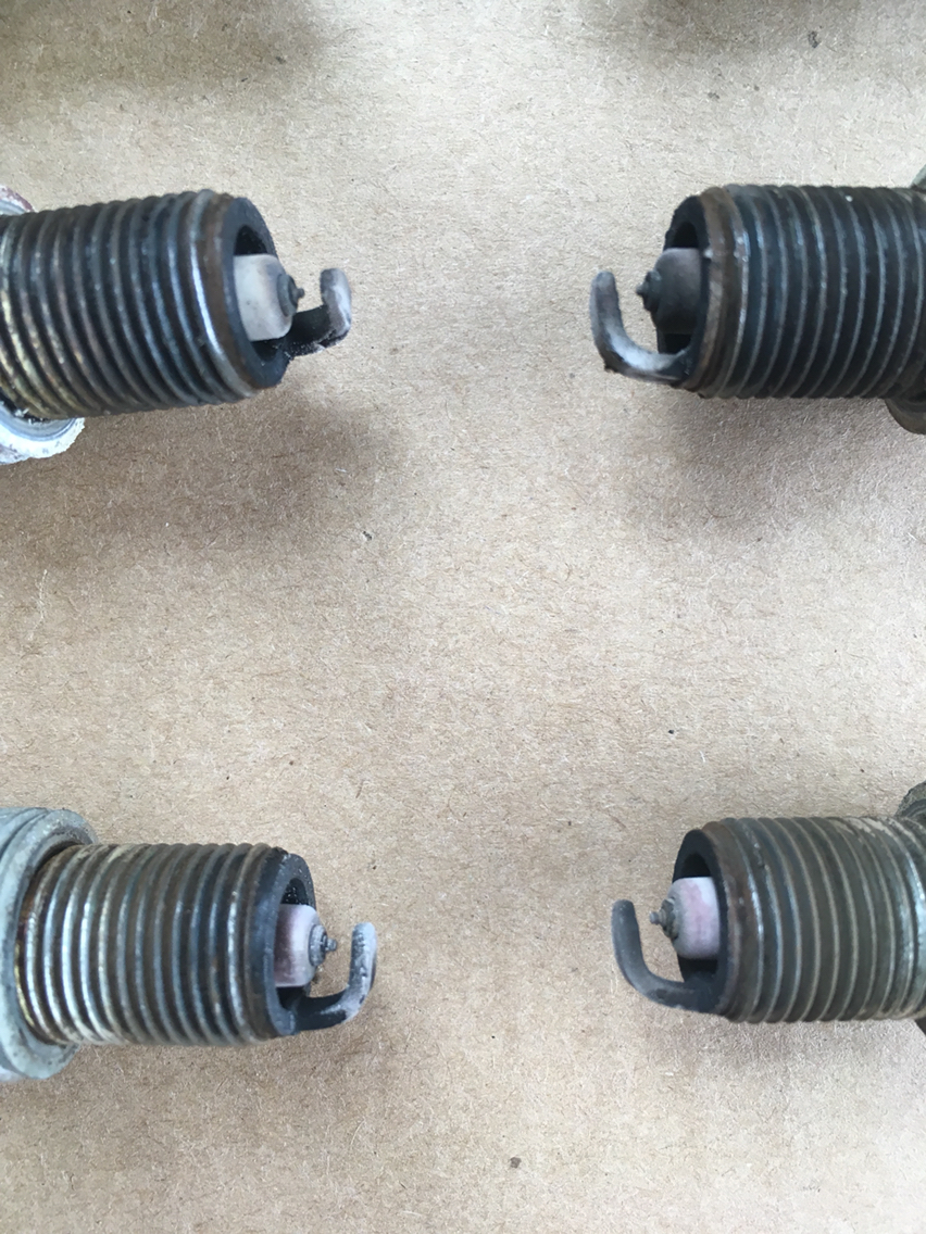

The old plugs looked good color-wise, but the center electrodes had all deteriorated over time. Instead of the 0.040 gap they had when installed new the gaps ranged from just under 0.050 to over 0.055. The plugs removed from cylinders 7 and 8 had oil on the outside from the leaking valve covers but were otherwise okay.

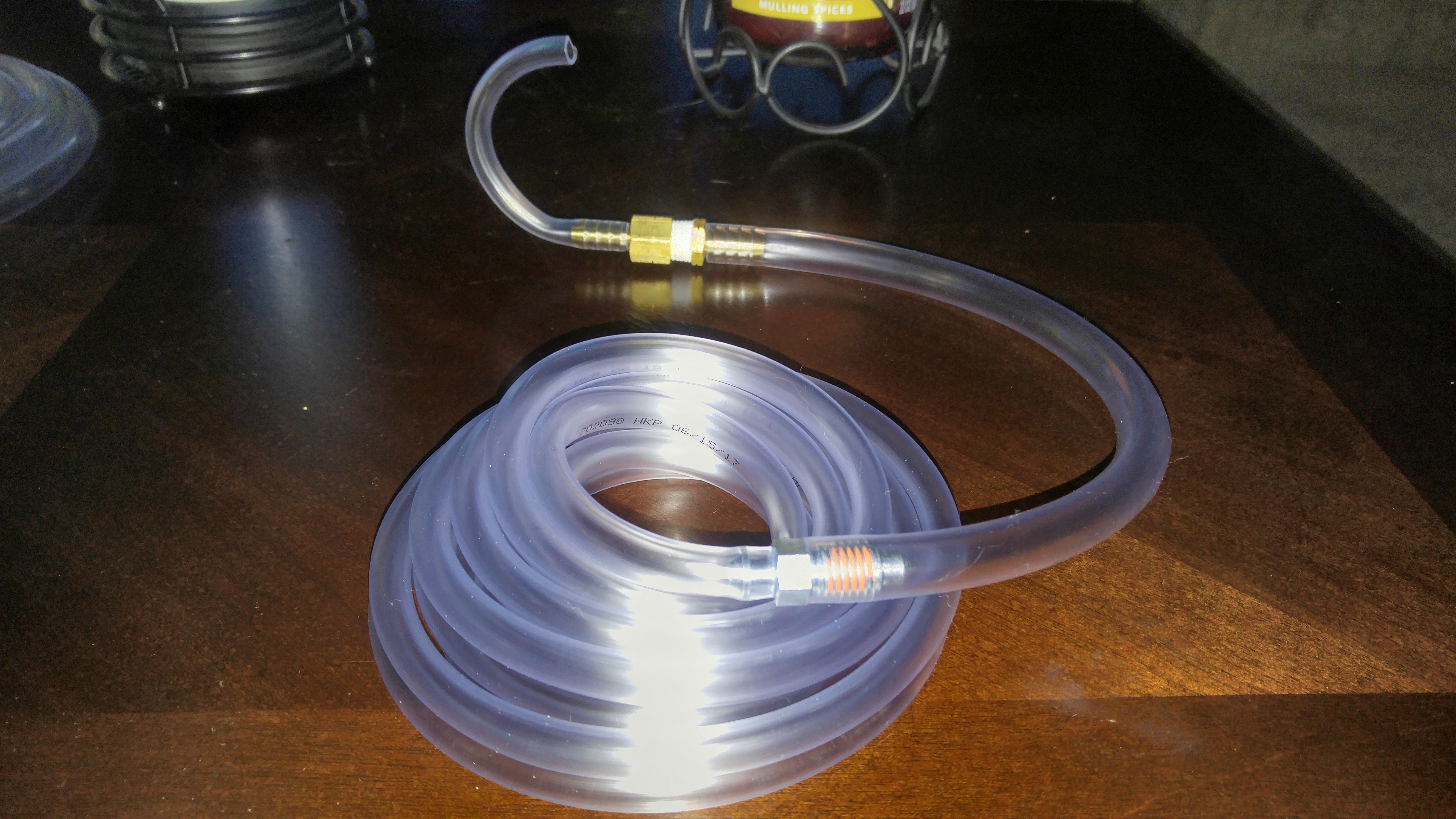

Default 1-Man Brake Bleed Set-up
The Problem: (1) I can't count on anyone around me to be a pedal-man to help me bleed my breaks. (2) I can't seem to get a "one-man bleed tube" here in less than a week. (3) I don't like the idea of spending a ton of money on a pressure bleeder/vacuum pump/Hawkeye, etc... (4) I live in New England, and can't trust speed bleeders not to turn into little ***** of rust on my calipers.
My Solution: Basically, I just put an in-line speed bleeder onto a standard two-person tubing/bottle set-up.
In theory, this should let me run the tube from the caliper bleeder nipple to a bottle or bleeder bag like normal, but will let me pump the pedal myself, while the speed bleeder prevents old fluid or air getting sucked back into the line when I let off the pedal (just like the One-Man Bleeder Tube I'm too impatient to wait for).
The likely failure points: (1) The unattended tube popping off the bleeder nipple while I'm pumping away in the driver's seat. (2) The tube feeding the speed bleeder doesn't allow for sufficient flow-rate to handle the 25(ish) PSI. and well... see #1. (3) The fittings going from 3/16 to 1/4 fail under pressure, making a huge mess, or, well... see #1.
I'm not posting this to say this is a good idea or anything like that. I'd definitely recommend just getting the right tools for the job, but just thought I'd give everyone something to yell at me for haha.
I'll let you know how it goes tomorrow. Who knows, maybe it will work.
