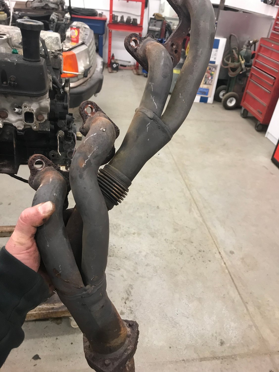

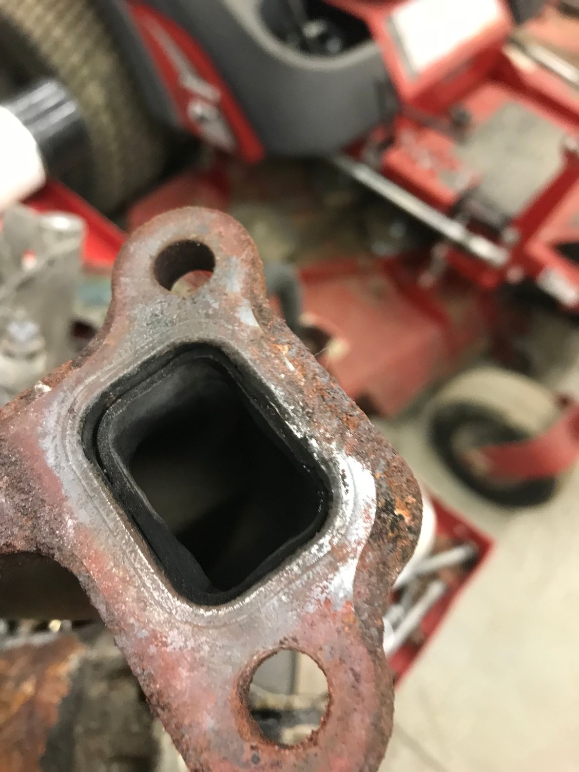

Does anyone have experience with the p38 headers? Do they bolt in spot of our d2 manifolds? Are they actually any better? Looking at the flange to pipe junction appears restrictive. I suppose I could weld and grind smooth.
Old Feb 21, 2019 | 11:02 AM
  #6433
Best4x4's Avatar
Posts: 7,997
Likes: 2,506
From: Beaumont, TX
They’ll bolt up to the engine, but they won’t fit due to how they drop down vs the D2’s setup without some pretty serious modifications.

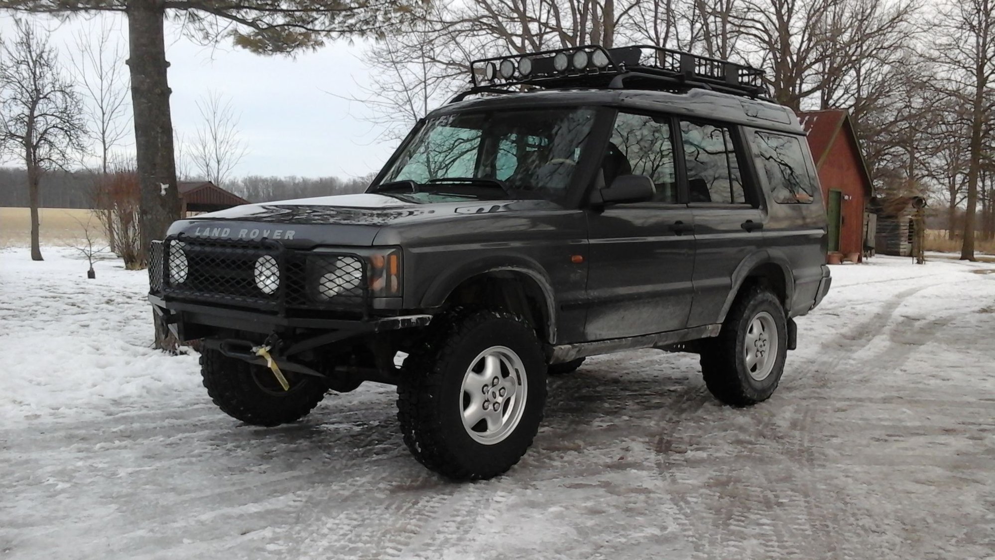

Threw the roof rack and light bar on the 03.
40° here today, so l messed with the beast. I've added about 2K to the odometer, since buying.
Brian.

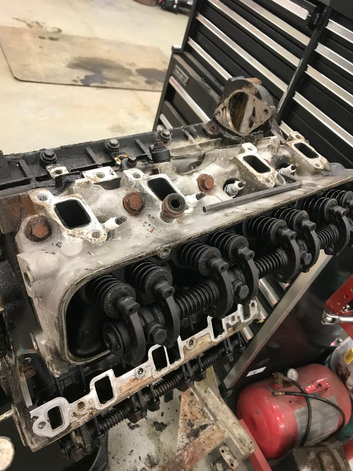

I stripped 1 headbolt 😡😢. I obviously should of pulled the sai fitting first to align my socket and breaker bar better.
Anyone have any good ideas how to remove this damn bolt? Should I weld an old socket on it? They are torqued down crazy hard. I snapped 1 extension already. My impact wouldn’t even touch them. I had to use a 2’ breaker bar and lots of force. ( I’m no weakling- I’m over 250lbs lol ) I was actually afraid of snapping the block off my engine stand.
i had same problem when I did my heads...after I rounded the bolt, I used a bolt extraction socket. Beat on good, then used a 5 foot cheater pipe on my breaker...
Engine was in the car though so you’d have to wedge it somewhere

I have had luck with the sacrifice socket. The almost fits SAE socket that I hit with the BFH to get it seated. Than get the bolt off and throw it and the socket in the trash.

there are some good suggestions in the short thread regarding my similar situation: https://landroverforums.com/forum/ge...estions-78704/

Are you using a good quality 6 point impact socket?
That doesn't look that rounded off to me, still plenty of corners on that bolt head. Do not use chrome sockets for these types of torque applications, they flex and distort under these types of pressures. Try heating the bolt, not the aluminum, and let cool, while cooling hit it with WD40, heat again and soak again with WD40, once totally cool, wack it with a heavy punch and hammer, then use your air gun on a medium setting (with a quality 6-point impact socket) and let the gun gently "hammer" on the bolt. This vibration will usually break the static tention of the surrounding corrosion.
If this doesn't work...C4 would be my next plan of action.
