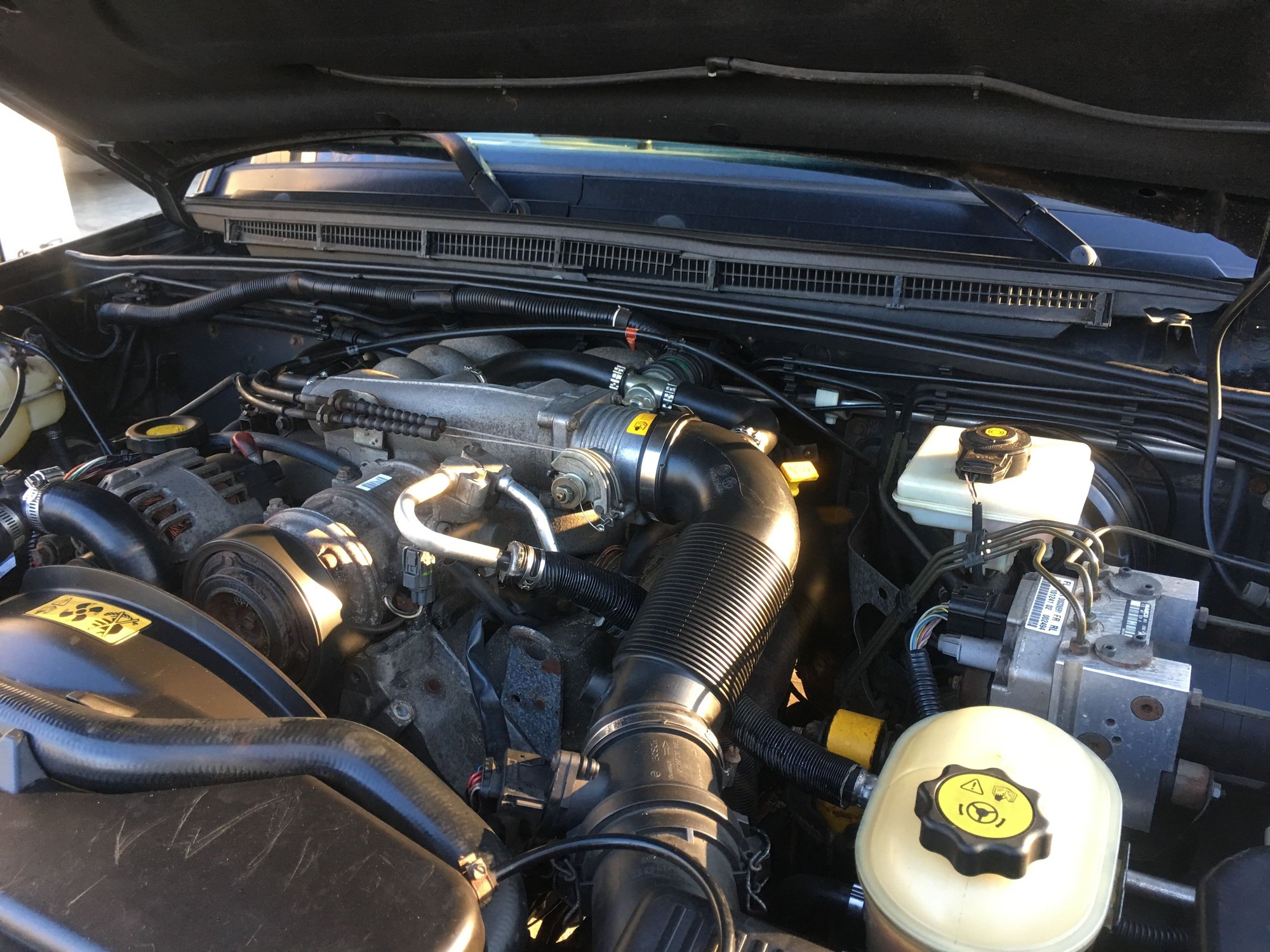

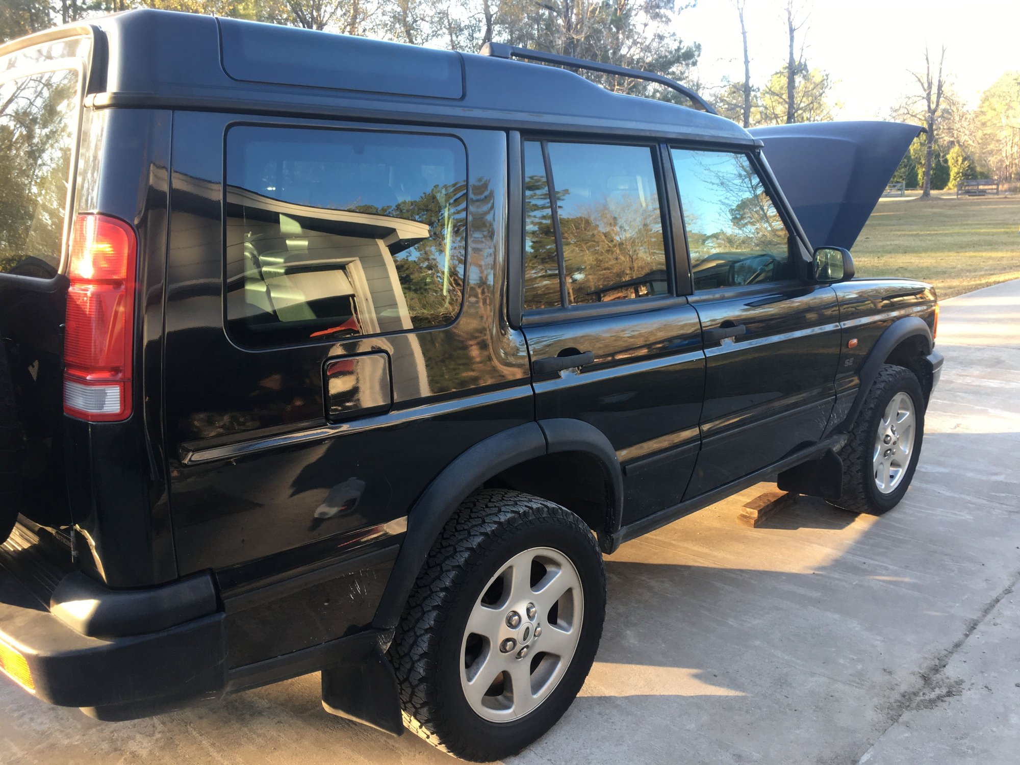

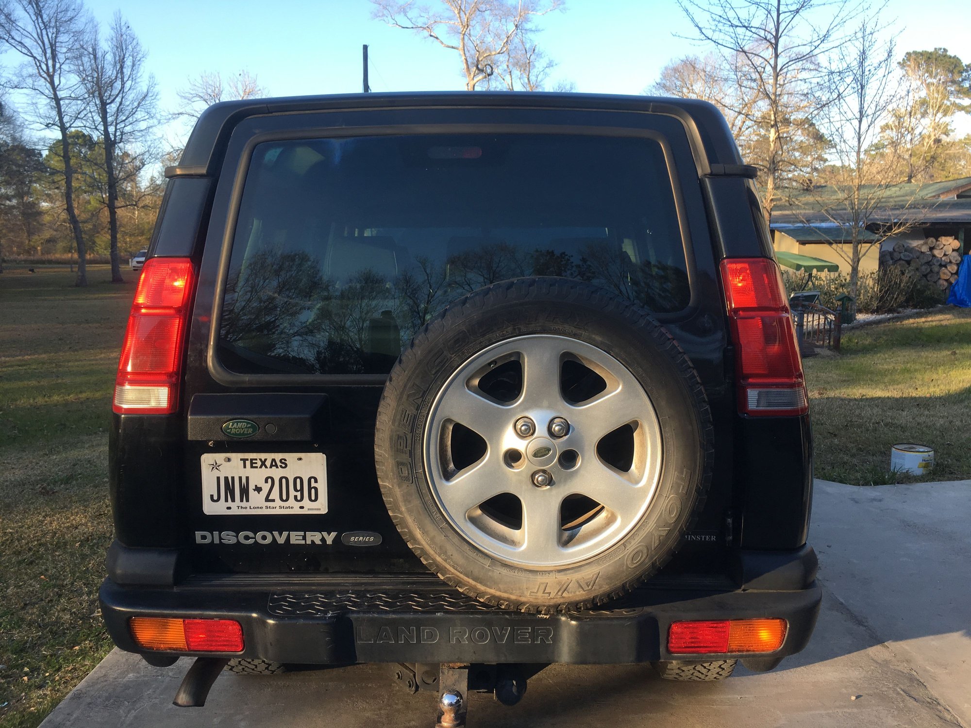

This is the 02 Westminster I've been tinkering with.
Fixed Items:
1. New water pump & gasket
2. FV308 PCV Installed
3. New water pump hose
4. New OEM T with SS Clamps
5. Removed TBH as it was seeping badly and ran 5/16 line from intake to reservoir
6. Installed good OEM Front Drive Shaft
7. Fixed PRND321 Linkage
8. Fixed center dash coin/ash tray bins
9. Installed D1 Cargo Door Handle Cover (could install backup camera into D1 lock cylinder hole)
10. Replaced instrument cluster PCB (someone pulled the LED's off for the ABS/TC/HDC)
11. Replaced Temp/Tachometer Gauge as the temp gauge was INOP & then SYNCED PCB to the BCU
12. Replaced various light bulbs that were INOP
13. Properly secured the OEM wooden skate board, replaced 2 window switches, and re-installed the cup holders
14. Installed new Group 65 battery and eliminated a funky ground cable
15. Finally got an actual 180F thermostat installed and it will idle all day long with the HVAC on at 204F tops
16. Cleaned IAC as it was completely stuck open, now it functions properly
17. Got 4Hi/N/4Lo linkage free and now it engages properly
Still not fixed:
1. E-Brake cable is trashed
2. Rear Cargo Door limit strap is INOP
3. Drivers window is INOP
4. NAV/Stereo has no power (however the CD Changer cycles)
5. Rear shocks are completely useless
6. HP22 will not move when placed in D (weird whirring noise from back of transmission/valve body), but if you cycle it thru 1,2,3 and then into D it shifts and drives fine
7. Diagnosed ABS & LF Wheel Sensor/Hub is INOP
8. Found rear cargo door wiper arm in the back storage bin, needs a replacement blade
9. PS Pump seeps, added some Lucas Stop Leak to it, and it works however on a cold morning the pump moans
