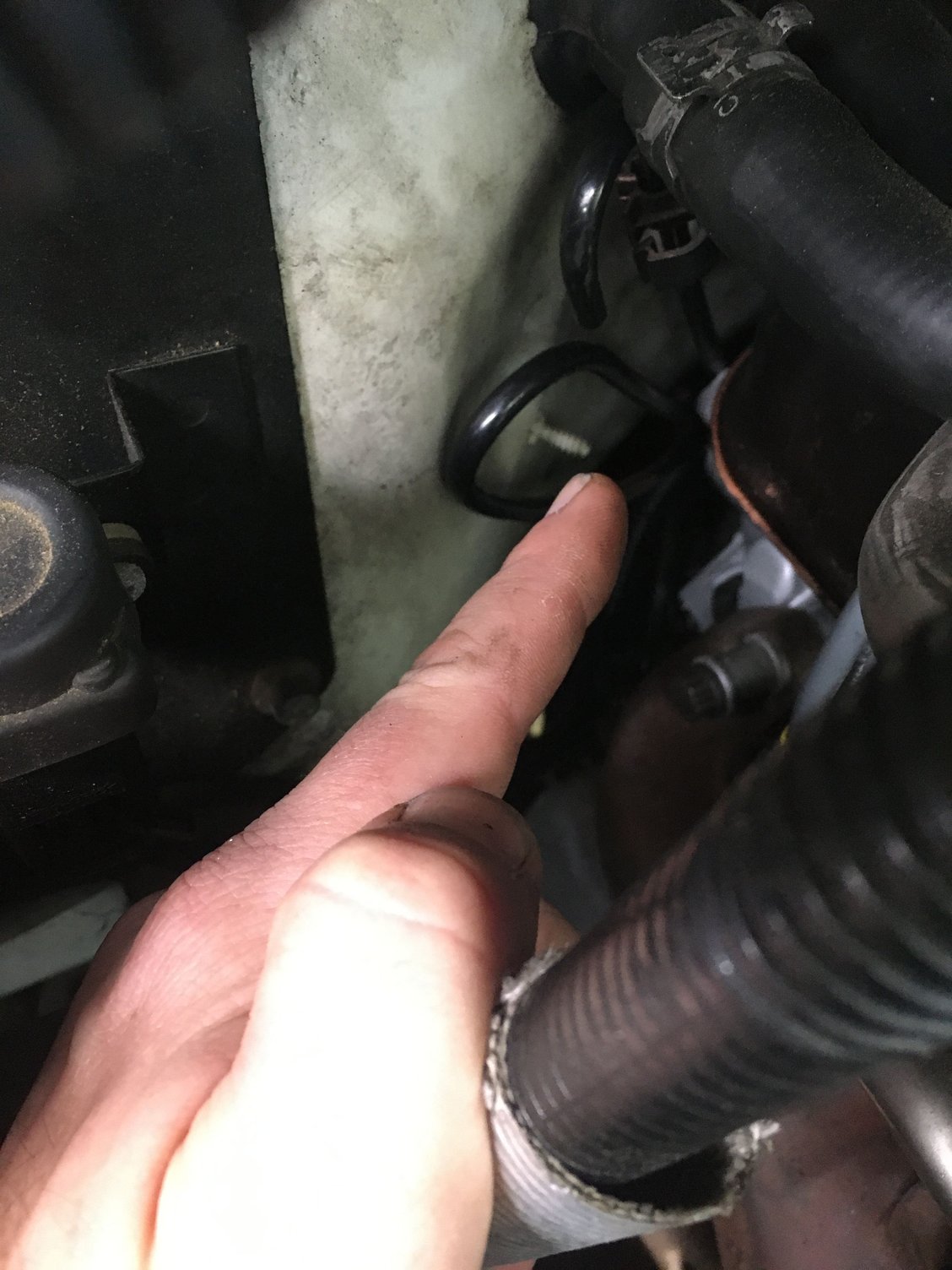

2001 Disco 2 W/ Sec Air
Running into some trouble codes after a full engine rebuild. P1884, P1451, P0414, P0445, P0448, P0102, P0340, P0134, P0154, and the MS flashing Disco party (pun intended). I know that I probably need to replace my battery terminals, they've got an awful connection. I've heard that could be a possible remedy for P1884 and hopefully others. The battery is new and the alternator is charging. It reads 12.87V with the engine off and 14.38V @ idle. I don't know where these go (see photo) and hope this may be my vacuum leak. It's a plastic hose between the bell housing/firewall and the upper plenum. Any help would be much-appreciated guys. Cheers

Aren’t those the breather tubes for the front diff and transfer case?
