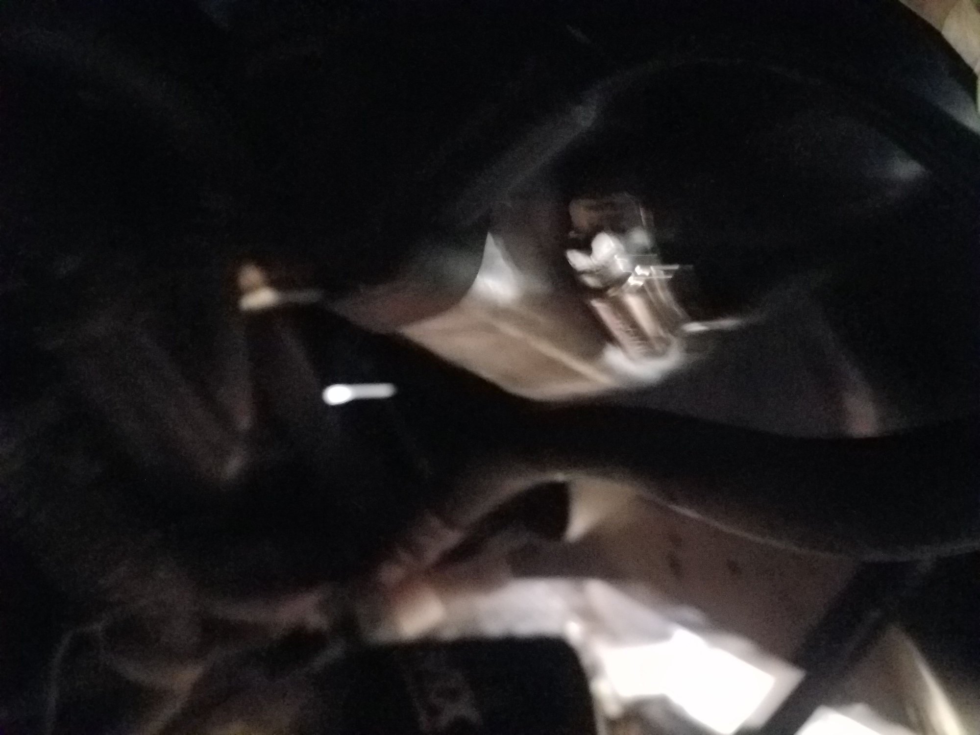

i installed a new block heater for those days she is under the carport rather than in the warm garage.
it is an inline heater that slips into the lower radiator hose warms the coolant and thus the block for cold starts

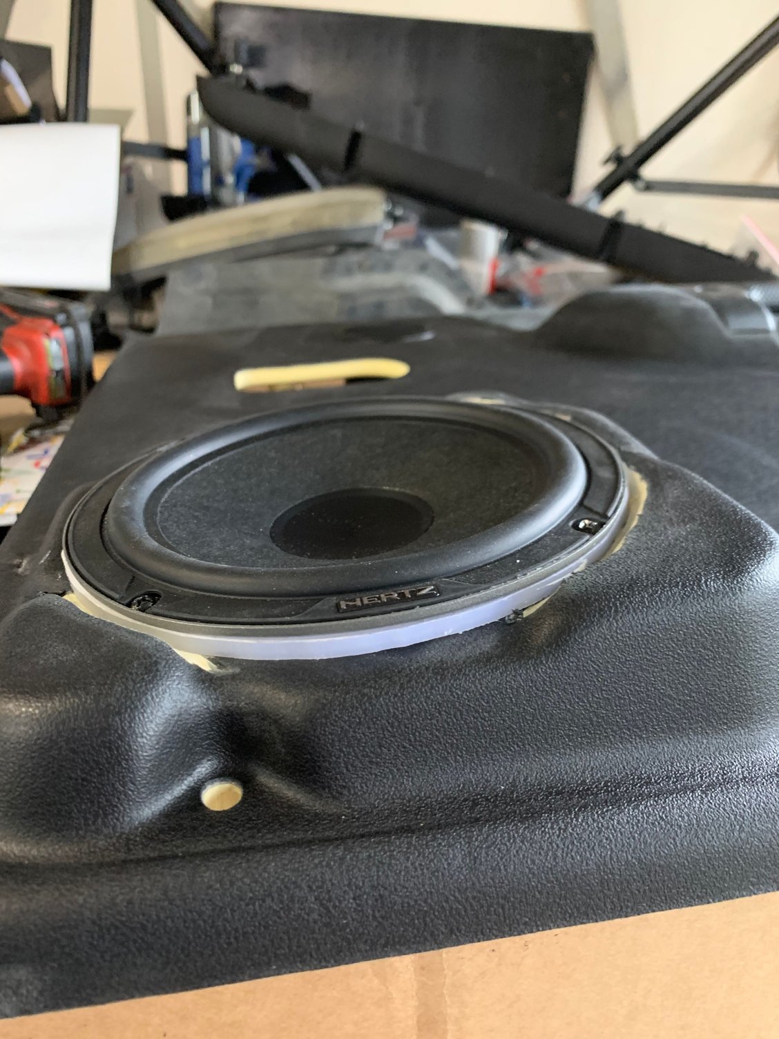

Started my ICE upgrade.
Made some mounting rings from Walmart cutting board

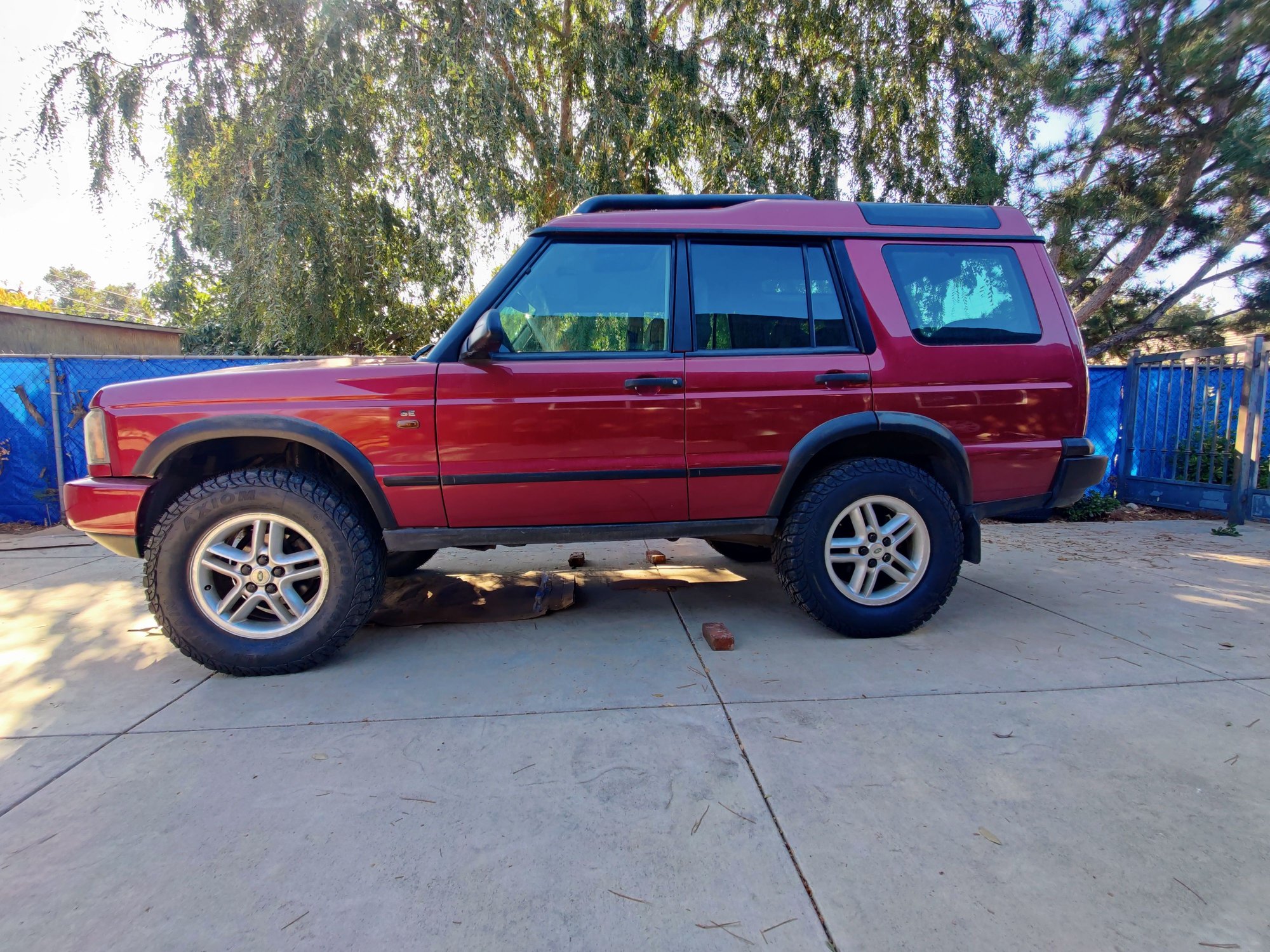

Changed the gear oil in both diffs and the transfer case. At 160K I'm not sure if the rear was ever done by the looks of the gunk that came out and was attached to the drain plug. Probably about half an inch or more sludge attached to the plug...not sure what that is going to lead to later. Front diff was pretty clean but the truck had its front diff replaced by the dealer during its lifetime. The transfer case seemed clean but a little low. Messy but I'm glad it's done!

A fine crown of material on the plug is normal. The ring and pinion are probably the two largest gears in the entire drivetrain...and handle a great deal of stress and pressure...so, wear is inevitable. A fine or somewhat spiky crown of material will appear on plug during change, especially the first. Unless you are seeing chunks or strips of material...nothing to be alarmed about.
Nice looking 04.

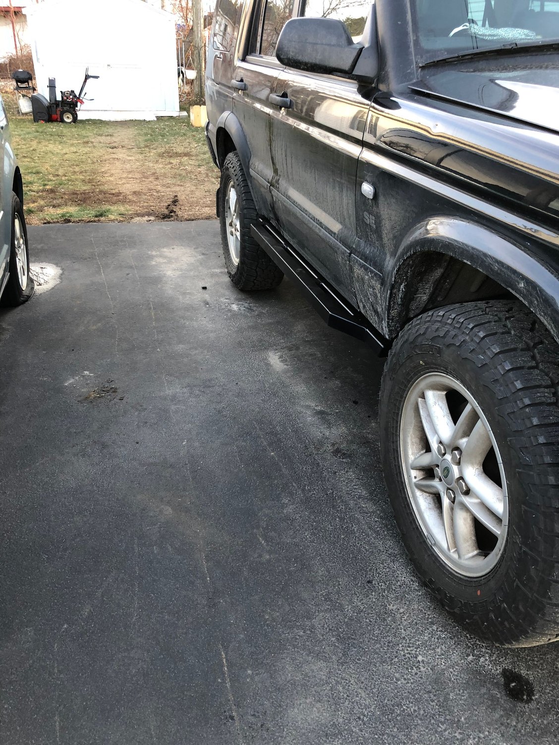

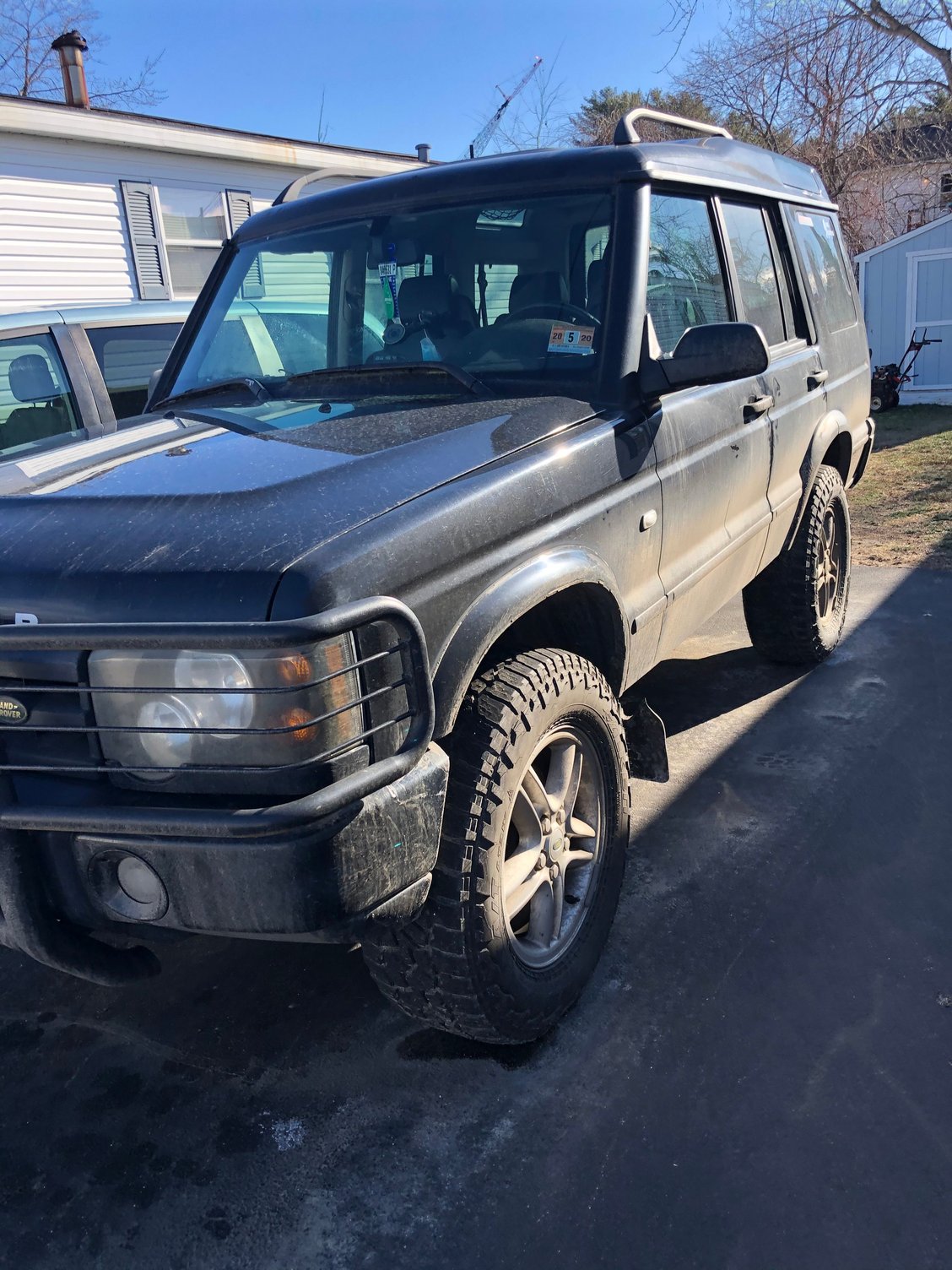

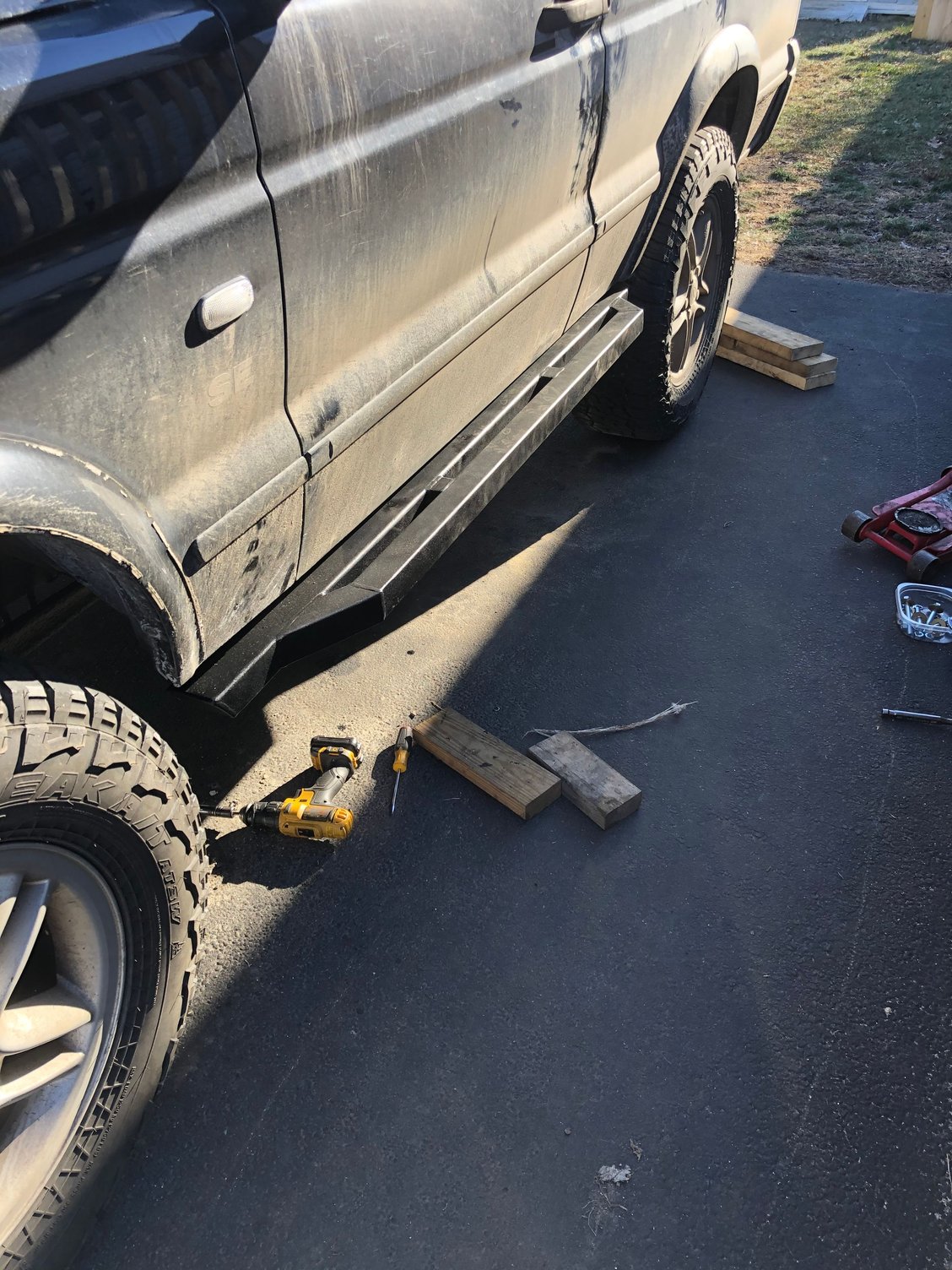

Finally got the sliders/steps done and installed.
overall very happy with them. Not the best time of year doing this in Maine. Will have some adjusting to do in spring when it’s warmer out.
