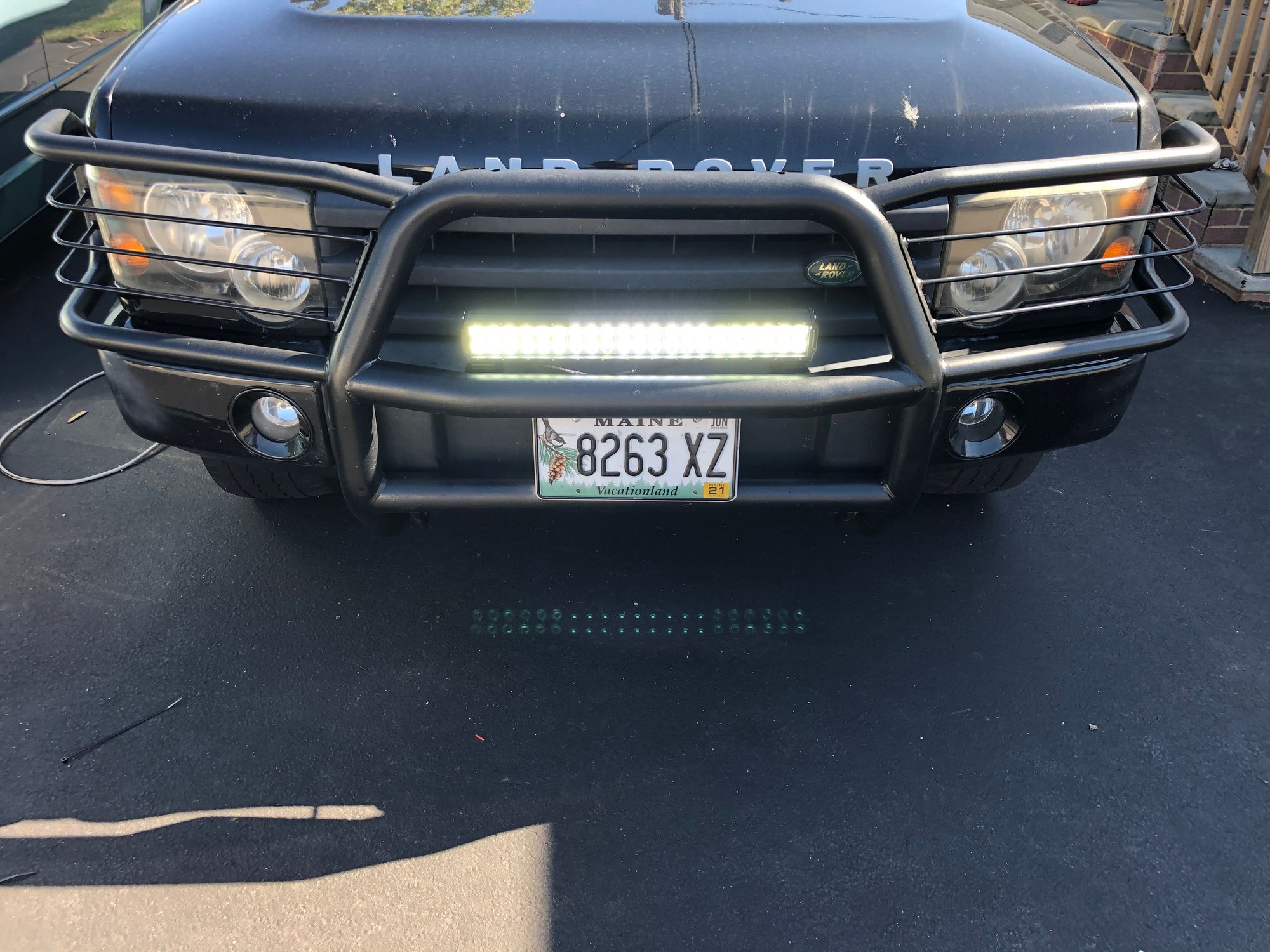

Switch’s, Lights and USB power added today :-)
doing what I can between waiting for things

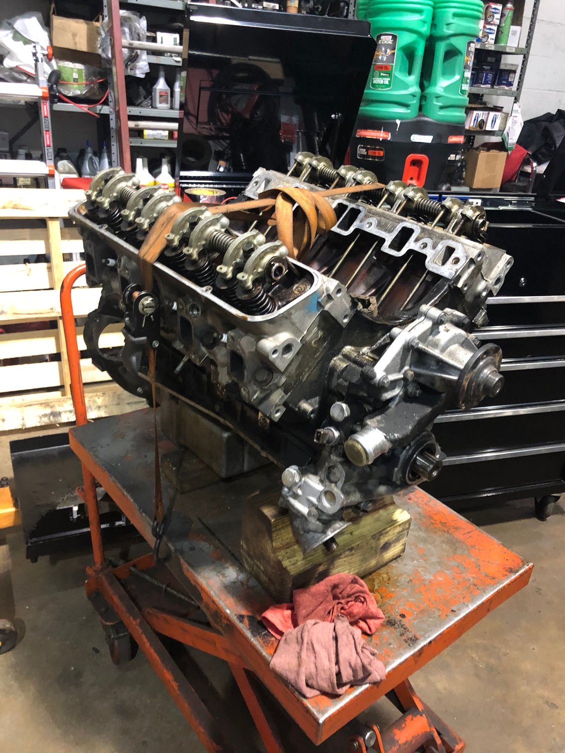

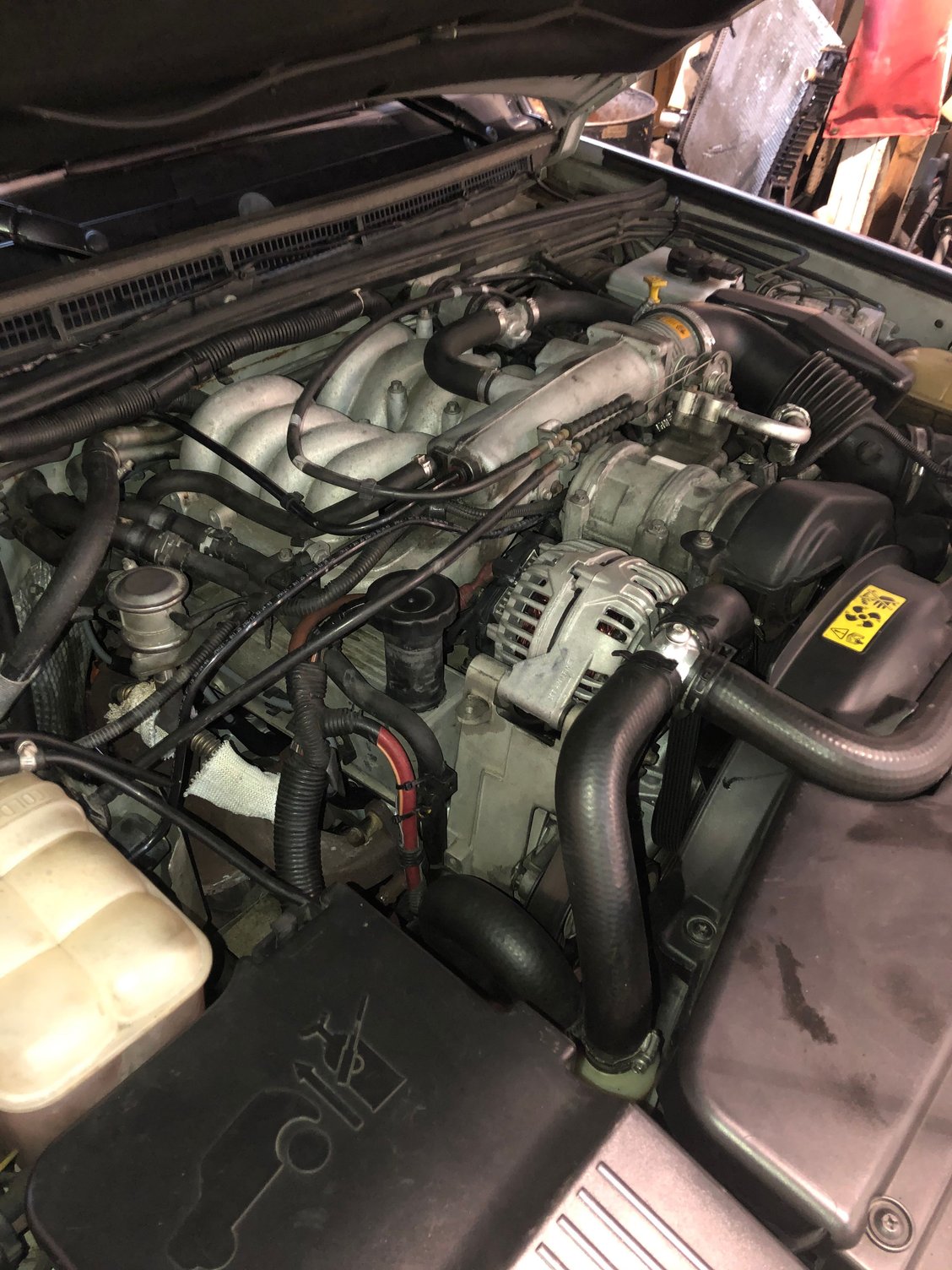

After reading up on Turner Engines, LS conversions, and Atlantic British remanned engines, I made the tough but practical decision to get an Atlantic British long block installed. It's not easy to find reputable shops in the DC area to do anything else out of the ordinary and since its a daily driver I wanted a fairly quick swap. I just got it back from the shop and will take it back on Wednesday for the initial oil change after the first 2-300 mile break in. So far so good
Old engine
New engine (can't see much from the photo but its in there)

4x4Land in Chantilly, Virginia did the work. Lots of good reviews. They have very good knowledge of AB engines (the good and the bad), so they knew which defects to look out for to save all of us time and energy in the long run.
