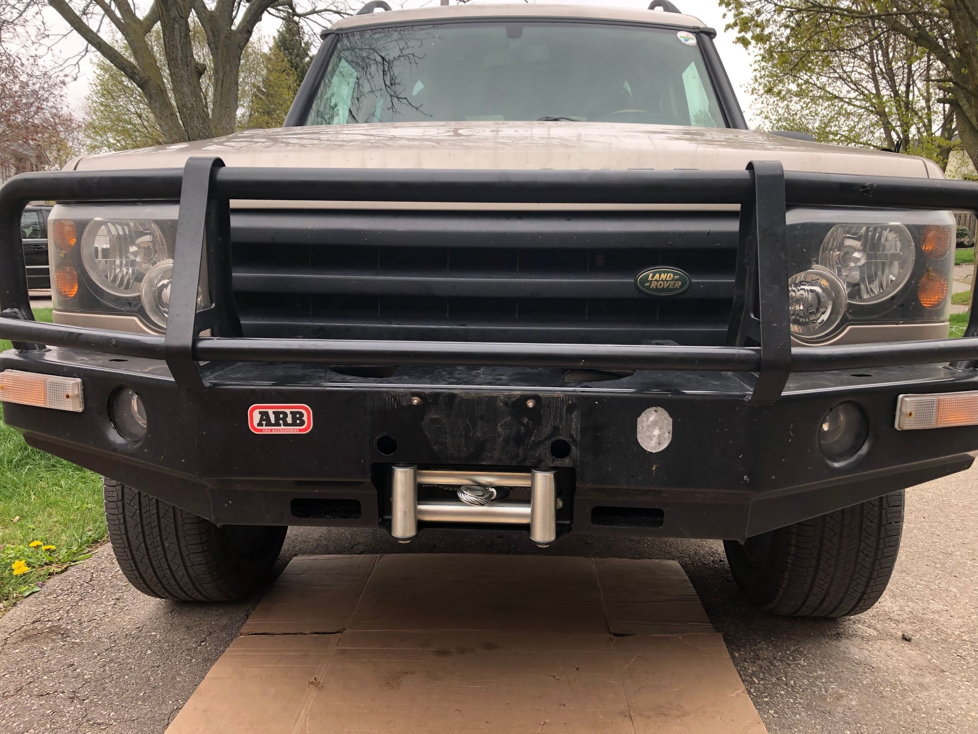

Install my winch

do you know how to remove the headlights with the bumper on I tried and have no room, and also my marker lights on my bumper were mounted on the outside like yours I just moved them to the inside looks sleeker, scroll up a few posts to see
not sure never had to remove them unless they break or something
