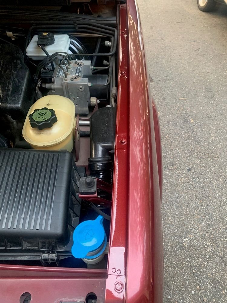

I got tired of looking down the gap between the hood and fenders and seeing bare metal. Scuffed with a red scuffing pad, hit with some etching primer and then blew in some Alveston Red I had custom mixed in an aerosol can at my local body supply store. I am much happier.

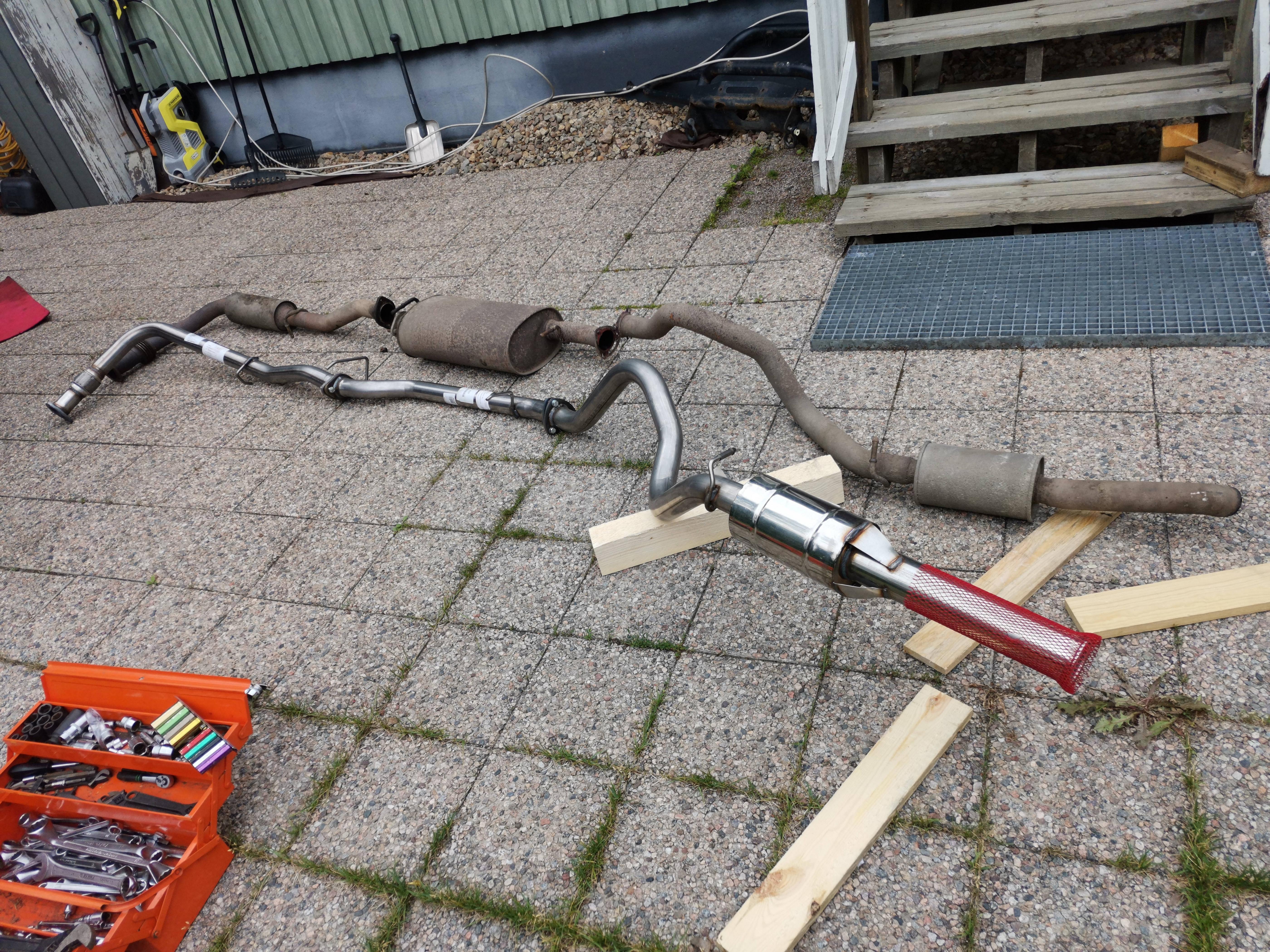

TD5 got a new stainless exhaust.

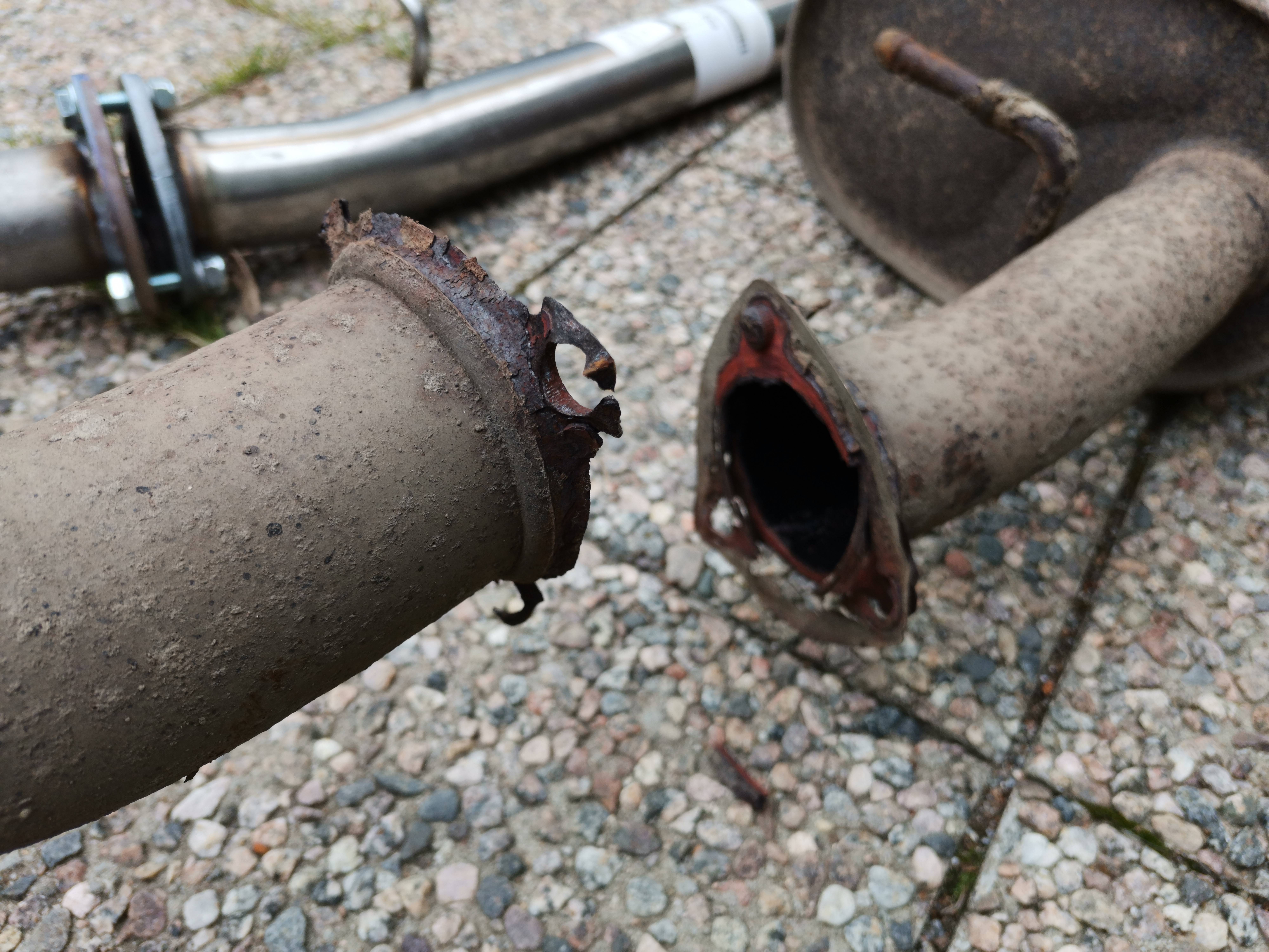

Old exhaust was still in very good condition except the rear to mid pipe flanges and bolts had pretty much disappeared.
Still was not leaking at all.
Also removed the EGR and changed the stock intercooler pipes to silicone. Need to blank off the coolant pipes to the "EGR cooler" and remove it at some point. Blanked the two vacuum lines with a M5 bolt for now.
Next stop, a new tune.
I'm wondering if the stampings on the mufflers "05 02" mean it's manufacture date?
I'm jealous.
With the clear coat having failed on the roof and on the bonnet of my Rioja Red truck, I wish that gap was the only thing that needed paint!
