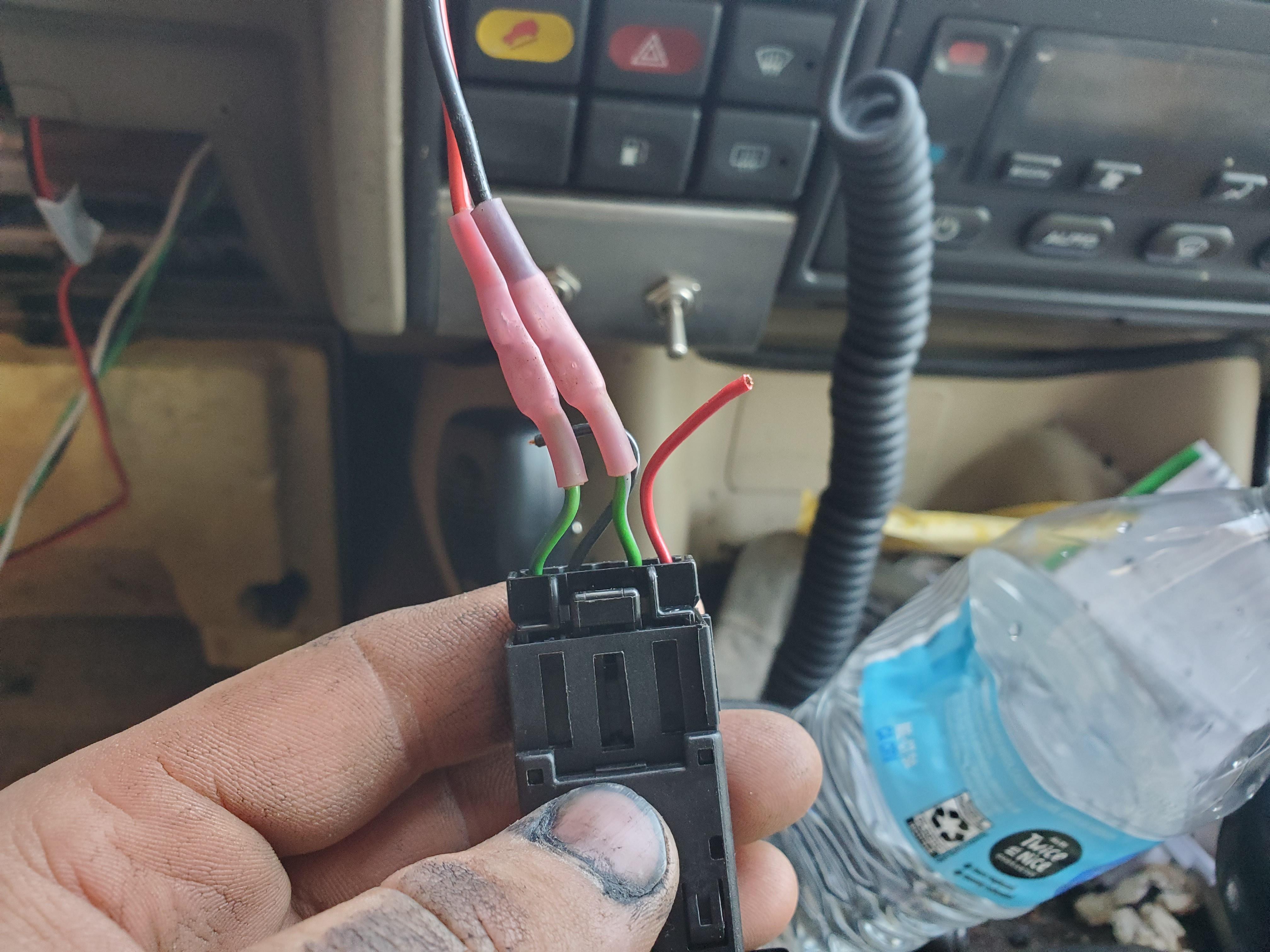

Rear wiper sprayer button starts the truck now... That's interesting........
My central unlock button turns mine off..... 🤣
Spent a bit more time investigating today. Still no dice.
When you find out why, please post. I want this feature. 😁

Oh, I've got a pretty good idea why. Haha
Whole post will be incoming.

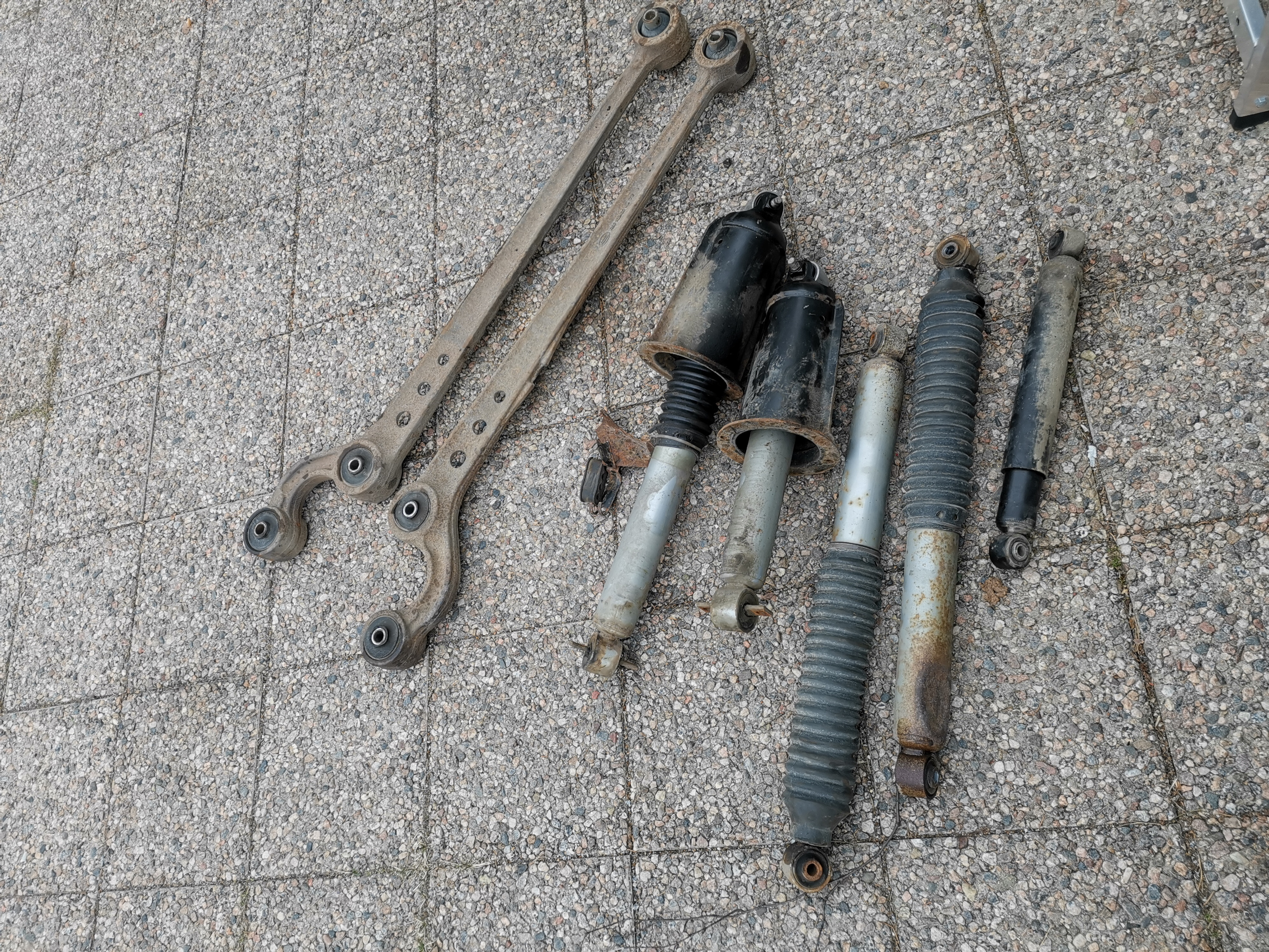

Took a bunch of old, worn, dead parts out and replaced them with some brand spanking new parts.
Steering shock, dead. One front shock, dead. One rear shock, almost dead, it eventually returned after I compressed it. And the rest 2, well, they returned also after compressing, but not too quickly, So a good time for a change.
Put in the Terrafirma TF534 turrets, TF178 and TF179 shocks and a TF837 steering shock.
I do have polybushes for the front and rear shocks, but didn't feel like putting them on.

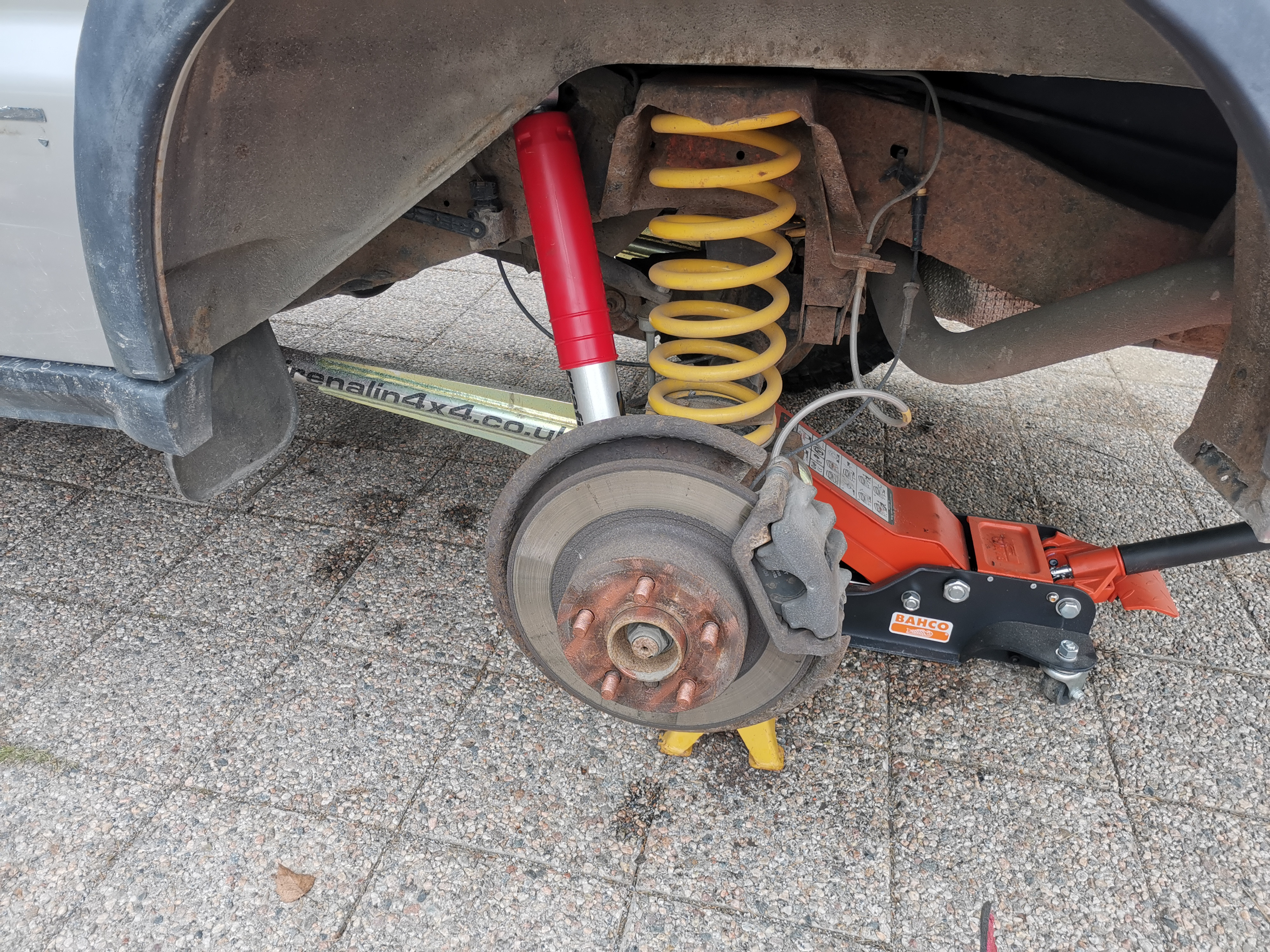

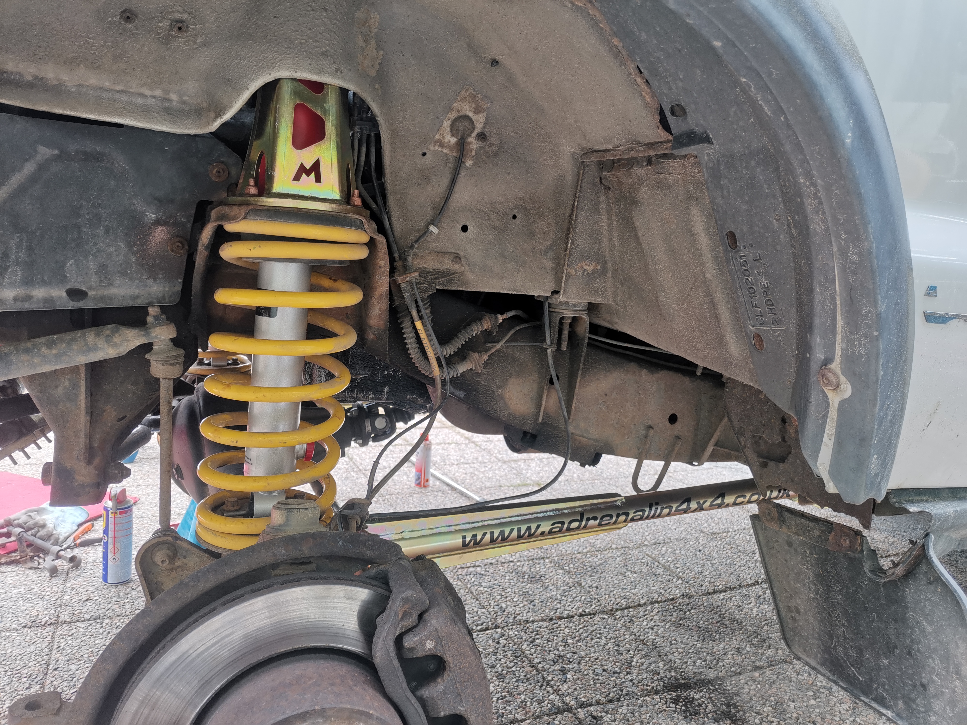

Also changed the front stock trailing arms to the Adrenalin 6 degree corrected ones with flo flex poly bushes. The rears I did a few weeks ago.

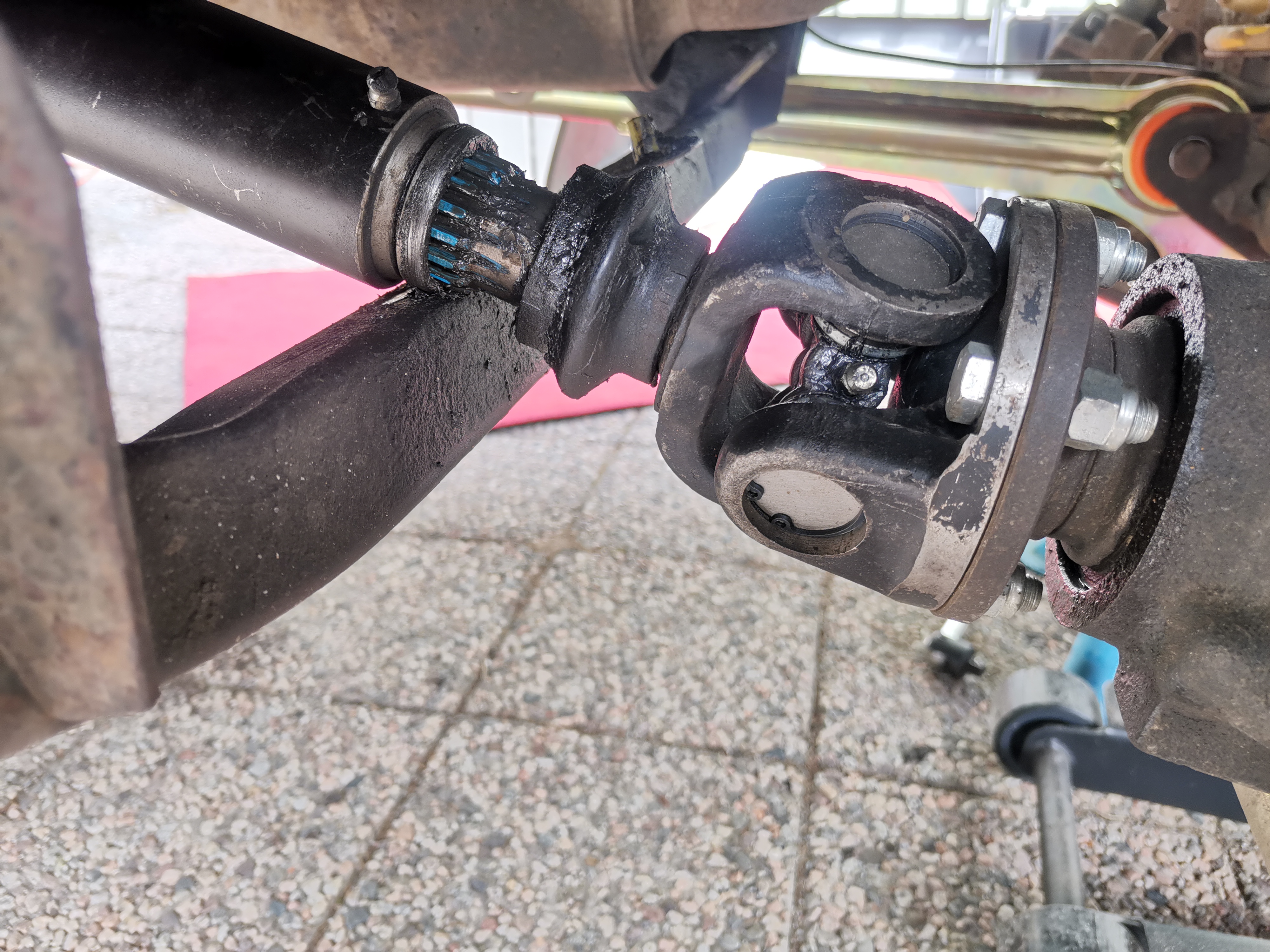

And had to remove the front crossmember as it didn't allow the suspension to flex out at all anymore.
What are the switches in the coin tray / ash tray location?
