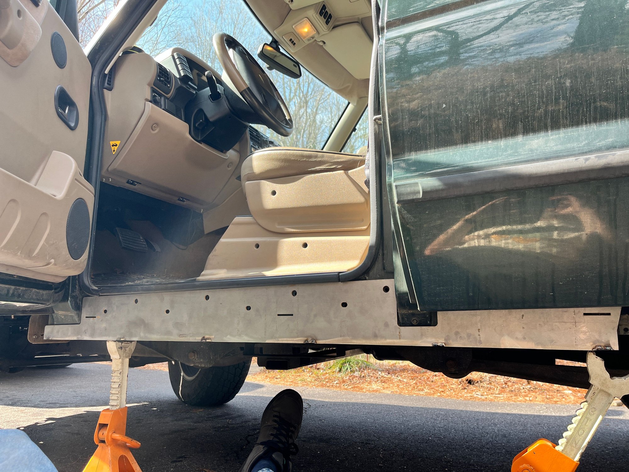

Default Beginning of sliders
Started to mount sliders I designed. Checked alignment of mounting holes with body.

Are you planning on attaching them to the frame? If you wheel often or plan to use them as sliders, mounting them to the body will bend the door sills. If it bends enough, you may not be able to open your door (ask me how I know). Luckily it bends back pretty easily.

Had not really thought about it. I think I've only seen one which attaches to the frame.
I probably have enough square tube to make it happen.

Every slider I've ever had has been mounted to the frame, not the body. Fwiw

You can't buy a frame mounted slider for a disco that I've ever seen. narrow frame rails make it hard to make them strong enough they still won't bend. I bent my frame mounted ones on my classic a few years back..
Wonder how these would fare...?
https:/www.hyenaoverland.com/store/p10/Land_Rover_Discovery_D2%2FD1_Rock_Sliders_Side_Ste ps_STEEL_OR_ALUMINIUM.html#/
