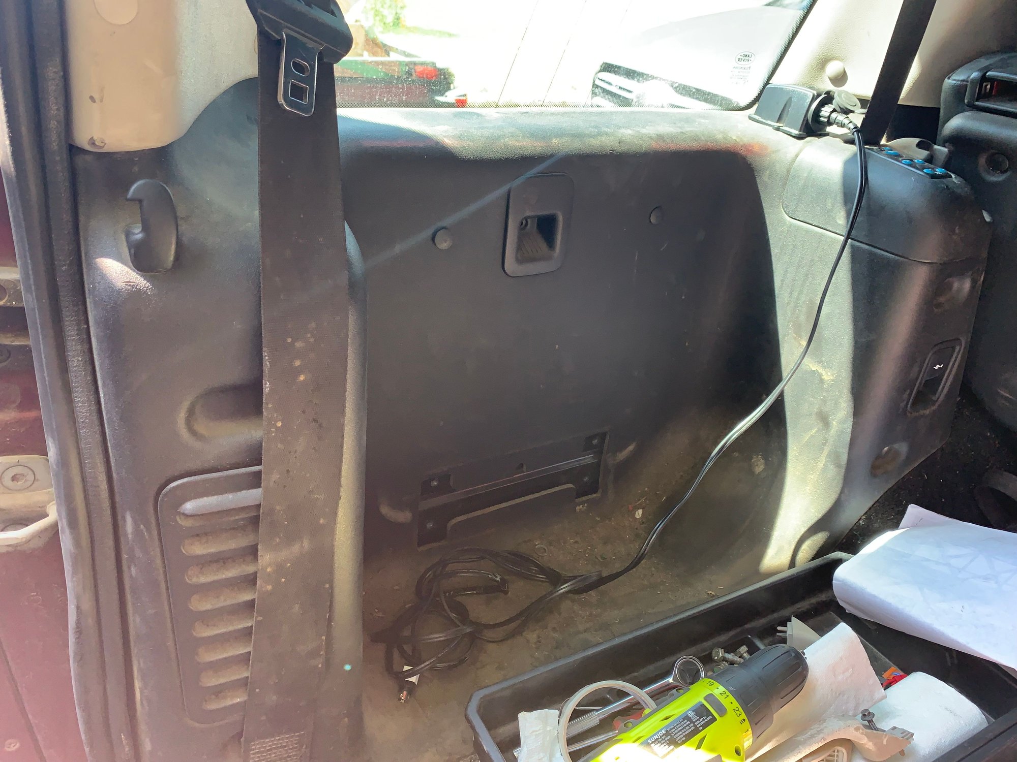

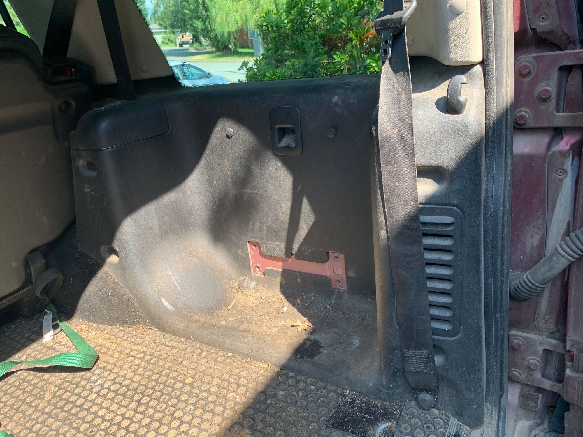

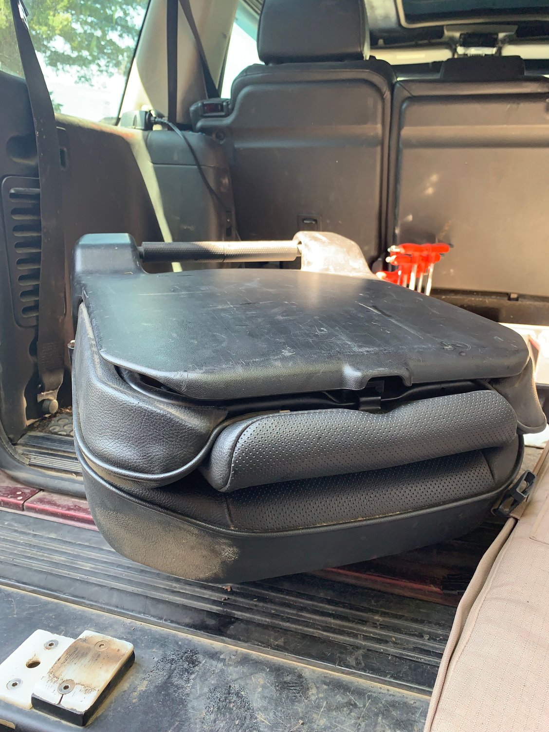

The third row seats have outlive their usefulness. They were great for hauling my kids when they were young. My 3 boys are over 6 feet. Removed the third row seats. These seats are heavy. I think I raised my rear ride height by a 1/2". The newfound cubby storage area works great for storing the Scepter water can and my ArkPak..
Installed the rear upper shelf.

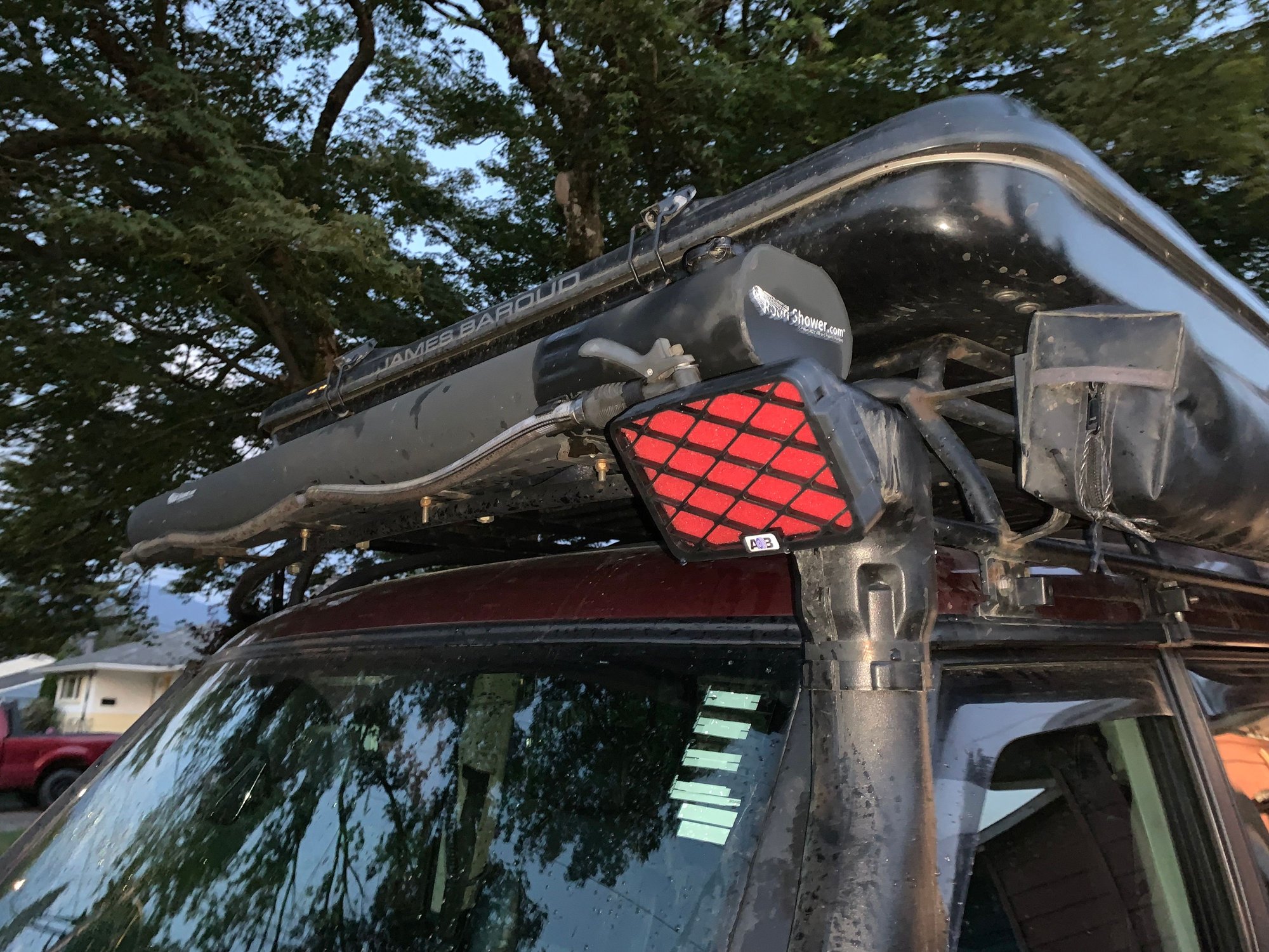

Installed a pre-cleaner filter for my snorkel.

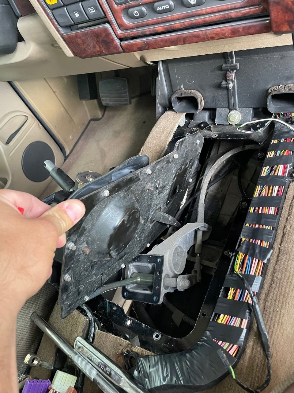

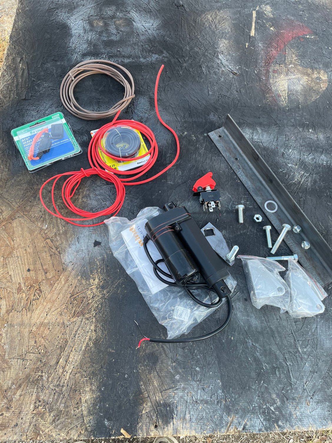

Started working on the electric CDL today. I was going to tackle it over the weekend but I got a text from one of the local U-pull-it yards saying they got a 2002 Disco 2 in. I had to hurry over and rob the door lock actuators I needed to get the locks working. Any way, pulling the center console out is a biznitch. I got the brackets fabbed up and the cdl tested and that's as far as my patience would allow me to go. I'll get it buttoned up in the morning. Here was my inspiration. https://landroverforums.com/forum/di...nic-cdl-95757/
