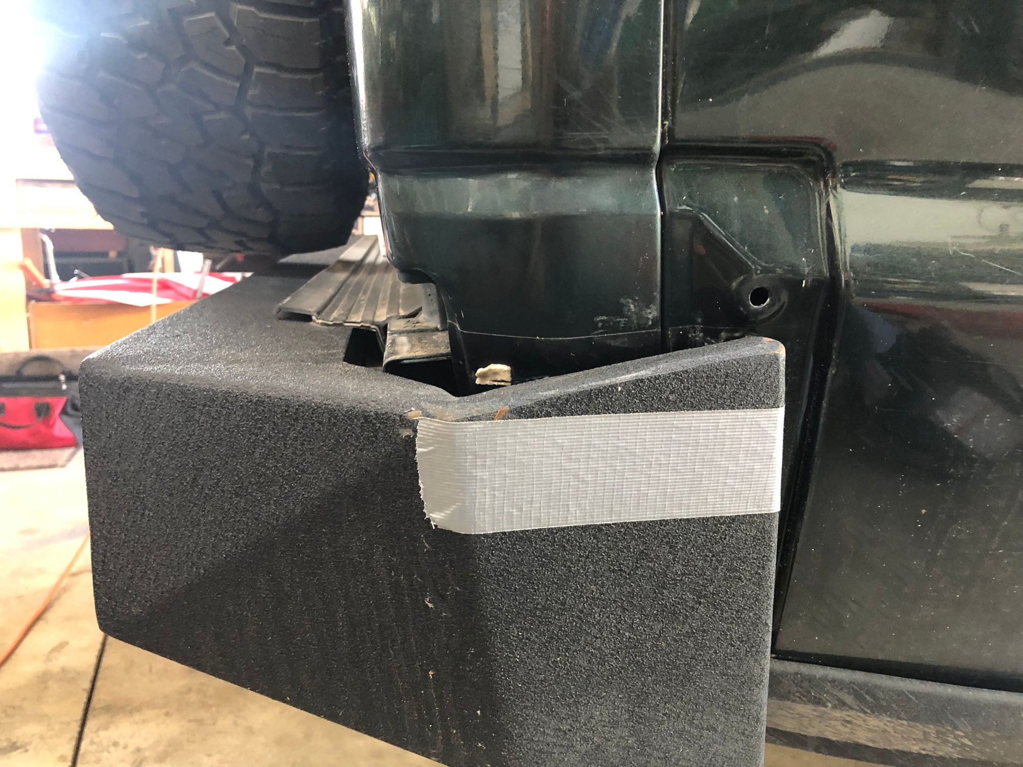

Cracked my second rear bumper, went with low price eBay metal option. Looks pretty decent quality, little end caps took some trimming to fit right
Well huggi, you inspired me to fix my bumper. I put it on last year and have just lived with it like it was, ugly without the trim caps. I got busy and took care of it. Much better. I cut a pie shaped piece out, hammered down the top and welded it back up. Primer and some bed liner and we're back together correctly.

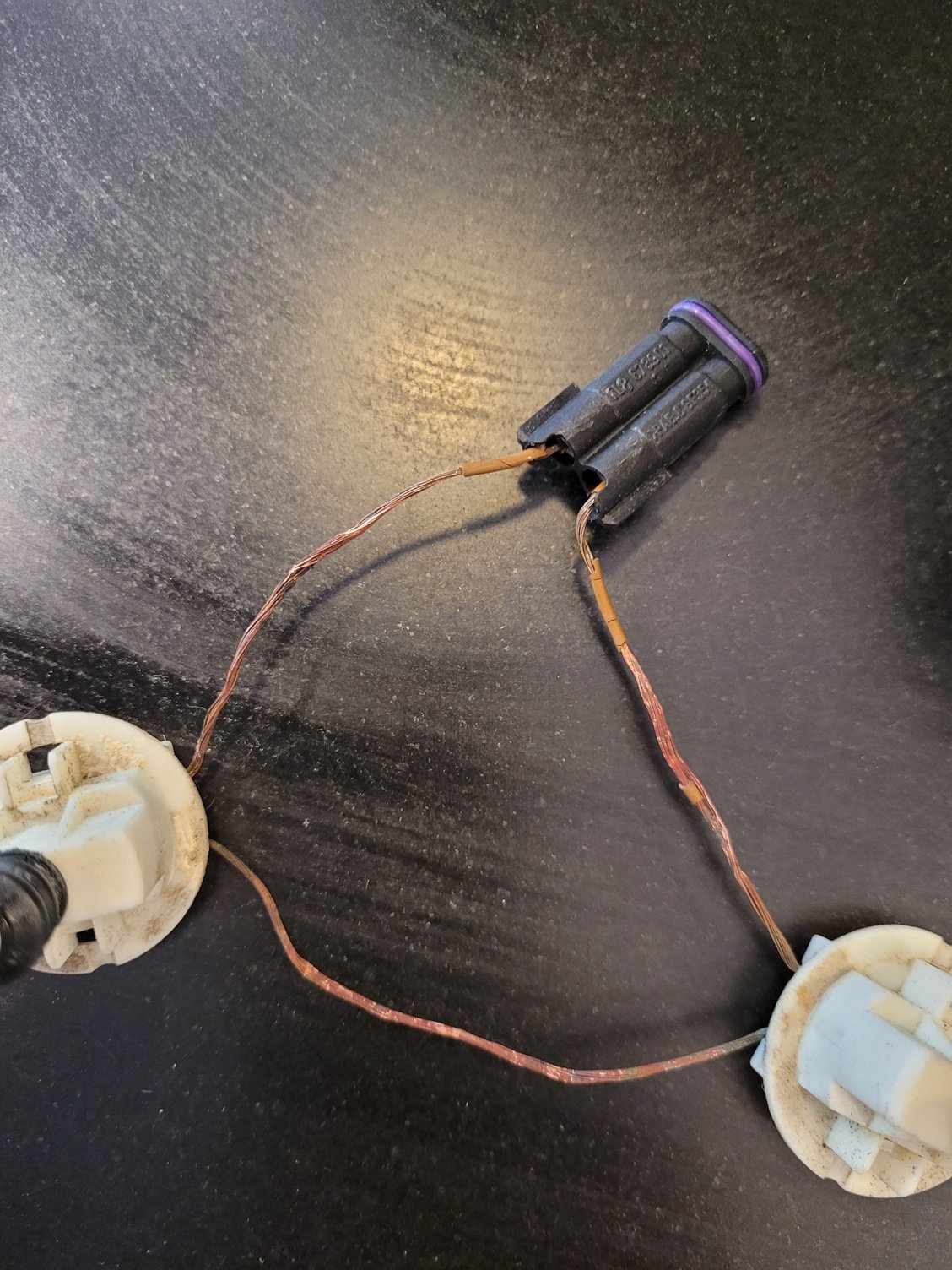

I tackled my Three Amigos, again apparently. I swore I had done the Option B previously, but was still getting the fault very intermittently. I dug into it today and found the weirdest situation. There a circle connector that I used to ground the shuttle valve in previous vehicles, it was there, but no wire was connected. When I pulled back the wiring loom the yellow wire was cut and spliced back together with a butt connector. The shuttle valve itself was intact. But there was literally zero insulation on the wires. bizarre that I did not have the three amigos all the time. I wrapped it up and performed the option b and will will see how it goes. I may just need to buy a new valve.
Most bizarre experience, almost like someone replaced my shuttle valve with out me knowing. I cannot imagine un-doing the option b on purpose.

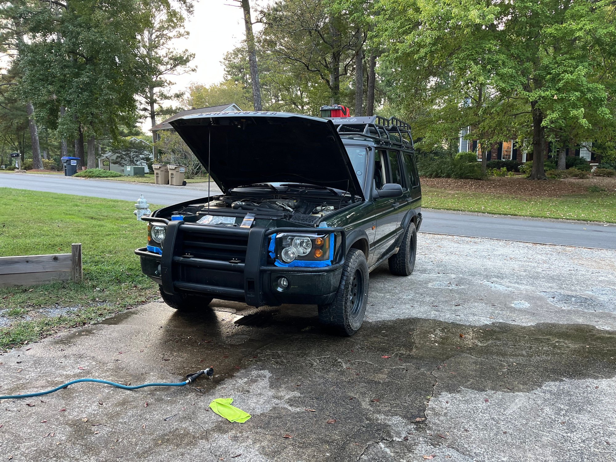

Default Headlight restored
I restored my headlights today. Looks much better. I also took off the oem front spotlights, I have one in good condition for free if anyone wants it.
