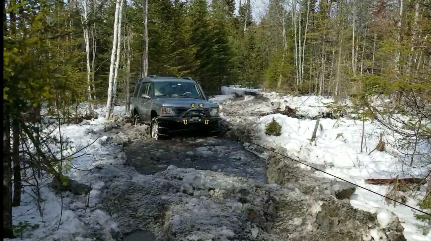

Went to Winter Romp in Maine. Only broken part was the front passenger ABS sensor wire snagged by a tire chain. Had a great time and met many fellow Rover enthusiasts.

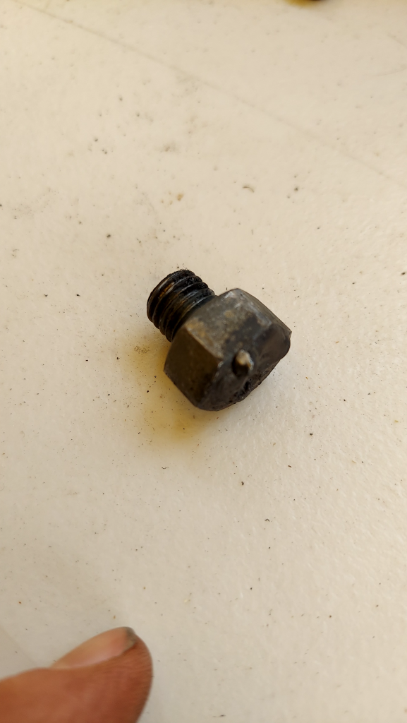

Yesterday was fluids day, checking and toping off. Installed the short steering stops. One broke off so I got to held a nut on and slowly work it out (4 attemps, it broke welds, last weld I built up a noband welded the nut to the extra bit). The good part i the short tops while making a slight smaller turning circle makea big different in getting around. No longer need to do 3 point turn to get out of driveway.

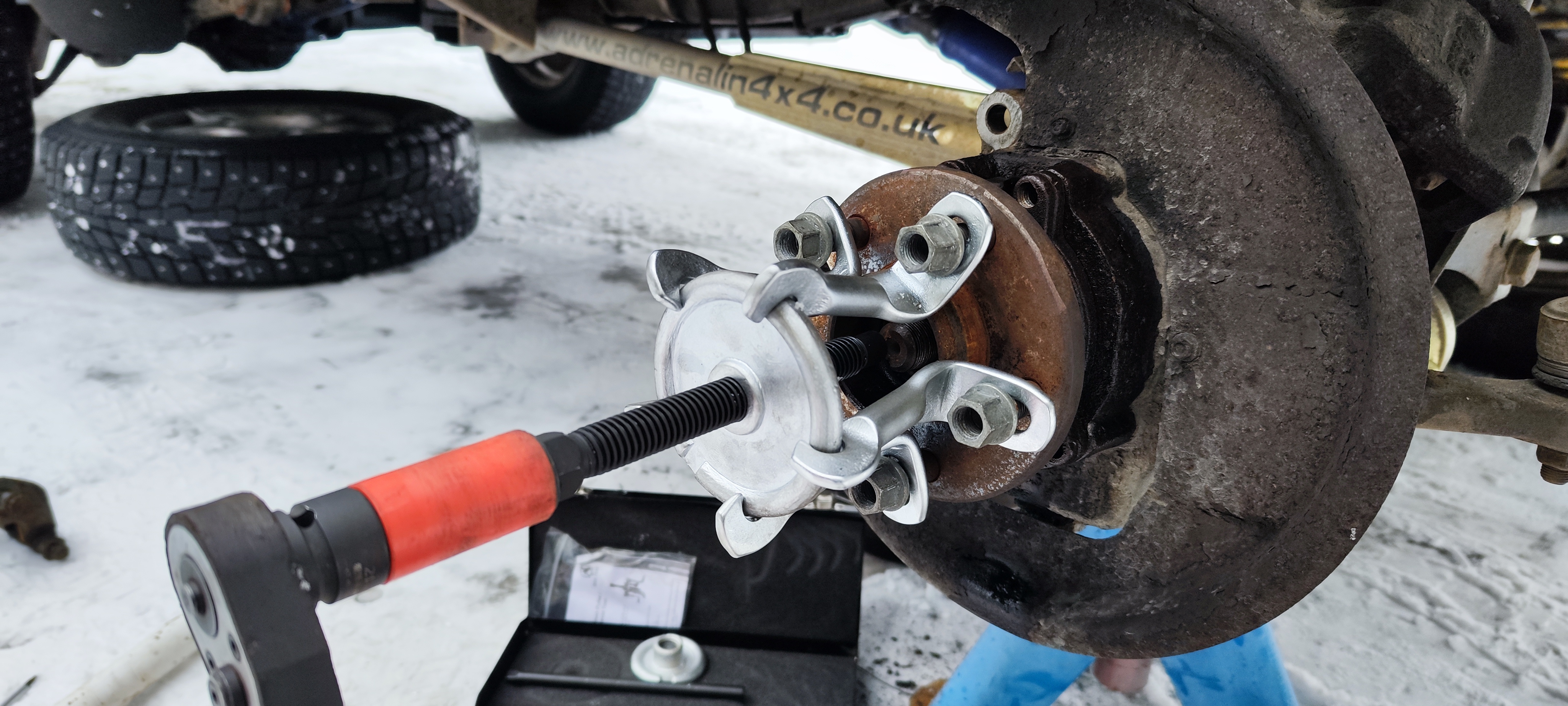

TD5 got a new front wheel hub.
A bit tricky locations for a few bolts holding the hub in, but finally managed.
it took ~1h 45min, it was snowing and -3 celcius.
Had to use some pipe and a jack to loosen up most of the bolts as no proper room for a impact gun even with swivels etc.
Hub itself came out easily after some pre removal hammering was involved with plenty of WD40 and a proper puller.

Puller legs didn't seat properly on a D2 hub, as the oval holes on the legs are narrower on one end than other.
Just need to source a new hub nut as forgot to order it and did not come with the hub.
