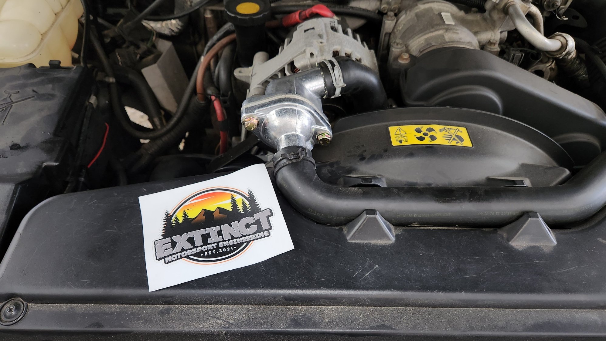

Got the in line thermostat in a customer's rig yesterday. Was my first time installing Extinct's kit, been cobbling my own together for years. Super simple.
Also was tracking down an issue with the drivers window not working. Tested the motor directly, replaced the switch - had concerns about the BCU for a moment, but finally traced it down to both window motors were broken inside the flex boot in the door jam. No other wires were broken. Wild.

Did you go with the paper gaskets or re-useable silicon gasket? Planning to order mine soon and can't decide which is best

Hey! I didn't get a sticker when I ordered mine!

Absolutely go with the silicone gasket. I did a ton of research and lots of people had problems with the paper gaskets. Also, if you need to remove your t-stat on the road for some reason, you can do so with the silicone but not the paper.
