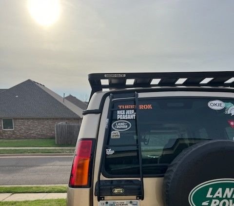

I installed a "widdle wadder" to Clarkson. I used rivet nuts instead of the silly screws they send. I've already used it to get up and down off the roof several times yesterday,. its a needed addition to this build.
