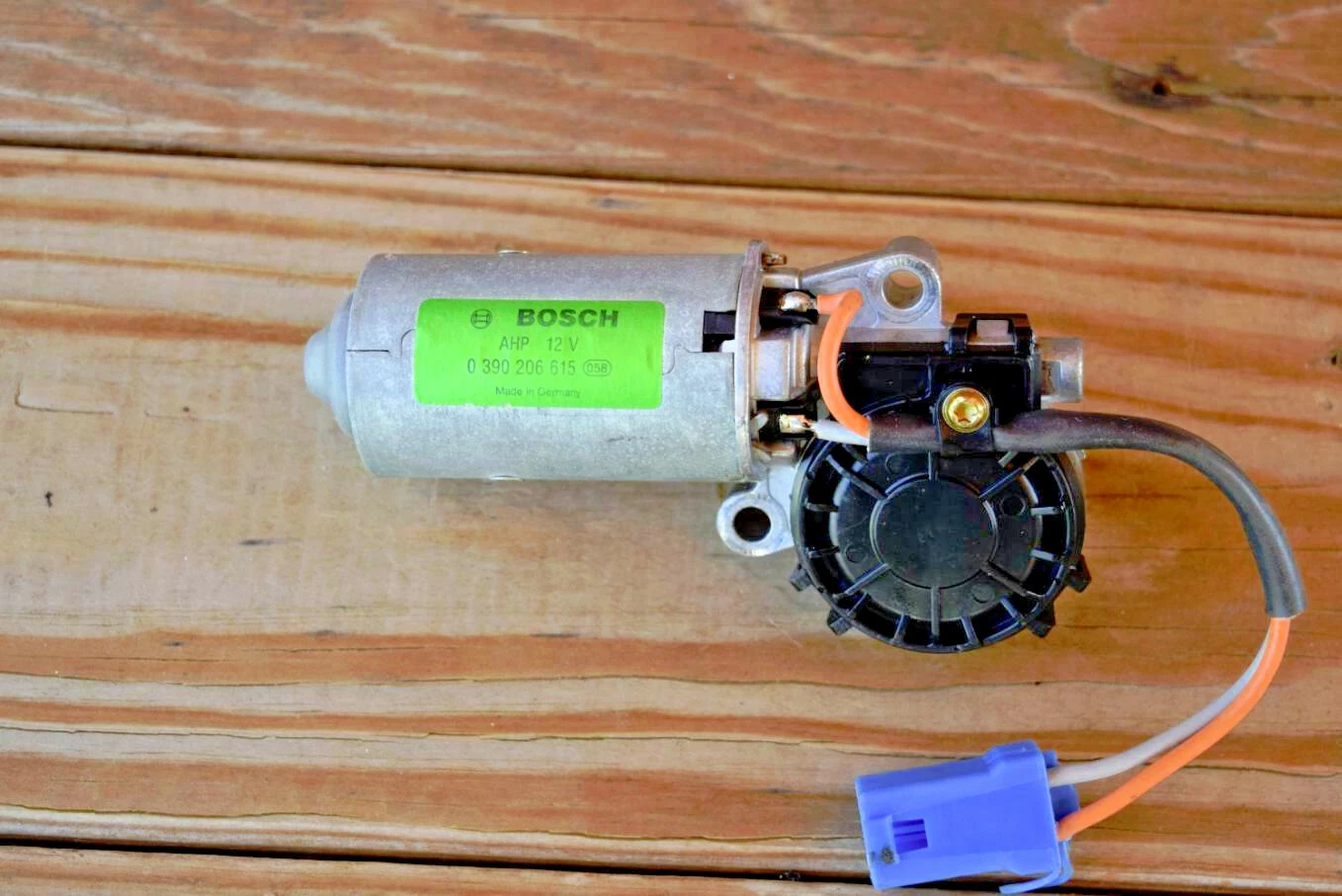

I found this motor on ebay, Do I need 2 of them?
99 00 01 02 03 04 Land Rover Discovery 2 Power Seat Tilt Motor Upper Lumbar 2004
https://i.ebayimg.com/images/g/-nkAA...7/s-l1600.webp
Also, can I just hunt down a driver seat and use the pump and lumbar bag from it to put in the passenger seat? Thanks...

@Bignacio You can't just add the motors. It needs the mechanics for moving the seat up and down, which is missing on seat bases without height adjustment.
For the lumbar bladder and pump I would think they are identical between left and right seats.

Ohhh ok, are there any part numbers for these mechanics that move the seat up and down? I could then add them to my seat base. Do you have any pics? Thanks for the info.

You're going to be better off buying the entire seat base with motors from one of the breakers on the west coast. Check FB marketplace. As far as the pump replacement I have the electric Volvo solution next on my kit development list but unlikely it would get finished before the end of the year. The bracket would need a lot of development work, someone would need to account for the increased width of the pump as well as the pulley backspacing - not even sure it can be done in thespace available, I dropped the project once I realized it was going to cost more than the value brought to the customer.

@Bignacio You could add the mechanics, but it is way easier to replace the seat base completely. I got mine including motors and harness for about $100 from ebay.
