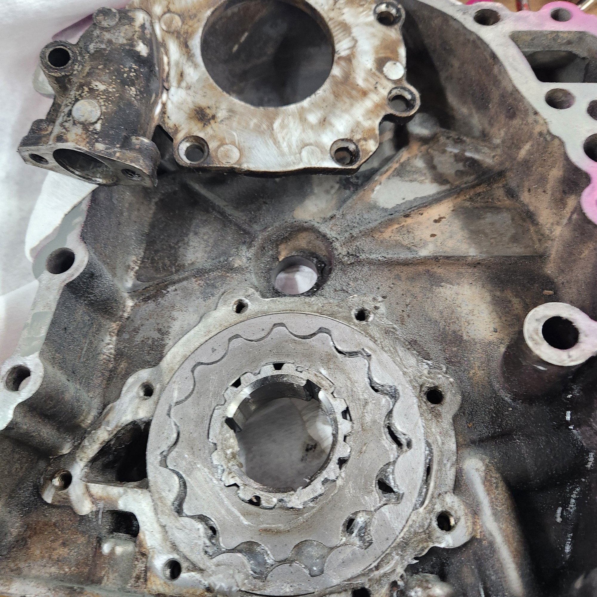

Top end mostly finished, started on oil pump and timing chain.
I literally have a brake pad box full of sludge scraped from bottom of oil pan. A preliminary dig through I do not see metal shavings. There was not any sludge under valve cover, so I don't think it was too badly neglected.
Soaking front cover in degreaser tonight. I know I ordered the timing chain but can't find it.

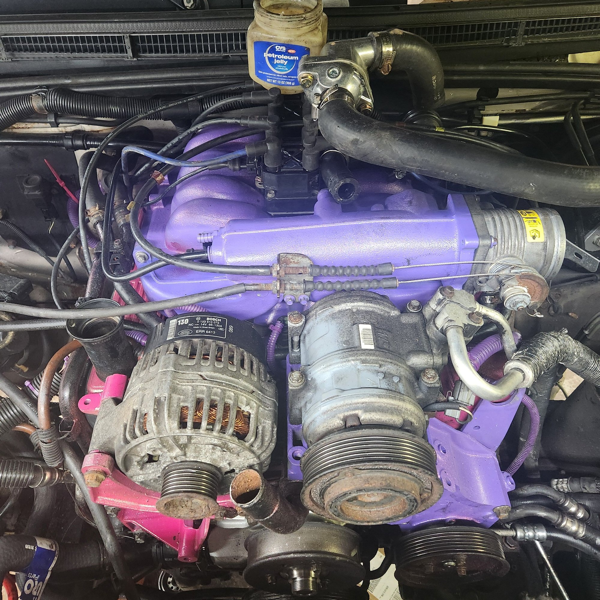

This is where I left it tonight. Still need to figure out how to make the intake hose and the relocated coils be friends.
Got oil pump on. Replaced gasket at top of oil filter housing. Flushed out oil cooler hoses and blew out with compressed air, but didn't look like any restrictions.
Need to torque crank bolt and finish finding connectors and their partners.
Then last will be finishing up cooling hoses and pipes. Have to discuss with the daughters if we are painting any of the plastics: airbox, fan shroud. They're not pleased that the alternator and compressor covered their art.

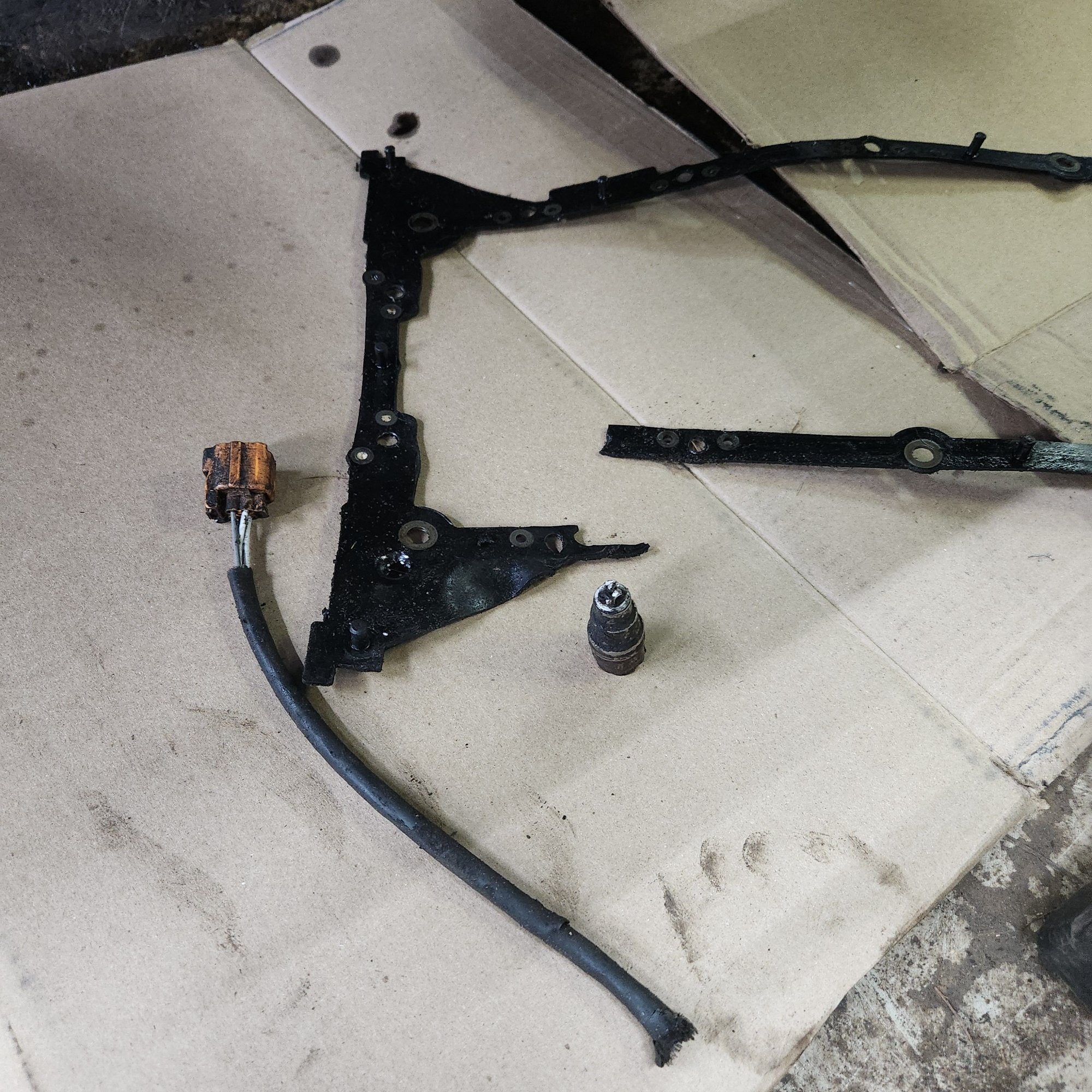

Oil pan gasket was worn thin and fell apart in places, explains the leaks! Also had to chop up the sassy O2 sensor to get it out haha
New oil pump. Thanks to those who shared their experiences and tips for this!
