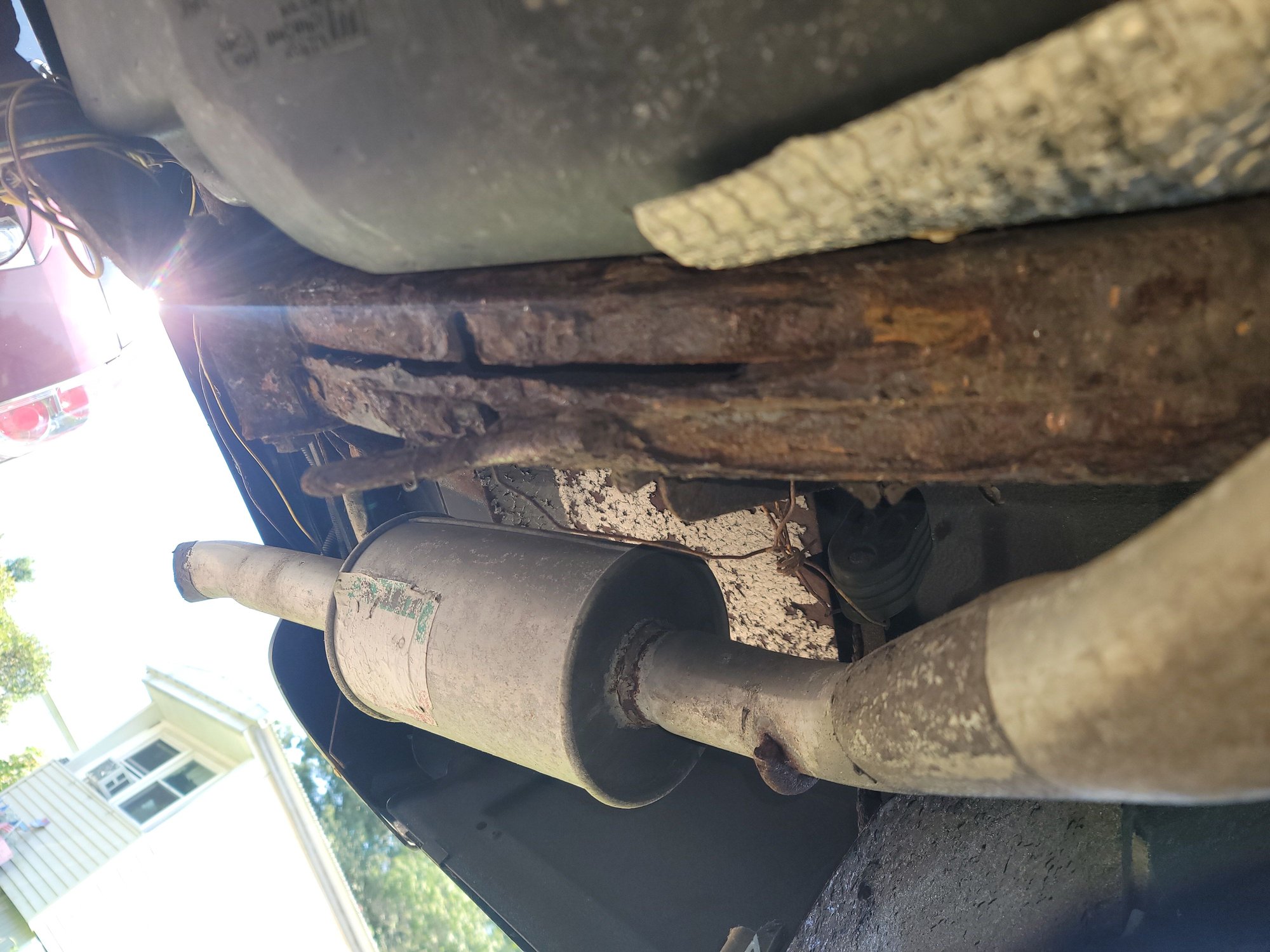

Went to have it pre looked at for inspection for MA State inspection. Tires are still good enough for passing but should be replaced. Everything else is good he said except Rear quarter chassis needs attention. It looked like alot of surface rust was present and was planning to spray some stop rust that I used every year prior to 2019 but has been neglected as I wasn't driving is another family member was who doesn't do maintenance unfortunately. Not sure if this will be a repair or a replacement. Will need professional eyes on this. Here is a shot of the drivers rear. The passenger side is about the same. But if anyone wants to comment on repairing as is without full 1/4 replacement and any video links or ohotos with materials used and process feel free. I just renewed the registration so I can drive it to get repaired.
Driver side rear chassis after removing majority of loose rust.

@PD2004USSalty I would replace, as to how much that is tough. You can take a nails set and hammer, Put the nail set against the frame in various area's and give it good whack. One of 3 things will happen
  • A slight dimple - this is the only ok situation
  • A dimple and the sound of debris falling inside
  • The nail set goes right through the metal
That will give you an idea how the rest of the frame is

I just had the same thing a year ago but had a good roller frame. I took it to Cityside Garage in Bellingham, MA. Cost of actual labor was about $4k from memory but, as always, stuff breaks and parts are worn so it quickly escalates over that! That said, Cityside was great and fluid filmed the whole underside of the body and the whole frame, axles, etc. Looks almost like new under there….

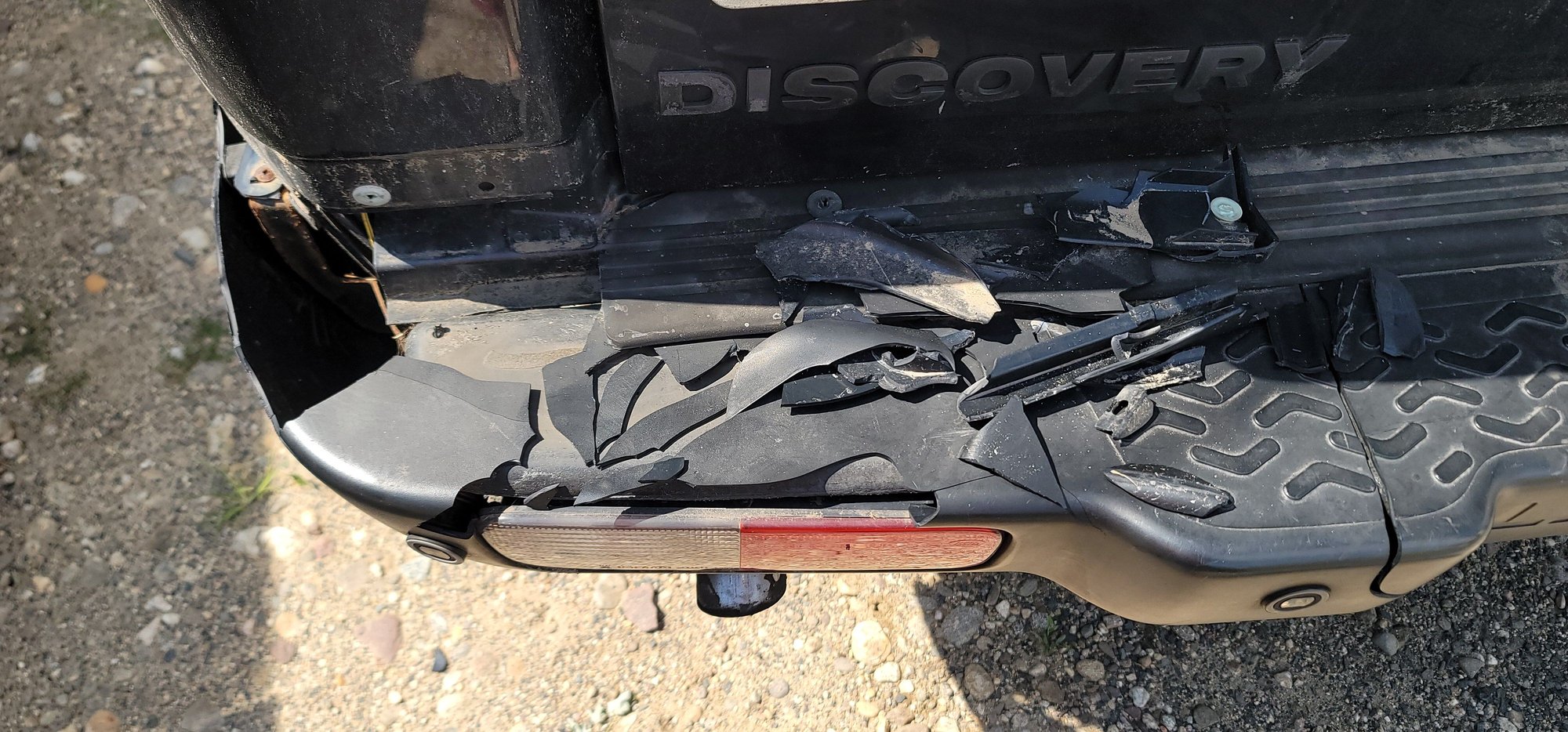

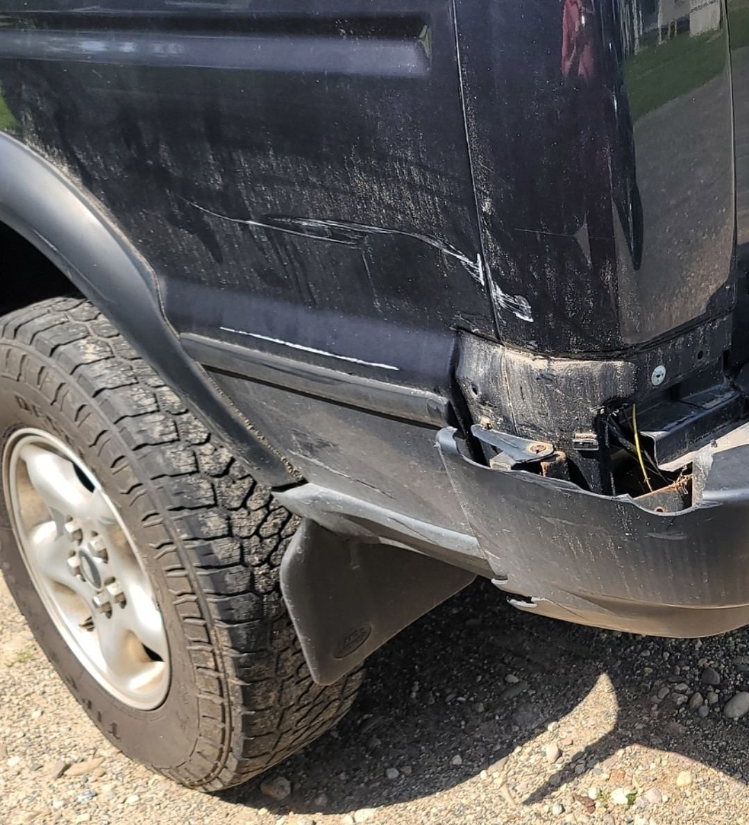

04 Disco hse was parked until i can get plating or 1/4 chassis. But someone hit it last night and left me a note. So today was pictures day.
Rear damage 1/4 panel and corner trim and bumper cover.
Rear bumper damage
