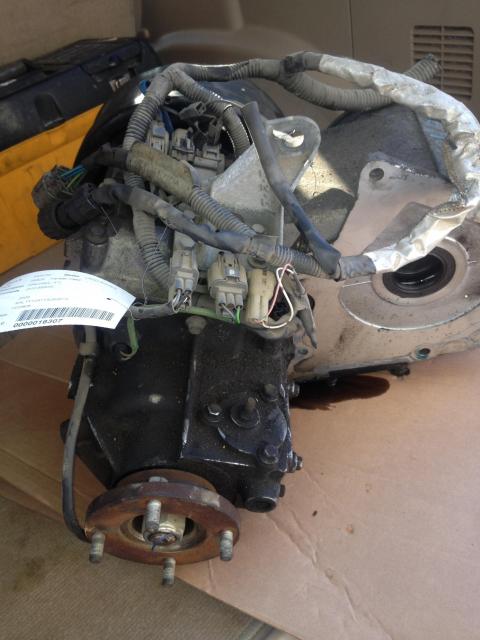

Well, cdl it is. $150 after core charge refund. Its out of a 2000 with 77k miles on it. So half the miles I have on my stock one. What seals and gaskets should I change on it while its out on the bench?

Depends on how in-depth you want to go. GASKET SET LT230 TRANSFER BOX RRC, DEF, RTC3890,RND459, PLD459 - Rovers North - Classic Land Rover Parts
is the whole kit
