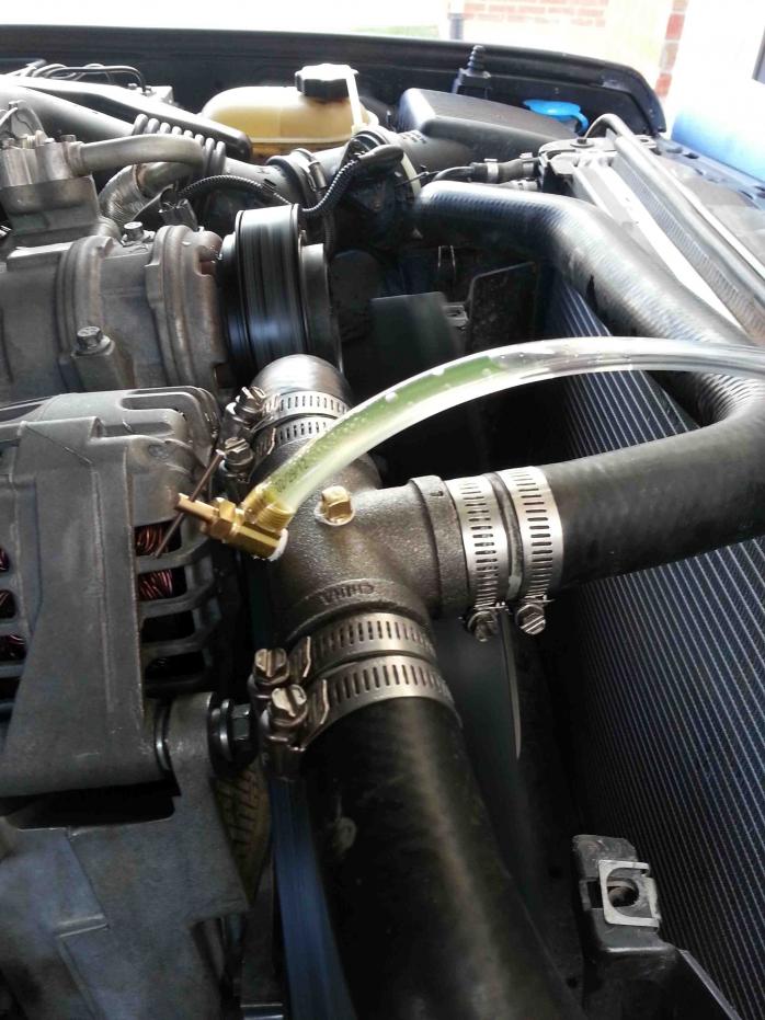

The 180 thermos for the Discos (petrol) have become quite popular recently on this forum. One vendor makes them in a gray color, another in the cream/white color. I'd say if the thermostat looks like it has been there for a year it is unlikely to be a 180. You could remove and boil it, you could watch heat temps with a scanner or Ultra Gauge, etc. But a new thermostat might be the way to go. Justin at Lucky 8 can make sure you get the right one. And there is this fix for bleed screws.... note the string of bubbles in the drain tube, which goes to a bucket and not all over the garage floor. There will be more than one or two bubbles.

I like that set up. I've seen it on here before. So are you selling them yet
Looks like I'm going by the LR shop today. LR is $119 where Atlantic British is $100 plus $10 dollars shipping and about 4-5 days wait time. Don't like either answer but it is what it is.
