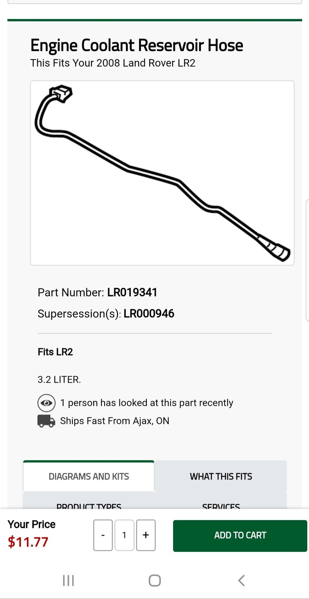

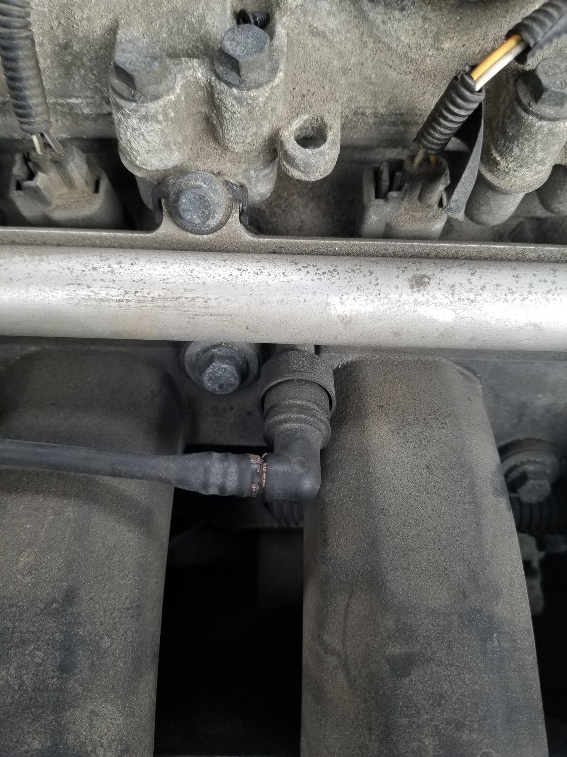

I had the same issue last year so replaced the expansion tank and the sign went away and last Month coolant was getting low again and I found out it was the engine coolant Reservoir hose which I replaced and no more coolant leak
