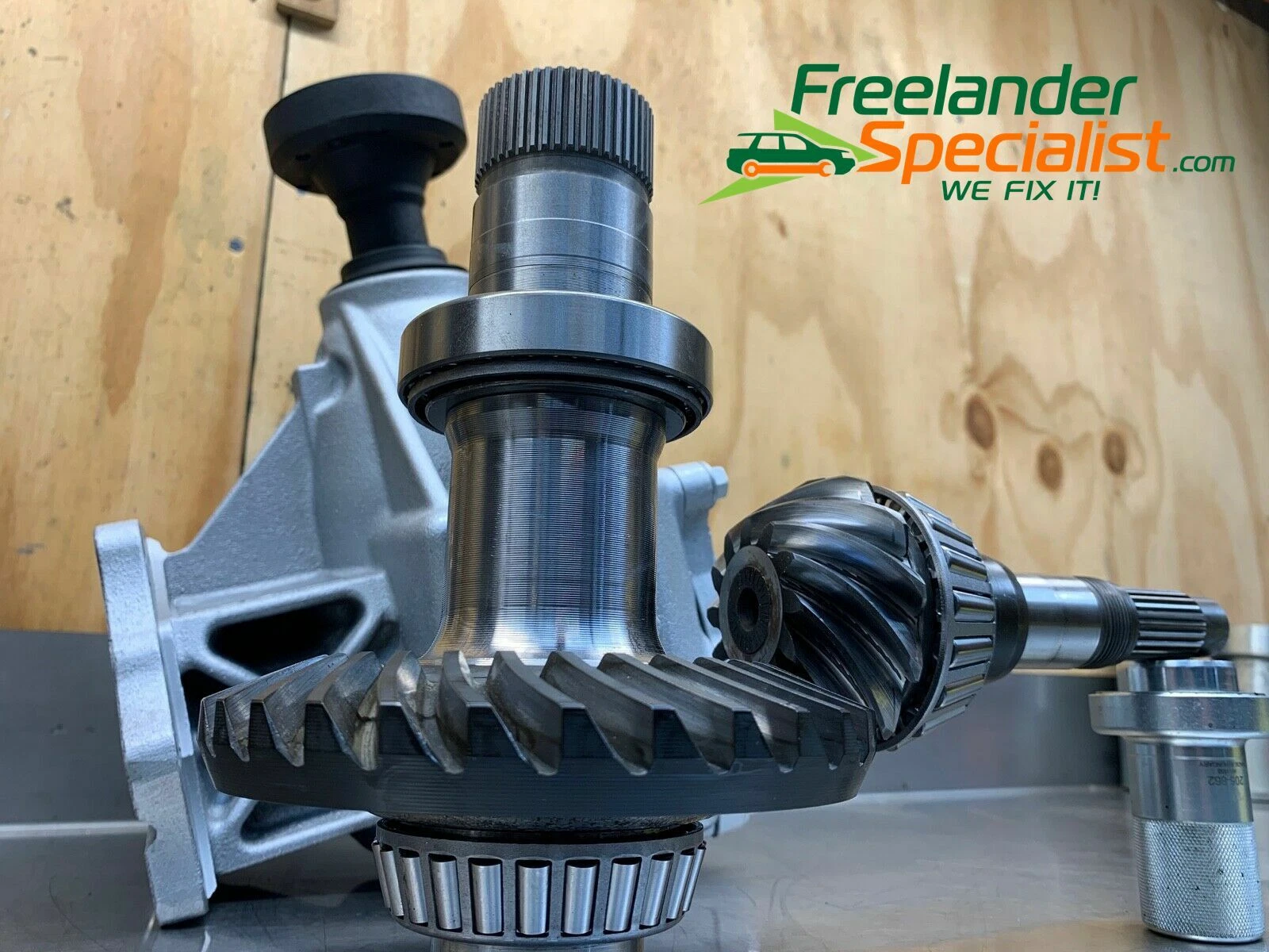

So, I was just reading up on the PTU. Apparently, the splines are not lubricated at the factory (!!) when the unit is installed, so they are prone to rusting and corrosion, and the symptom is what you described, noise and rumble from the front. Maybe a clue for Sherlock?
An Aussie shop, Triumph Rover Spares, has them reman but they want AU$2750 for one of them. Woof.
The rebuild kits do not include anything to replace the parts with the splines.
AliExpress has them for $300-$500 depending on what link you click on. I'm not sure I would buy that.
This one is probably the best deal at a little under $1400 at the current exchange rate. A reconditioned and upgraded PTU/transfer box/front differential from the UK. You have to ship yours first and then they send you theirs, and you have to discuss international shipping charges. Since it's a repair it should not have to pay any tariffs if documented and declared correctly.
