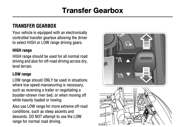

Because in low the clutches are actually engaged in the transfer case when in low. And it is not a good idea to drive at a higher speed in low, so it is just not practical. I think the owner manual even says that low range should be used in a limited manner.

Found it.

This still does not answer the question what really defines an OFF RoAD conditions. In my mind ,driving in 4Lo should not be limited to steep ascents and descents according to LR explanation. I have used it in many other situations and terrains, in fact, I have had 4L engaged for entire White Rim Trail in Moab Canyonlands which is over a 100 miles long with no overheating or other problems. Obviously my speed was significantly reduced during the trip, but still a long drive nonetheless to drive in low range.

Its not, even though the manual exert that DT posted it only says " not to use for normal road driving " probably because numpties who don't understand might try and drive flat out in low and destroy the TC or gearbox.
Like you said if you are using it at low reasonable speeds there is no problem if you use common sense.
