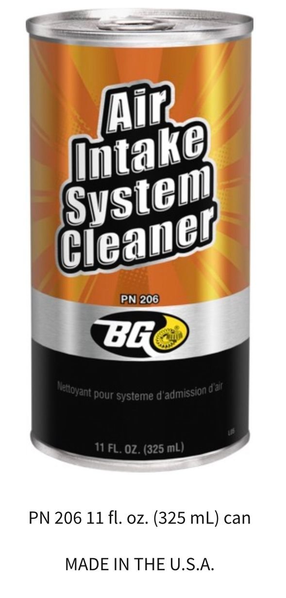

I usually do a three part cleaning and then a software update.
fuel rail cleaner posted above, air intake cleaner that is administered with the same tool at 80 lbs with an atomizer tip just before the throttle body, and a can of 44k in the tank.
when doing the intake cleaner you need to rev the engine every 40 seconds or so to keep pushing the chemical through.
